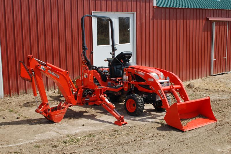

You need one of these, it makes digging a hole bunch easier. Not to mention a hole lot more fun! (Sorry for the bad pun)
