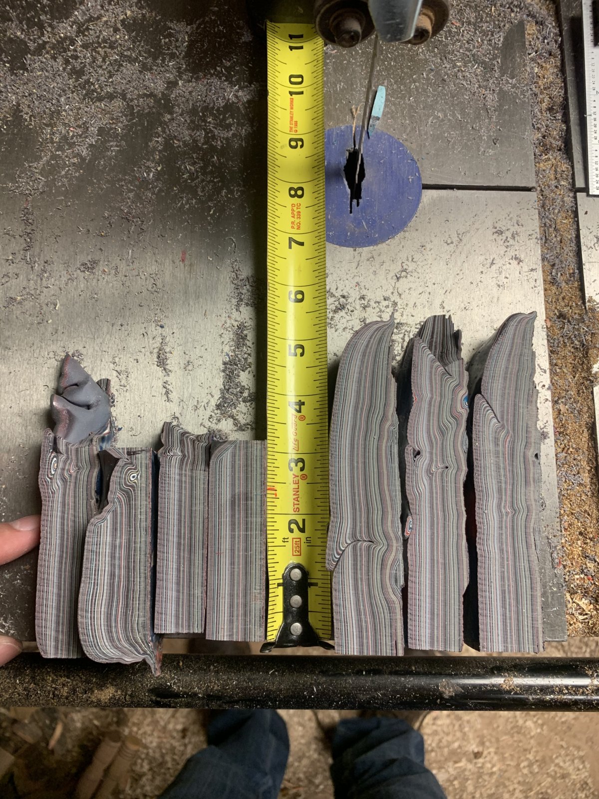

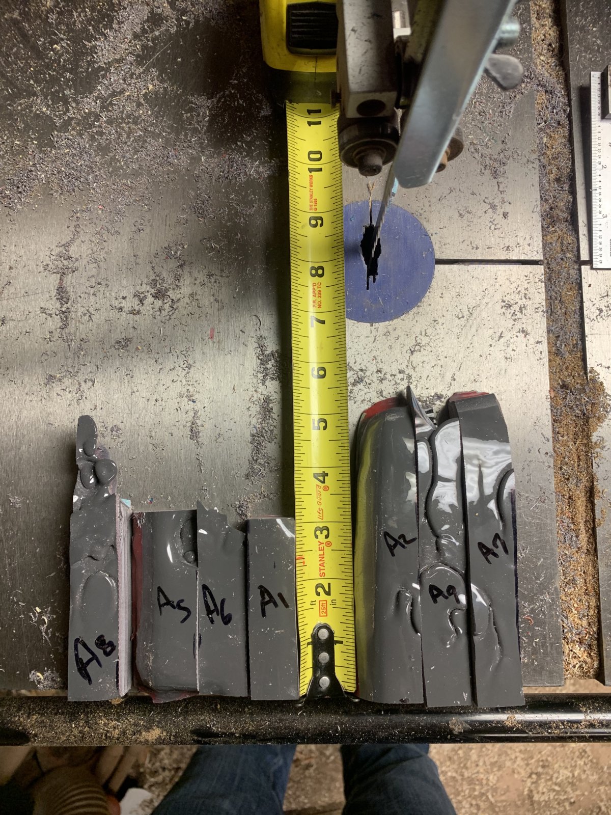

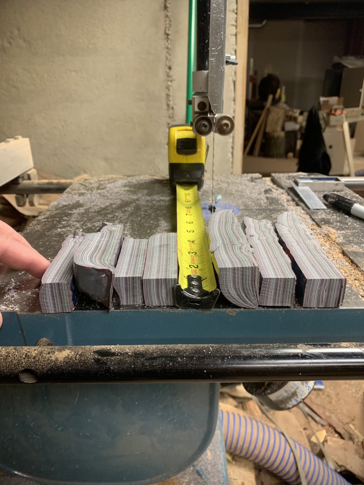

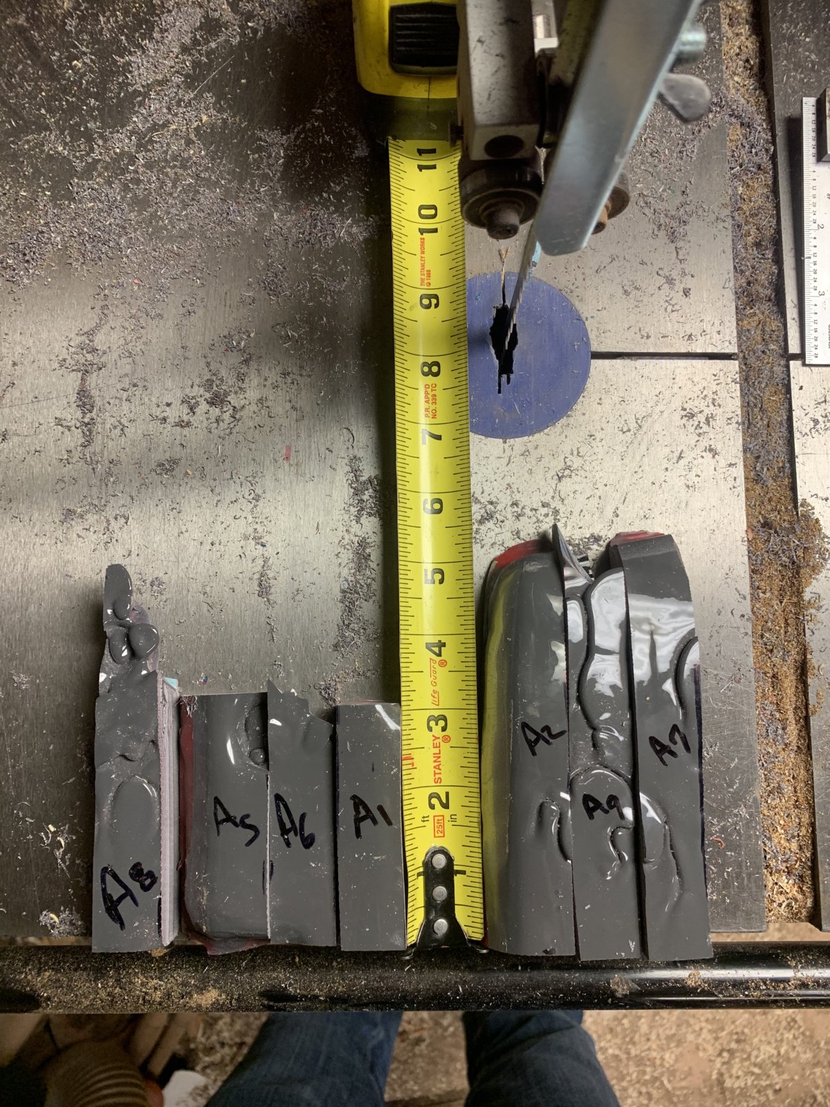

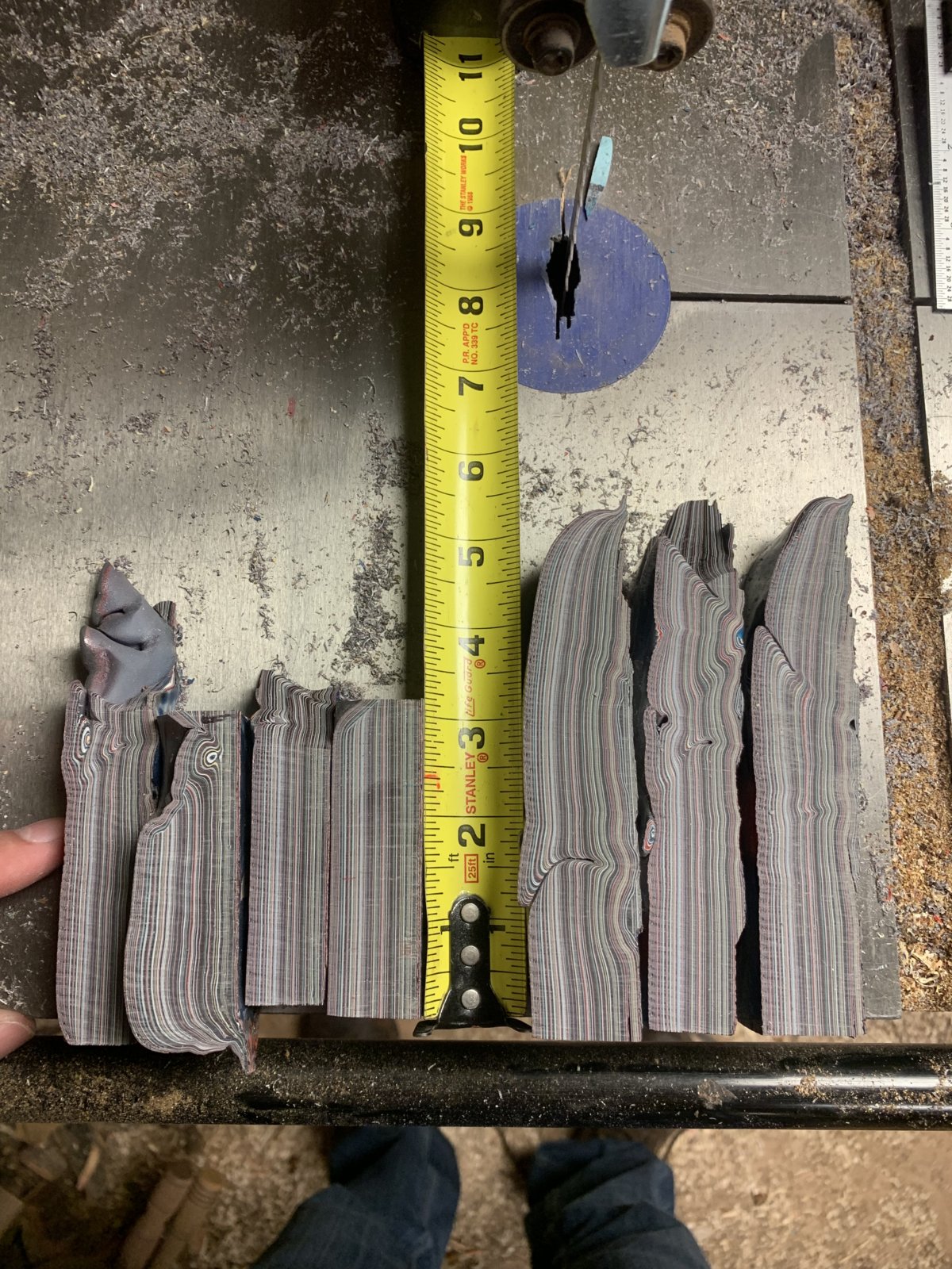

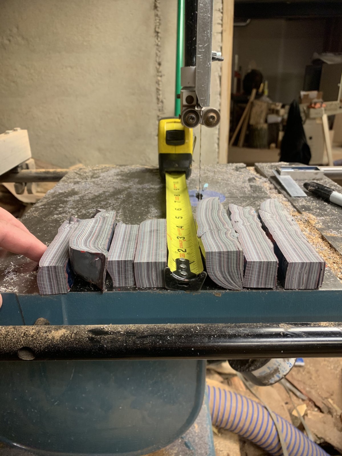

Here are some pieces of Fordite that I cut off a slab of Fordite that I picked up. Makes for super unique pens
Pieces on the left are at least 3" long and at least 3/4" square. $30 each
Pieces on the right are at least 5" long and at least 3/4" square. $60 each.
Plus shipping.
This is tricky material, so turn at your own risk. Cross posted, so shotgun your pieces now!

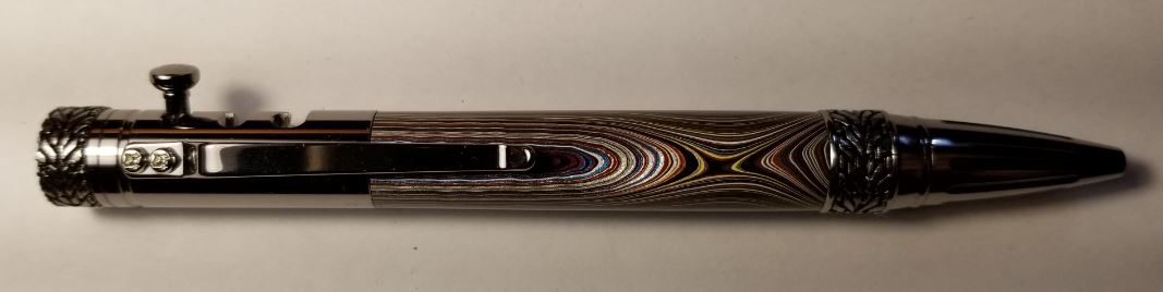

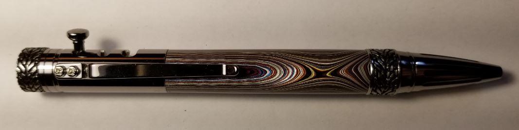

I have made a number of pens from Fordite and Len is correct, it tends to want to delaminate when turned on a lathe with cutting tools. I have had much better success, sanding the corners off of the blanks before turning them, then using 180 grit Abranet to get it very near to the shape and size before changing to finer grits, finishing with 12,000 micromesh. I always where a respirator when working with this stuff and wet sand to keep the dust to a minimum. They do make beautiful pens though.
