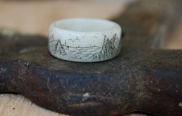

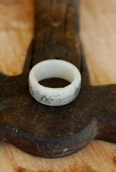

I made this from a lamb shoulder bone. I drilled a couple pieces of scrap wood and a piece of oak with 7mm added a brass tube to each...turned the the oak to the ID of the bone (not perfectly round) add a piece of double stick tape to hold the bone, then jammed it with the 2 other pieces on both sides and just turned the bone round on a pen mandrel and polished it. then did the scrimming. every step was all off the top of my head. many needed improvements and fun to do. now I need more bones

That is great looking! What is the overall size?
-Barry
I had the same question. I can't decide if it's a pendant, finger ring or perhaps small enough for a centre band.:confused:
Either way Laurie, it looks as good as all of your scrimming:biggrin:

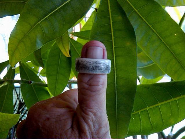

here is another picture if it will help you become un-confused.....it fits my (wedding) ring finger. this shot is my thumb on my left hand. now, mind you, I don't have very big hands. :O))

Wow Laurie!!! :eek: You must have very good eyes to get such fine detail in something so small. And a steady hand!!!
Thanks for the clarification. VERY impressive:biggrin:
