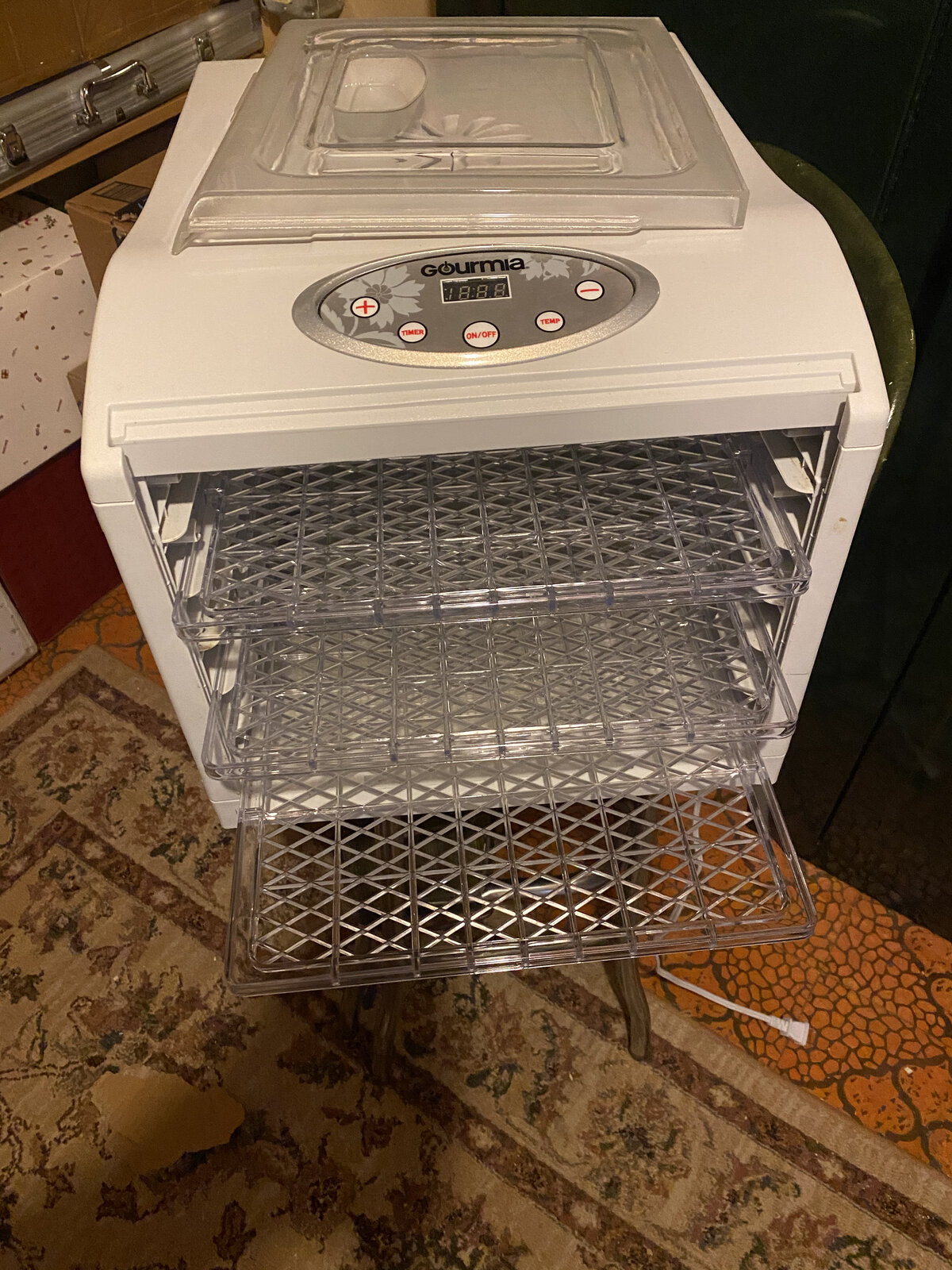

I use one and it works great. Just keep track of the weight of your items. When the weight does not lower any more it's dry enough to turn!!! It does take some time - depending on where you start on moisture content - i.e. 24-36 hours has been typical.

I got one a few years ago for drying filament for my 3D printer. Was thinking, why not for wood.
