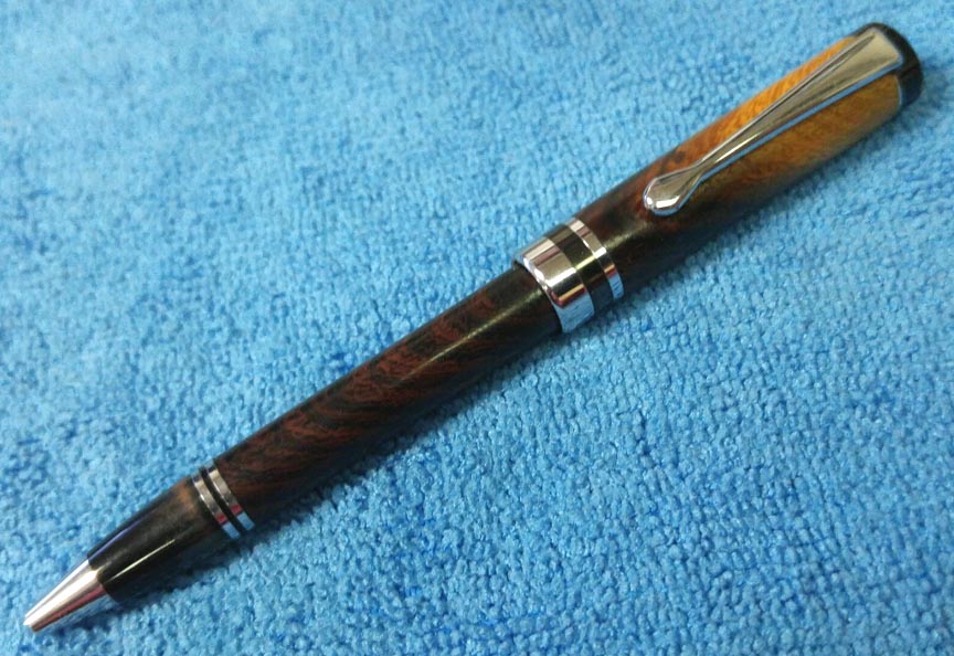

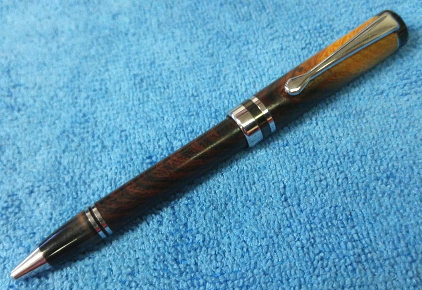

I turned many of them over the years. There have been several different kits, and there are differences. One of the biggest is that some kits require a tenon turned to a specific diameter. Others have the tenon turned to the brass tube. The width of the tenon can be different as well. Referring to the kit instructions is a must. I was fond of the kit style and still am. I think it makes a classy looking pen with simple, pleasing lines. It's a classic in my book.

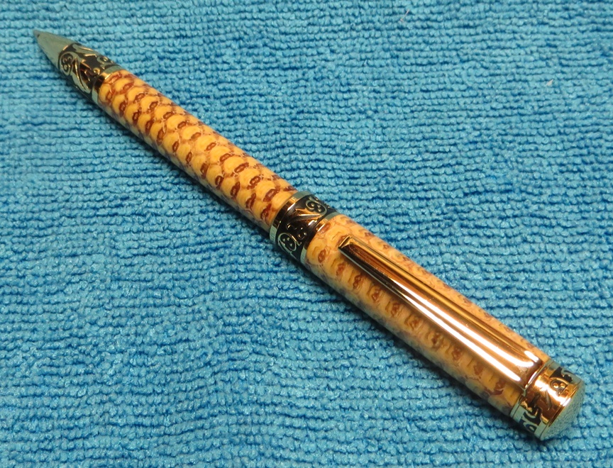

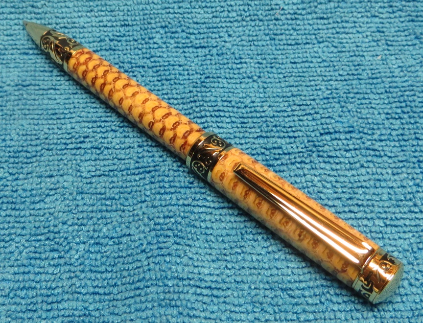

Jim, are your pens shown here the PSI Classic and Sculpted? They look very nice.
qquake
Feb 8, 2004
5,015
Northern California
I believe the first one was from Woodcraft. It's actually what they called a "push" pen. It's a click, not a twist. You push the upper body down to click it. I don't think they make them anymore. The second one is indeed a Sculpted from PSI. One of the classier flat top kits, in my opinion. Good eye!
