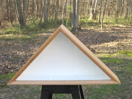

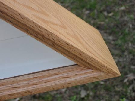

Here`s one that I have built for a family member. No real plan just my way.
