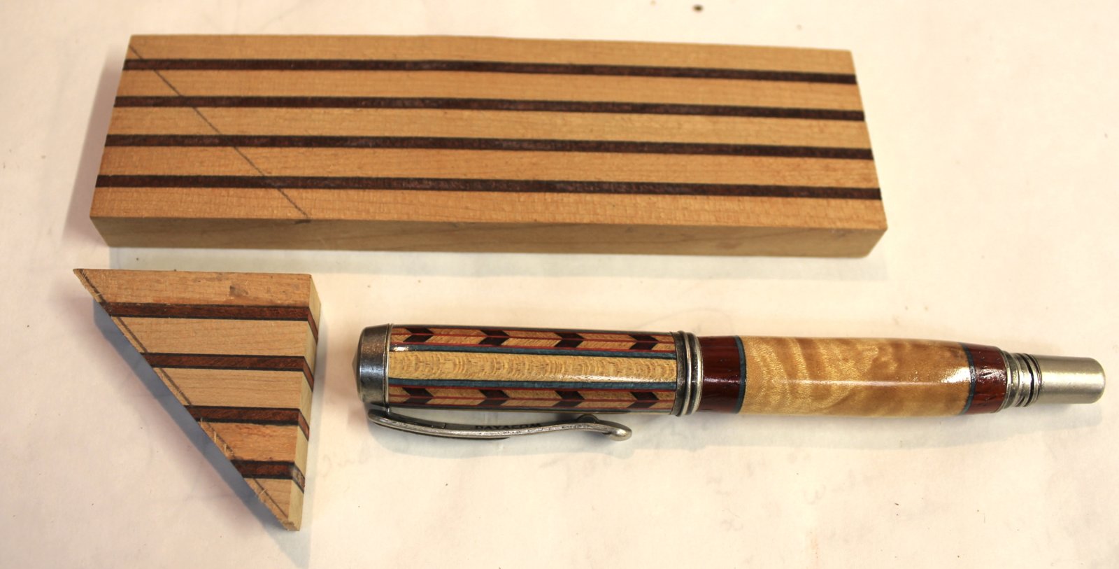

Sierra super button click. Woods are maple, bloodwood, osage orange, santos rosewood and olive green vaneer. Chevrons have been a little elusive to me, finally came up with a method that works for me.

My method is just cutting infill, instead of gluing a lot of little strips together. I tried it before by gluing thin strips together and then cutting them again into strips at an angle. I was wasting a lot of material. I realized, while typing this, if I glued those thin strips offset a little every time, I would have very little waste.

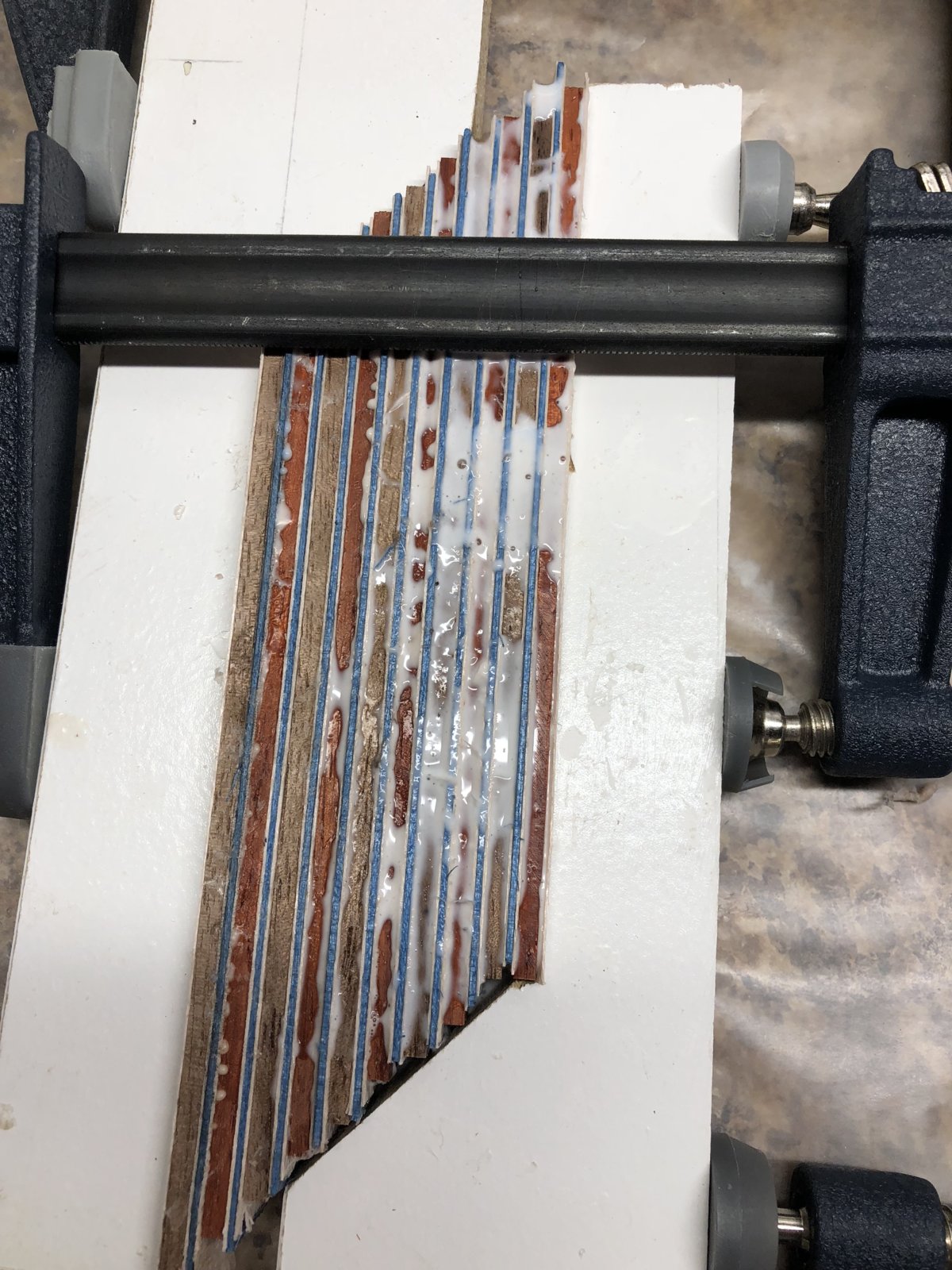

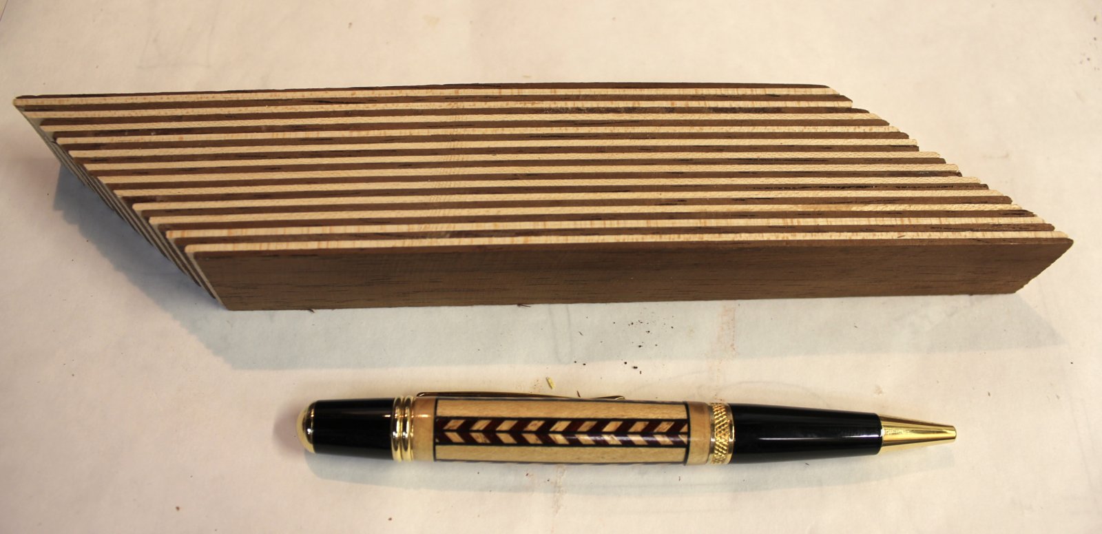

YES! SteveJ visited me a few years ago and gave me that suggestion. If I make a 1" (H) x 2" (W) x 6" (L) on the angle, I get 2-3 more pen materials (4 sided). It was a great suggestion (thanks, Steve).
Not to hijack your thread, but I'll attach pictures for those that are unsure of what we are chatting about.
(Gluing up the rectangular blocks leave the corner as waste (Pic 1 & 3). Gluing up blocks on an angle greatly reduces the waste... 2-3 more pens for each block).

Yes that's exactly what I was thinking. Now my method only uses one pen blank and whatever I'm using as infill. Your method allows for more elaborate chevrons. Looks to me like there is a place for both methods.

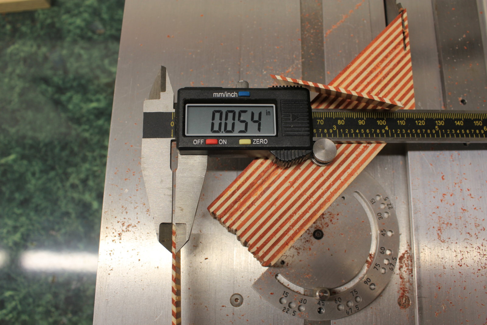

Ken, It may be obvious to chevron makers but since I haven't started yet, . . . do you size your strips with a thickness planer? I can't see how it can be done without a thickness planer. Just curious.
KenB259
Dec 24, 2017
3,572
Michigan
I just use my thin rip jig. Once I get it dialed in, usually only takes 2 or 3 adjustments, I'm good to go. On the pen I showed here, the maple was one pen blank, the blood wood was put in as infill, exactly as you would with a Celtic not. The blood wood is exactly, or actually slightly under my blade kerf, which is .102, the infill is .100 thick. Adding a bearing to my thin rip jig, suggested by John, increased the accuracy to a degree I wouldn't have believed possible.
