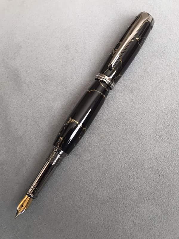

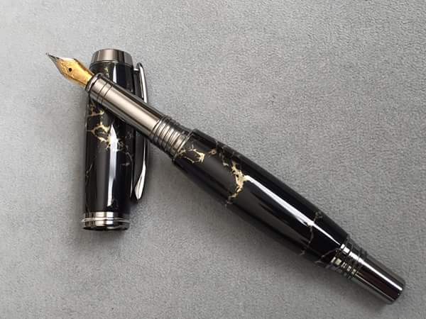

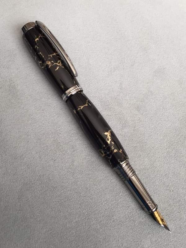

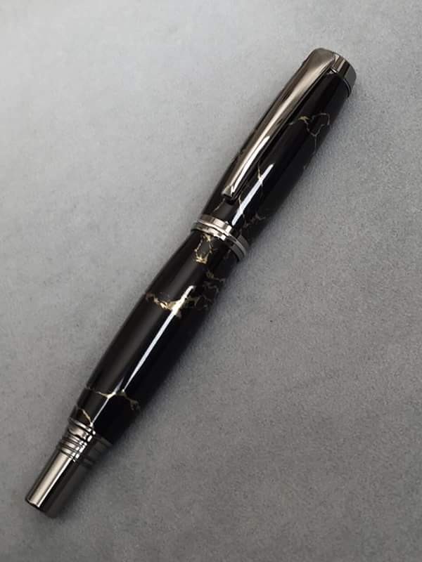

Fresh out of the shop. The fountain pen' body was TruStone Balck with Gold veining. The pen is a Black Ti Jr. Gent II FP. Both a first for me. The nib is 22k gold plated, a nice tie into the gold laced throughout the stone body.
This is my first pen using stone which requires more time turning and finishing. I turned the blank round between centers and then drilled on the lathe. I sharpened the bits prior to starting and took my time. It drilled about like acrylic. I turned with my carbide tool with light cuts. No real problems there either. I sanded 240, 320, 500 then MM wet through 12000 and pink rouge on my buffer.
It does take a beautiful polish and the feel and weight is something special. This will be the first of many stone bodied pens to come. Hope you like it.
Danny
