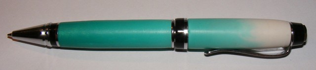

First up is a pearl green/white blend that I threw on a cheap chrome cigar that I know will never go anywhere.

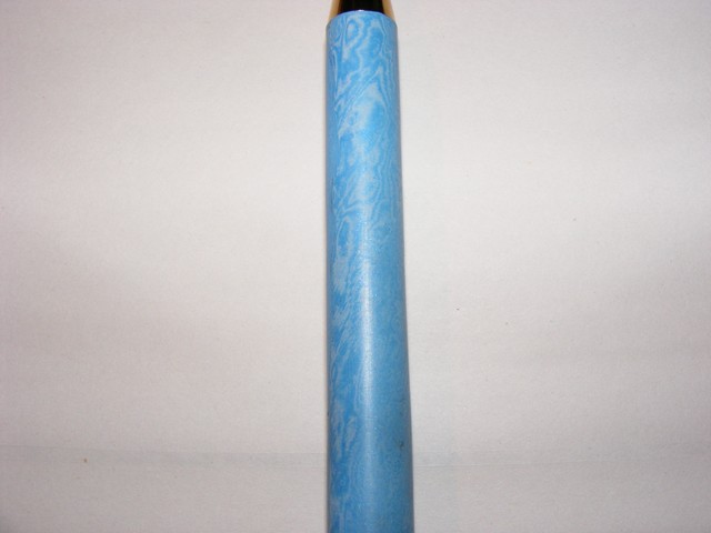

Second is my first attempts at a Faux Mokume Gane in Blue pearl and white. The pattern is very subtle (and slightly out of focus in the first pic) but it definitely opens up possibilities.

For shaping, I used the pasta roller to get the sheets to an even thickness, then wrapped around the tube and pressed the seam together (the seam on the green pen is invisible for nearly the entire length, but the blue pen is more obvious since the pattern is disrupted. After baking I through it on the lathe and used my skew to bring it close to final shape and then used 400 grit to finalize it, then a quick polish with EEE to get what you see above.
I would say the final product has about the same hardness as Ebonite with this clay (some are supposed to be harder, or softer) but without the smell.:biggrin:

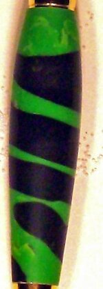

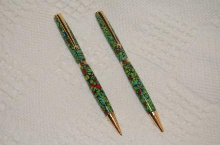

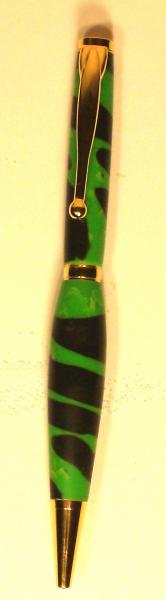

I have done a lot with polymer clay over the years. I agree with the 15 minutes baking comment entirely. In general if you start to smell the clay, you better get it out of the oven. It can be a bit touchy to turn, but with a light touch and patience you can get good results. Some of my polymer efforts are attached.
Ink and Gold. What are you using to get that shine?
PaulD
Jun 8, 2007
76
Stevens Point, WI, USA.
I am using a CA finish on my polymer pens. I also use MM on the polymer just the same as on a wood pen. I get the same CA shine with polymer that I get with my wood pens.
