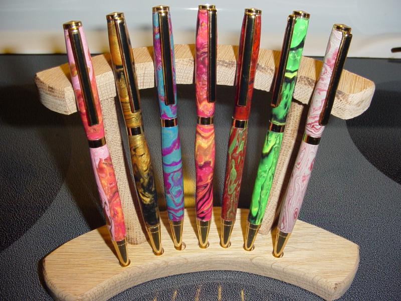

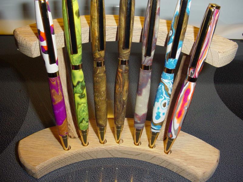

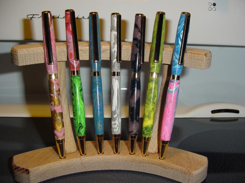

This Weeks pens from poly
I have been hard at it again.....I have some off cut oak so i decided to take a try building some pen stands...they seem to work but i am still in the proto type stage.....cant have them too fancy ...It wood take from the pens...found my camera finaly after the move it takes a little better picture...well heres this weeks pens.....:beauty:

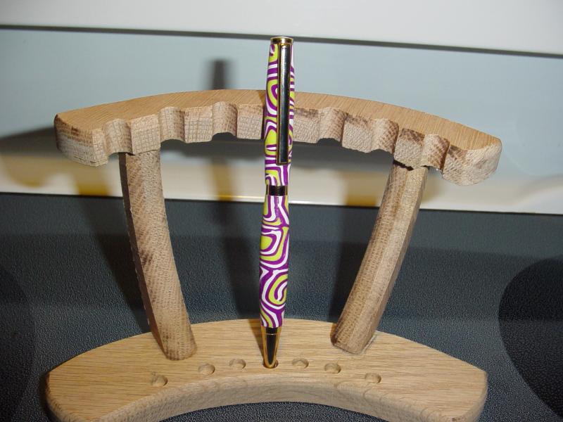

A polymer machine has been unleashed!
Austin Powers
Just turned this one out.....:biggrin: My wife calls it the Austin Powers..LOL..Thank you for all your kind comments

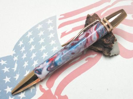

This pen was made doing exactly what Keith said.
