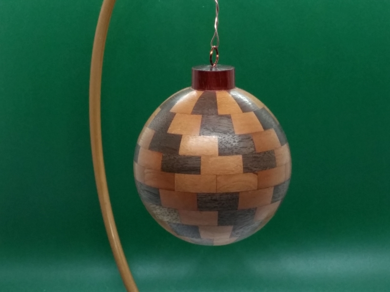

First successful segmented item
See more from chartle
chartle
Mar 13, 2015
1,287
Pgh, PA
It's a little out of round but I think it good for a first try.
Also first use of my new photo cube thing.

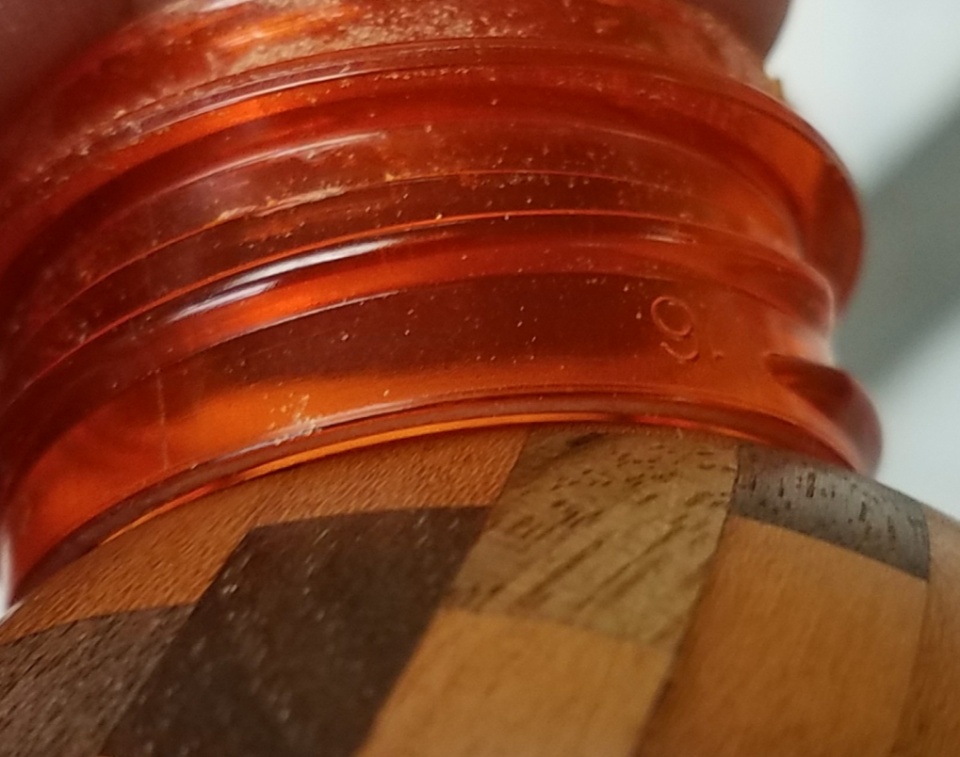

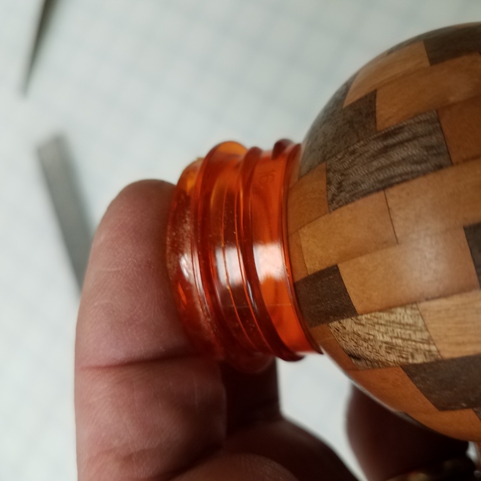

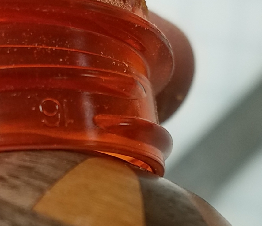

I now remember how to check for roundness of a sphere. You use something like a cup or tube and if it hits flat all the way around its circular. For these I used the top cut off the top of a medicine bottle.
I'm too shallow near the top and in the middle and bottom I'm good until I hit the too flat bottom.

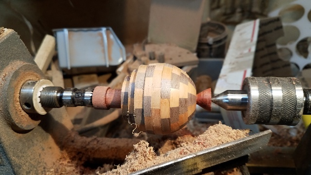

Are you doing by eye or are you using a jig to turn?? I have been wanting to make a jig for spheres. It is on my to do list.

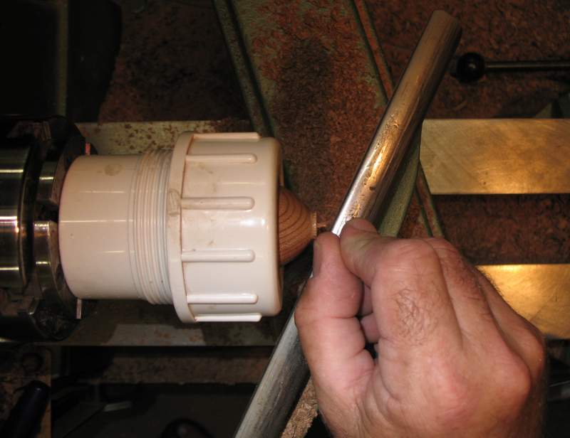

I took each ring down to approx size and then connected the segments. My issue on the top was I had a small catch I had to sand out and the flat bottom was due to me not having my lathe set up right. I used a PVC sort of donut chuck that didn't have enough of the end sticking out. I'll post pics when I do the next one. The chuck looks like this.

I can't do it that way, rotating it between centers, because of how I did the top.

I get the idea of how you are turning. Thanks for the photo.
I pretty much make rings and then knock off the "corners"
But I now realize that I think I'm going to make a dedicated shorter real donut chuck
