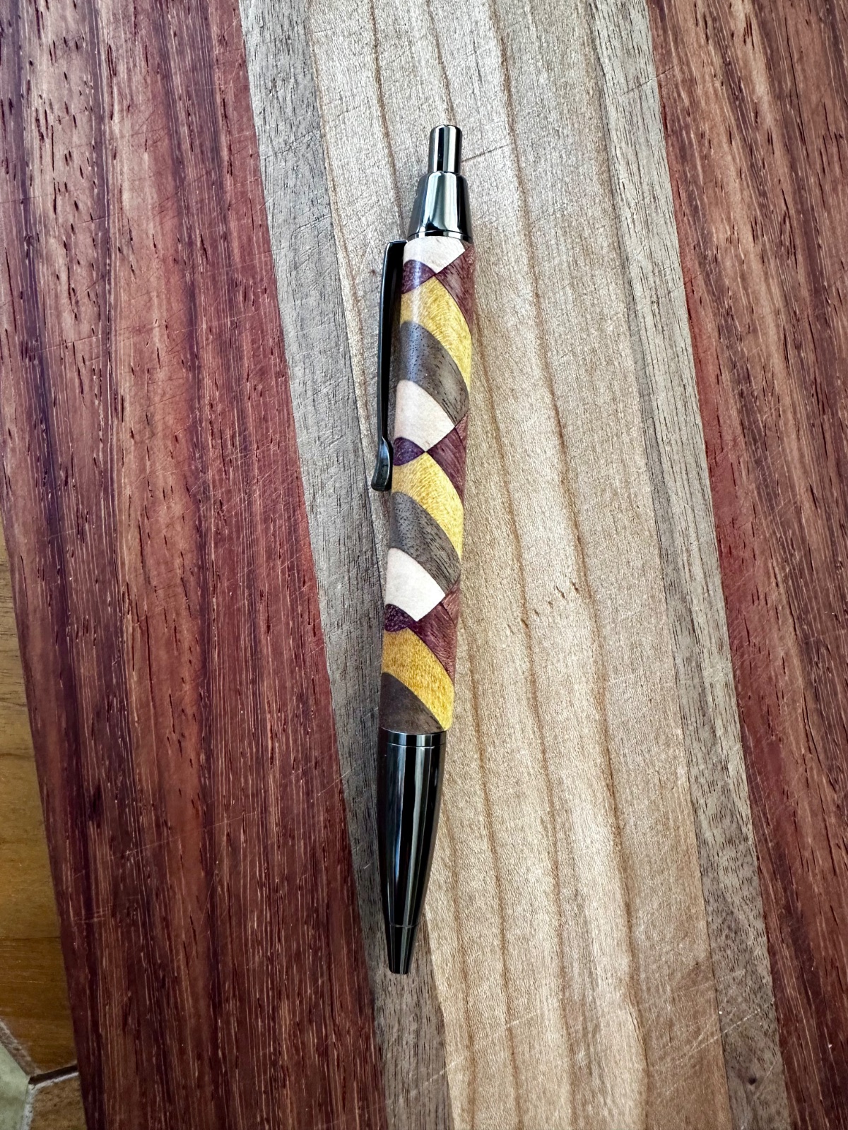

First segmented pen from my own blank
lvturner
Jun 22, 2025
59
Las Vegas
It's not fancy like you other guys, kind of did this "freehand" from some scraps I had laying around. Wanted to see what the glue up would turn like. Pretty happy with it! Did tune up my bandsaw after cutting this blank as it was veering lol.

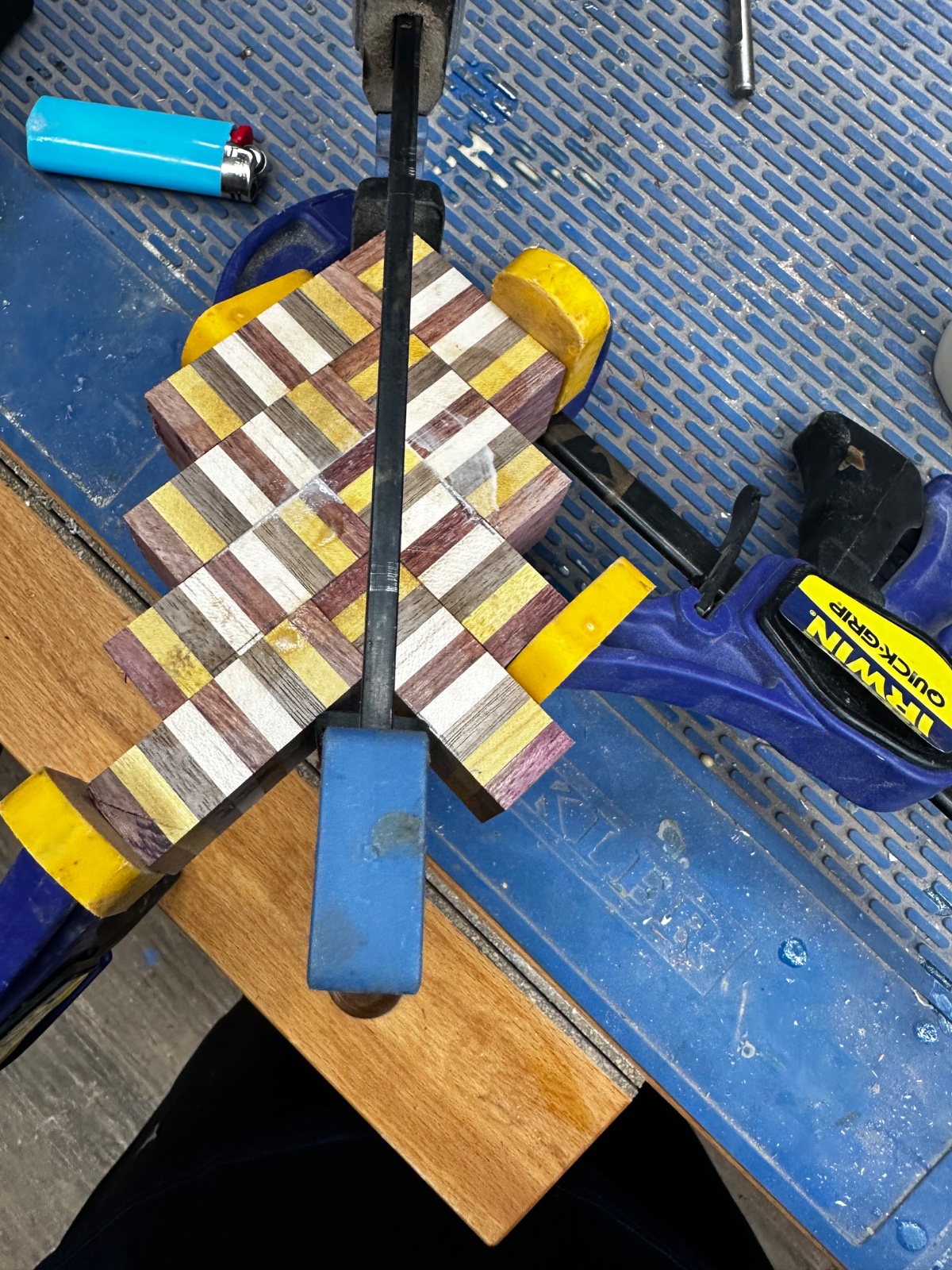

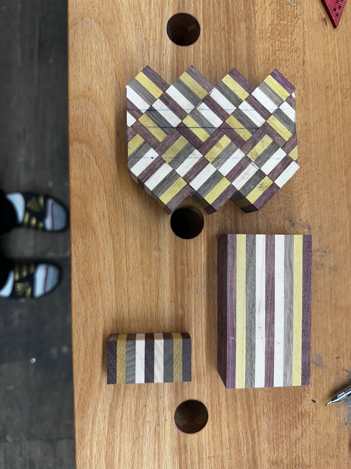

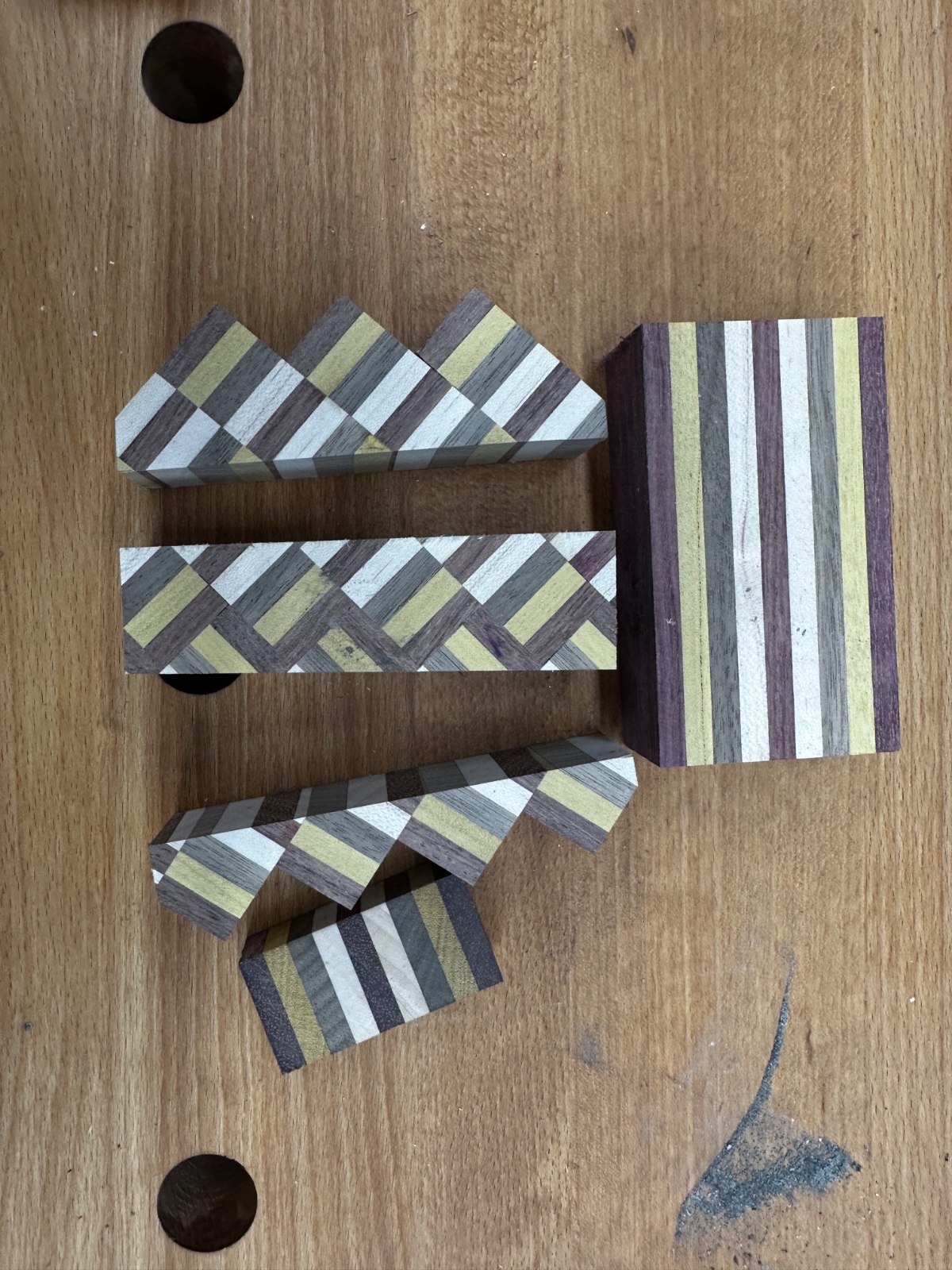

Actually didn't use any jigs. I made a long block, which is the piece on top. I then cut that block into squares, glued the square as L's, then glued the Ls together. Do the pictures below help? I honestly didn't document this one very well.
