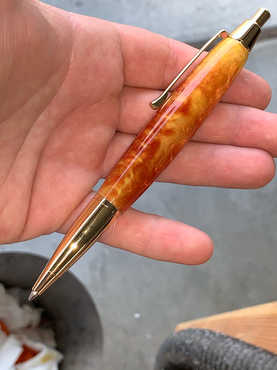

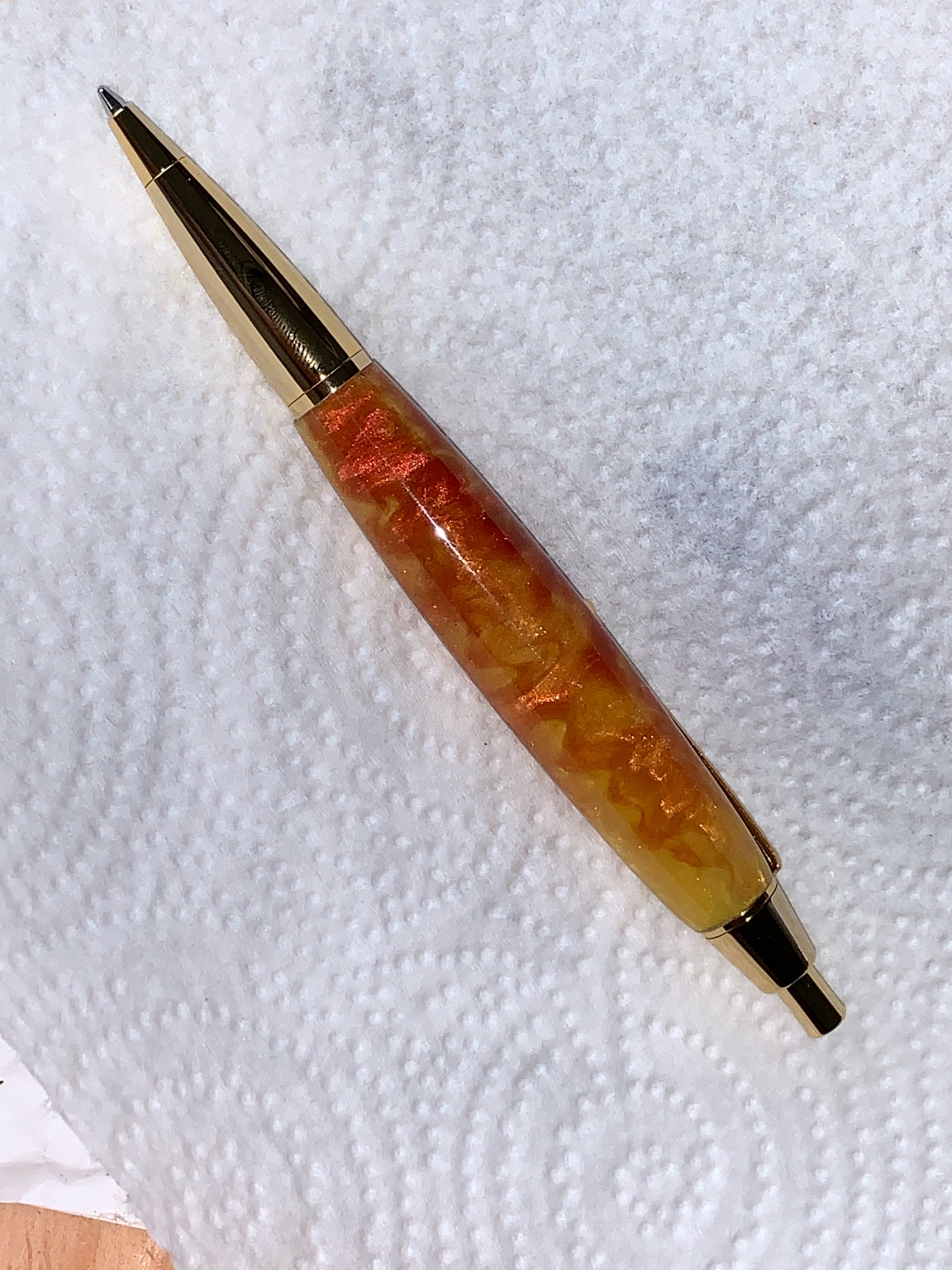

It's been about two weeks since a made something since I caught the Covid-19. I was fooling around with resin, making my own pen blanks. Turned this today. I'm still learning to make a blank centered. This one I should've taken more time with that.

Hybrid blanks will be my next step. I don't plan on going to deep into resin casts till the future. Do you use a pressure pot? I'm curious if I really need one.
Nice blank! You did good! If your going to make hybrids I would suggest using alumilite resin, since it adheres well to wood and doesn't shrink and pull away from objects like PR resin. Alumilite resin works best with a pressure tank. Without it you will have a blank full of cured bubbles.

These blanks were Alumilite. No pressure pot used. I used pink silicone to make copies of some other blanks I had. I lucked out with no bubbles in my blanks. I find that mixing and pouring carefully helps with this. I suppose I will get a pressure pot in the future because I do know that alumilite and moisture do not get along.

Which Alumilite resin did you use - Clear, Clear Slow, Amazing Clear Cast? "Alumilite" is actually a brand name not the name of a specific resin.
