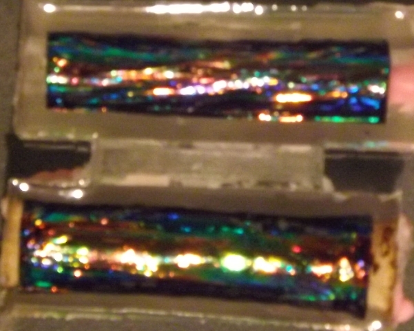

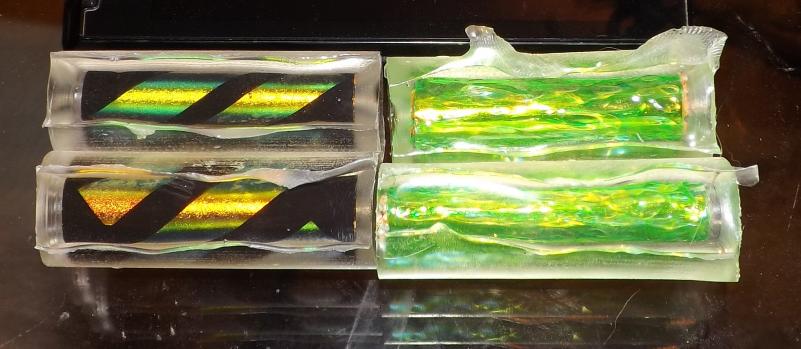

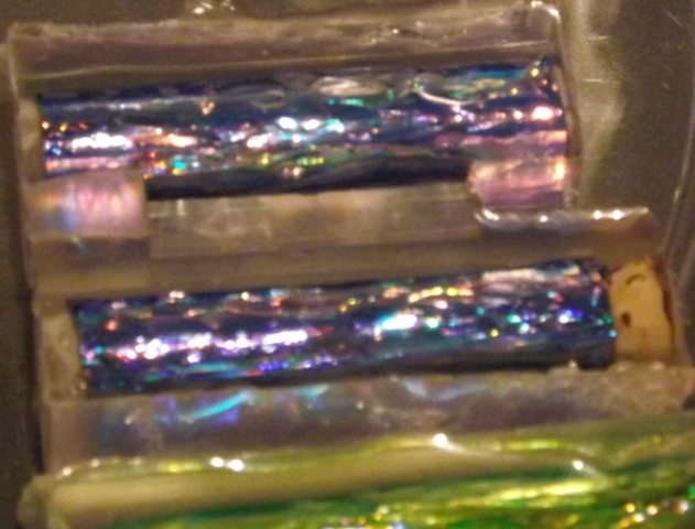

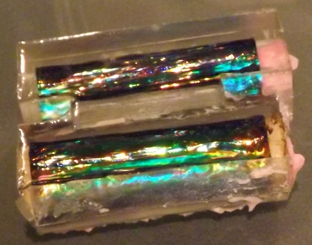

Both are picture shy.....
On the left, More Dichro. Rainbow on Triton Tubes
On the Right, "Green Opal". What doesn't show well here is the blues, golds, and even darker greens and some reds that show up in the light. I will have more colors of "Opal" coming.
Castings are coming out really well, No bubbles as far as I can see. I spun two round and polished, and nothin so from now own I'll be sending them on with just a visual inspection and my personal guarantee. less time = more blanks available.

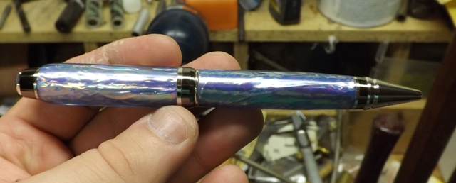

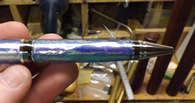

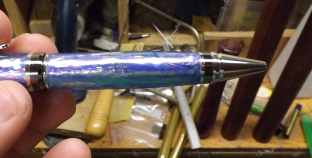

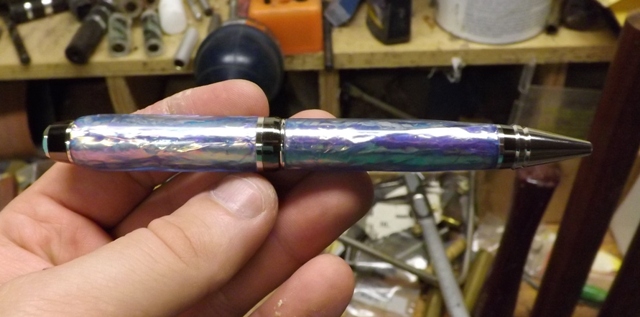

BUT, here is another color I did a couple weeks back that had a bubble or two, the impetus for getting the pot.
More of a Mother of Pearl look to this one.

The camera just doesn't want to focus on it very well, or catch the color flashes. In some ways its worse than the Dichro.

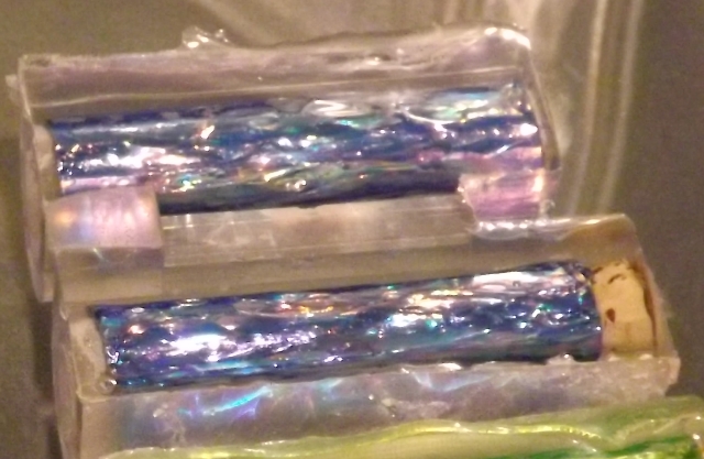

Couple of the other colors.
1 being the same as the pen above, kind of a mother of pearl, light blue opal.
The other I can only describe as Black Opal. Dark blues, greens and amber.
