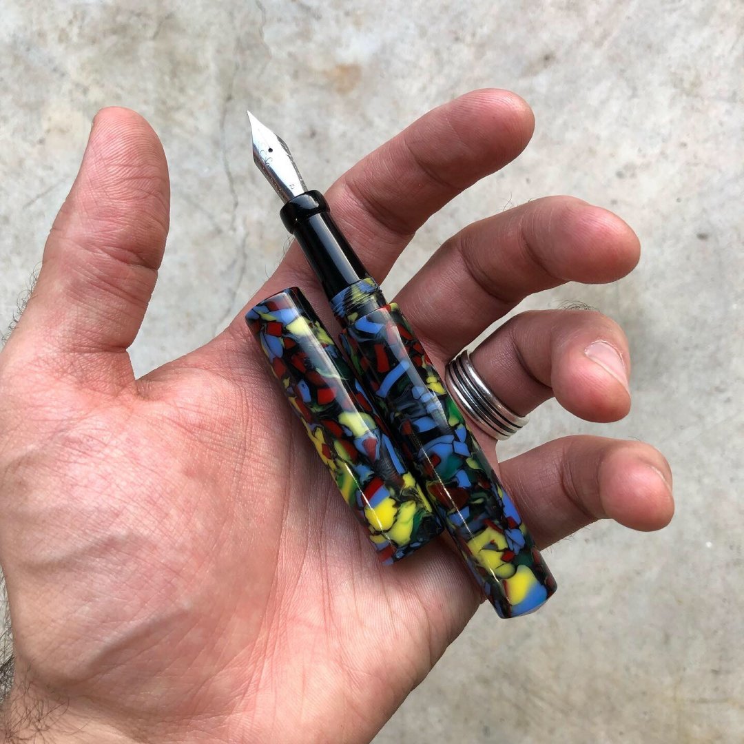

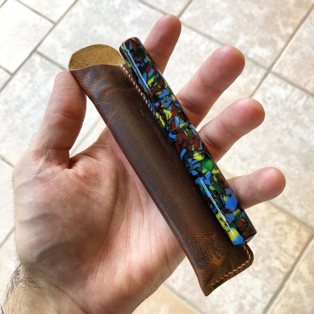

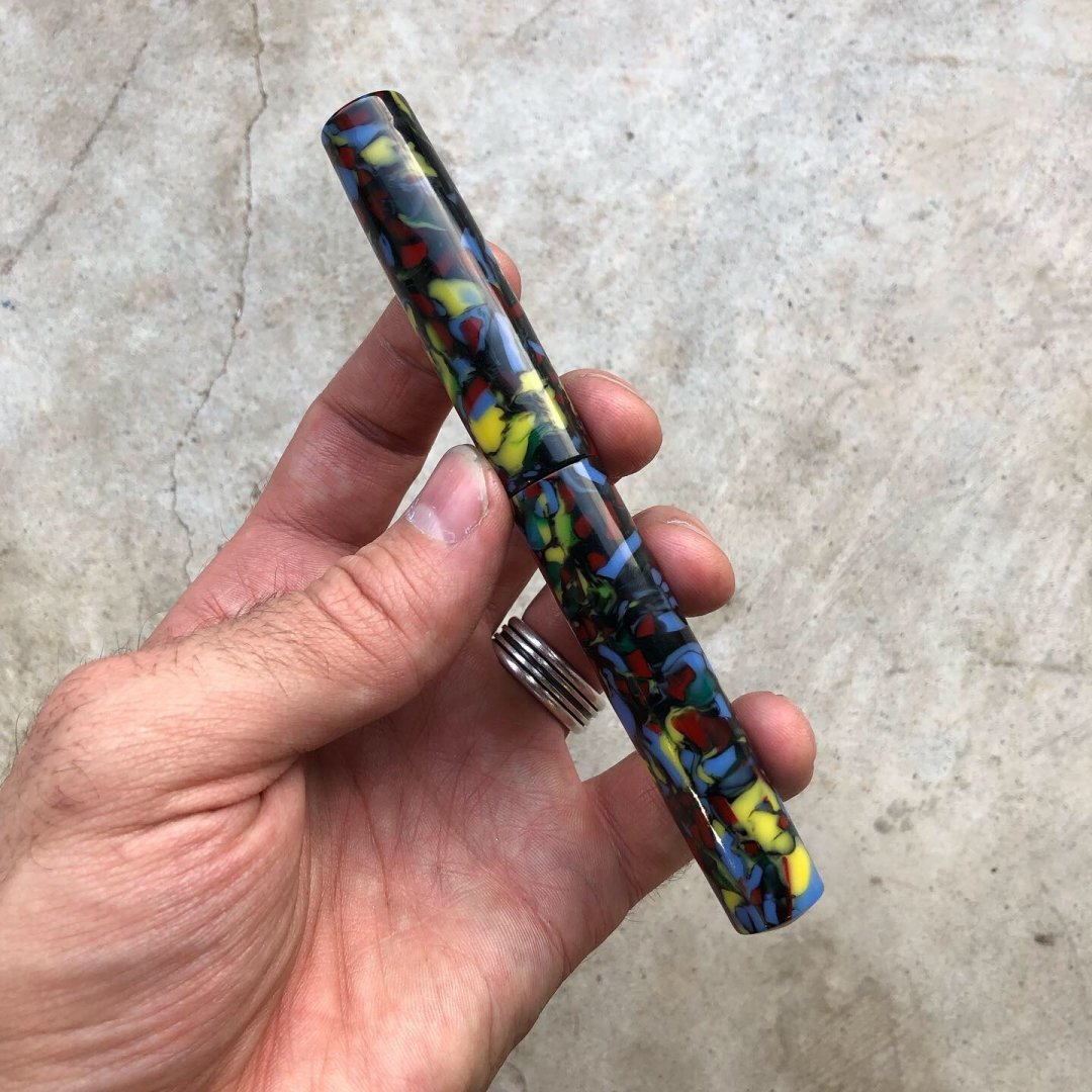

Good evening fellow pen makers!
This is my first post sharing one of my pens recently completed. I've been working on my process and technique for bespoke pens over the past several months, and finally finished up what is my first bespoke fountain pen. This is what I've called the Douglas, and it is done in Starry Night acrylic with black acrylic section. It uses a Schmidt converter and features a Jowo #6 steel nib.
Not shown in the photos are all the broken study pieces leading up to the successful pen! Thanks for looking and I appreciate any constructive comments!

Can you please tell us the length, diameter, and what threads you used. . Thanks.
Thank you! Of course! The largest diameter is about 16mm and tapers to 14-15mm (there's a range since I'm doing everything on a wood lathe by hand...doesn't always come out exact!).
Length I need to confirm. I want to say maybe 150mm total (5.9 in). Again it varies based on where I part it off. The section length is 30mm which I have found is really comfortable for my large hands. May have to do a smaller one for those that prefer it.
Cap threads are M13-1 single start which gives me a fair amount of play in pen size. Section threads are M10-1. Nib feed threads are M7.4-.5 for the Jowo #6 nib.

That's a great opening piece Jason. Now we have to get you working on clips:)
I use M10x.8 threads for my #6 sections. Since my through hole in the section is 7mm, this leaves me with a .7mm solid wall thickness as opposed to .5mm thickness if I used an M10x1. I find in Bespoke pens, every little bit helps.

Thank you! Yes I've been researching clips as my next venture. Not too thrilled with what is available ready made, but I've also never done any metal work before. So that step may have to come a little ways down the line!
Great tip on the section threads. I've had several blow out due to thin walls.

Spectacular Kitless Fountain Pen Jason,
Beautiful Blank, Profile and Proportions,
Excellent Section, Fits and Finishes.
Would suggest that a Photographs less your hands would Improve your Posting.
Resting the pen on something small, so that we can gauge the size of the Pen.
Congratulations, Great First Posting.
Brian.

Thanks Brian! I'll definitely work on some alternate photography setups. I appreciate the pointers!
