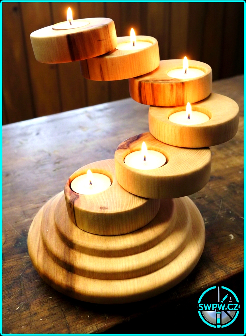

First attempt for multi tea candlestick
Kenobi
Jan 23, 2024
104
Czech Republic
Not bad,but definitely needs some improvement. Any suggestions welcomed:)
Pretty cool.
There's a bit of lean—or is it an illusion?
How are you holding the cookies to each other?
Indeed,there is. I have only used a beech pins in drilled holes,so with every joint a bit of lean,and it sums up of course...also,te weight of remaining parts acts on the joints as they are eccentric...thats definitely something I must improve...
What if you glued each cookie to its partner one at a time starting with the top one and working down.
I would use Titebond and glue the cookie as well as the beech pin unless each cookie rotates. If that's the case, it's a whole different beast.
Yes,of course they rotates. What you see on the photo is "open" state, in "closed state,all "cookies" forms a single cilinder centered with the base, hiding all the candles exept the top one.
Alright then. 🤣
So, it seems you have to create space in the base of each cookie and add a bit of counterweight to balance them.
Maybe small lead shot?
And, unless someone who is really good at math and engineering helps, it's probably gonna be trial and error.
Alright then. 🤣
I have already obtained a set of steel pins + tight sleeves, so next time Ima use them, probably fixed with some epoxy
