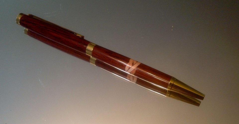

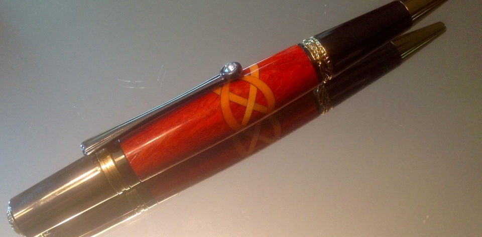

First an admission of my lack of visualization skills. How in the heck did someone figure out if you put four pieces of wood into four slots cut at an angle into a pen blank that the result would be a Celtic Knot? I just cannot wrap my mind around that one.
Now the questions: When I did the larger knot, I glued the inserts in with a 5-minute epoxy. Much less messy and anxiety-laden than the smaller one done with medium CA glue. However, when I removed the drill bit after drilling the center hole, the knot broke apart at the joint. It was a very clever pointed break, so it was very easy to put back together with CA glue. Then, while turning, the little voice in my head said "turn off the dust collection" and for once I listened. "Ping" and off came a small piece, again popping off at a glue joint, so it was easy to put back on. (Thankfully, I had watched a video on the inlayed blanks, so I just treated it as an inlay.)
So: What do you use for gluing the inserts? I assume CA or 5 minute epoxy are the choices. Would putting a very thin layer of 5-minute epoxy on the inserts and allowing it to harden before putting more on and doing the final insertion be of any help? I know that people use that when they are gluing end grain on other wood projects.

I use 5-min epoxy. Sometimes they come apart.
However, I did learn to make sure all the surfaces are roughed up and dust free before gluing.
Give the glue plenty of time to cure.
And last but not least, when I switched to turning between centers I then was able to use a skew to turn down the blank. That solved much of the problems with tearing up the blanks and also the blank will stop when the skew catches.:smile:
For me, a skew catch when the stock is being driven with a chuck or spur center will just tear the stock apart, break the tool, hurt me or scare the crap out of me.....or all of the above!:eek:

I made a third, just like the larger of the two. It broke into about a jillion pieces, which I was able to find and put back in. Turned out just fine; except for my nerves trying to get all those pieces put back in.
I believe (as suggested) the problem is a starved glue joint. The glue going on the blank itself is essentially a butt-joint, and I know how that soaks up any glue.
Heat may certainly be the issue, at least during the drilling part. Afterwards, I put the blank in the fridge and then put the brass tube in. Then I waited until the next day to do the turning.
Both of the large knots were made with 5-minute epoxy. I think the next one will be with medium CA. I will consider being a bit more generous with the epoxy in the kerf. I didn't get any comments about putting a skim coat of CA on the inserts...any thoughts on that?

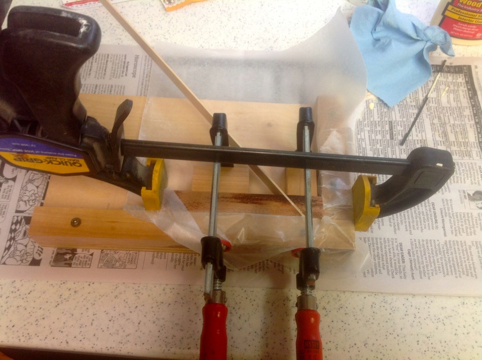

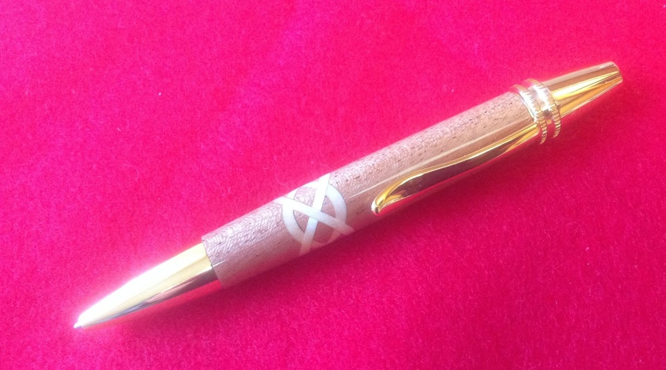

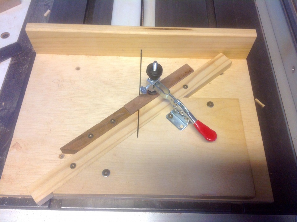

Thank you all for your suggestions. I made up 4 pen blanks with Maple inserts in Sapele. I used Titebond Original, and clamped each insert for 30 minutes and left them 24 hours before drilling and turning. I did the clamping in the house, where it was a bit warmer than my garage. I turned just one yesterday, but I expect all will turn out the same.
The turning went without incident. No parts flying around! The "sort of" in the title came when I put the pen together. It is a PSI Polaris Pen, and while the cartridge comes forward when I turn the cap, it doesn't retract when I turn it the other way. It seems like the spring is too weak. I called PSI, but their Technician is out sick. I left my name and phone number and I am sure he can offer a fix.
I have included a picture of the pen, the jig I put together to clamp the parts together, and the jig I use for cutting. You will see that they are nothing fancy; strictly utilitarian, but they work. I apologize for the quality of the photos, it is just me and my IPad.
