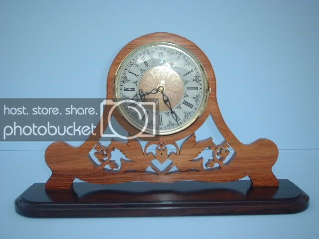

I also just like to use a Danish oil on it and then polish it to a nice soft sheen. I did that with the base on this clock. Another beautiful wood to work with. The clock is Canary wood by the way.
