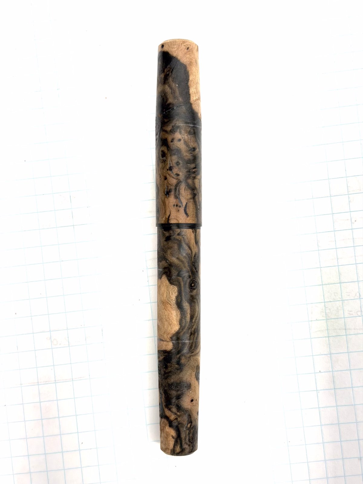

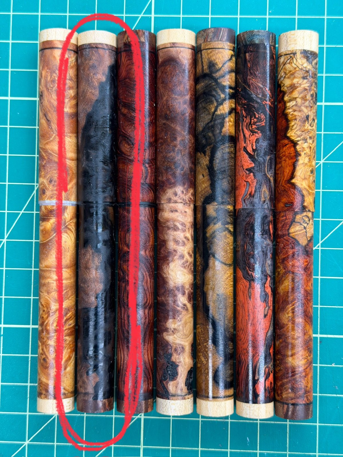

Hello Everyone,
I am making a sleeved (ebonite) kitless pen with a nicely figured piece of Mun Ebony Burl. I would really like to keep the contrast between the light and dark in the figure. I use CA for my finish on 98% of my pens and plan to do so on this one as well. The problem is that CA darkens the wood, which many times is fine, but in this case it has the effect of darkening everything and muting the contrast of the light and dark.
Here is a picture of the work in progress with no finish on it. You can clearly see the great light and dark differences in the figure.
Here is a photo of this same piece of wood, earlier in the process and before shaping. It has a single coat of ultra thin CA (GluBoost) to protect the wood. See how the CA darkened everything and kind of ruins all the great contrast in the figure?
So here is the ask... is there anything that I can use to seal the wood to preserve the great contrast of color in the figure that won't darken it and that I can still put a GluBoost CA finish on?

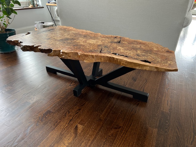

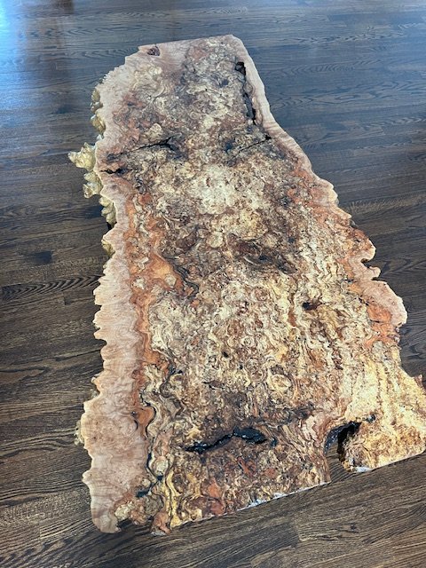

No, the project was a 3' x 5' table top - way too large for a CA coat. I was concerned about the Rubio Monocoat as it says it needs to soak into the wood, and with the Petrifier, that is just not really possible as it sets up like an epoxy finish, but I have to say the Rubio went on very nice and is holding up well. The finish is a semi-gloss, like a soft shine which was what I was shooting for. I'm totally out of Petrifier or I'd try it for you. Home Depot by us carries it, but as it's a local company, that may be why. May not be available in Utah......I'll ask the folks in my turning club if anyone has given it a shot.
Good luck!!

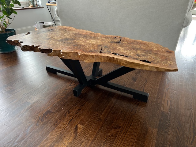

Pic of my table - before and after
Kevin
Kevin

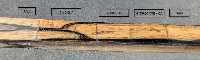

David - here's a short test stick I made. I prepared the surface using a cabinet scraper to get rid of any layers of dirt/oxidation, then marked off areas for the test.
I applied Hydrocote water based finish (I think it's lacquer) to 2 of the panels with a sponge brush and left it a couple of days to dry completely.
Then I applied a wipe of GluBoost thin CA so I had one raw, one CA, one Hydrocote, and one Hydrocote plus CA panels.
Attached photo shows result. To me it looks like the CA-on-wood causes more warming of the color than both the Hydrocote and the Hydrocote followed by CA.
What a great test of various applications.
Based on what you're seeing and the original post where you wanted to preserve original color and transitions what are you thinking? To my eye looking at the photo does the Hydrocote provide you with the look you want and then the CA will provide some durability over the top of it?
Of course this test says nothing about long-term durability, only that the CA appears to adhere to the Hydrocote base layer.
Very true, to me having the CA over the hydrocote will make a more durable surface but no idea on the long term viability
