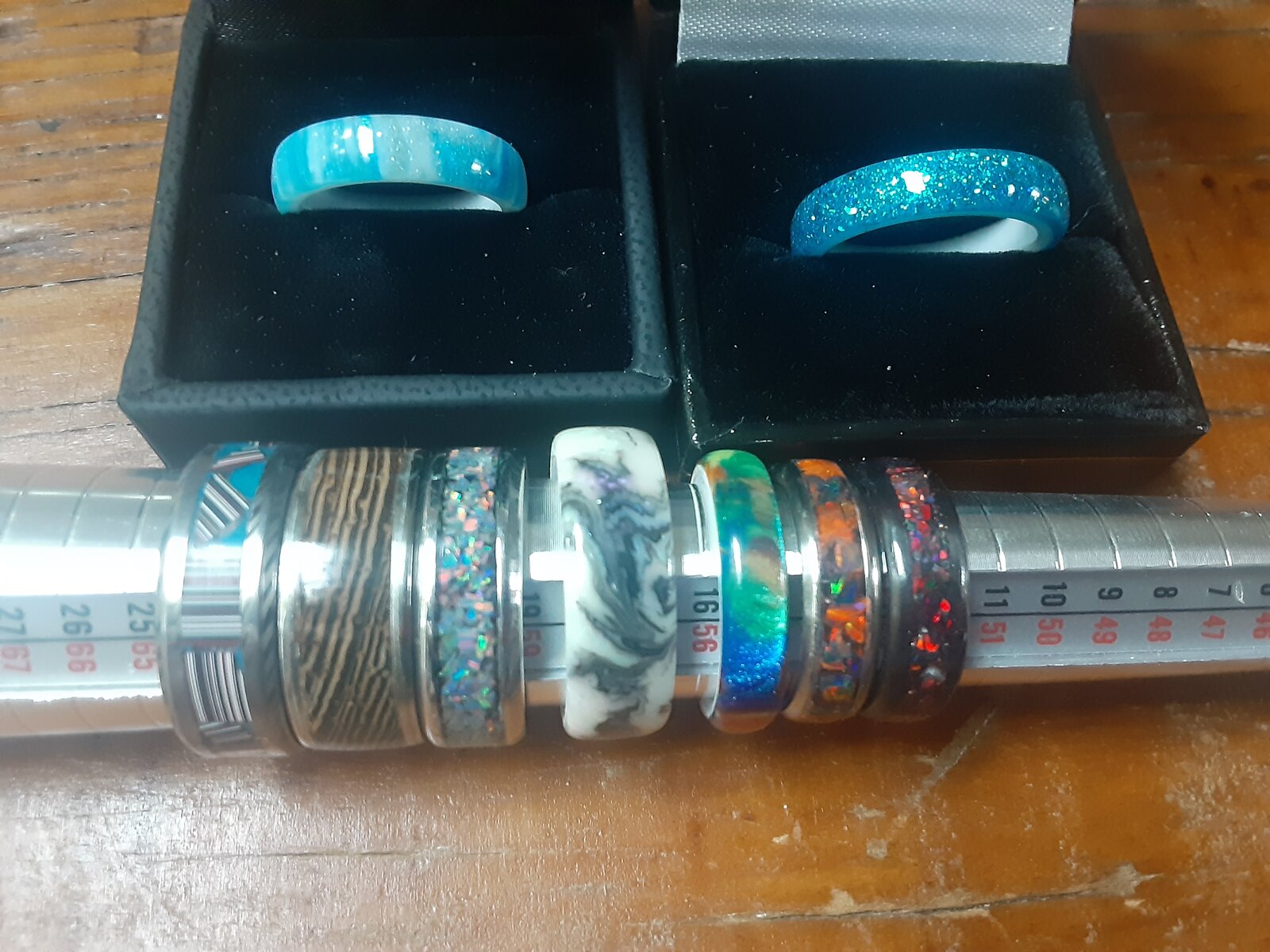

I started with the inlay rings. Sort of piddly, but I enjoy the crushed opals. Then I converted my wood lathe to a metal lathe. It makes it very easy to make the core type. I did make one out of the 2 piece ring with wenge, then bleached. Not hard to do at all with a metal lathe. I have given several of the core with diamondcast away to family and friends. The two in boxes are surprises for my sisters. Much prettier in real life than the cell phone photo.

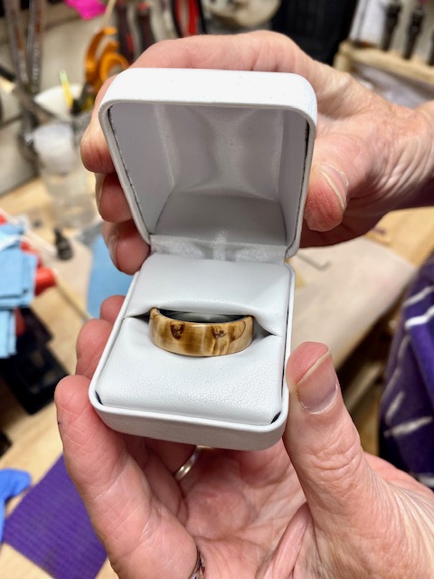

I made a Maser Burl titanium core ring for my daughter's husband to be. It was mostly to be ceremonial as he works hard physical labor and rings are dangerous. It was tricky but worked! Should be easier the second time around. Plan to make a few for myself and gifts now that I have the equipment.

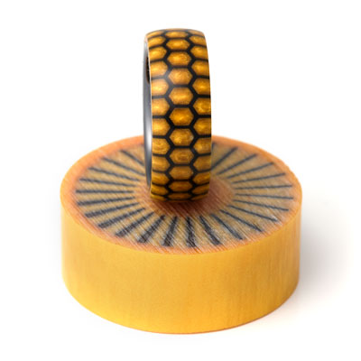

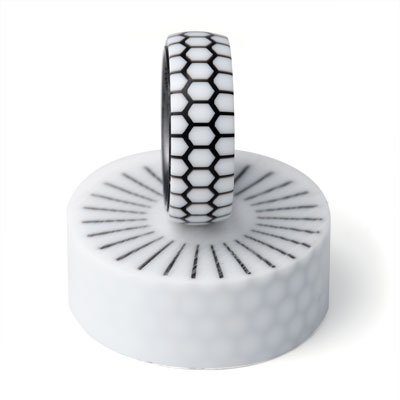

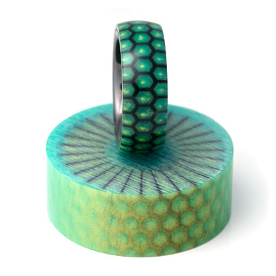

I find making them to be pretty fun. I have a full assortment of cores and blanks. Some blanks I've purchased, but most I cast, stabilize or 3D print/cast myself. With inlays, I've found the stainless steel and carbon fiber cores to be the easiest to work with and the most comfortable to wear. You can get excellent results using a wood lathe using ring chucks, collet chucks, along with a boring head that attaches to the tailstock (unless you've got a sloppy tailstock, of course). I have a full set of the ring chucks for every size of ring and they work well. All my rings have been gifted, except one. Sometimes it's not about the sale.
@carlmorrell is spot on with his tutorial. I do it the same way, with a few differences, but on my Powermatic 3520C and have never had any issues. I use thin double sided tape to attach the blank to the wood backer plate. To drill the initial core hole, using a jacobs chuck, along with a 1/2" forstner bit does the trick too. From that point forward, a boring head will become your best friend for sizing the hole to fit the core. As @carlmorrell pointed out, a dental pick, or even a fingernail will 'pop' off any excess glue, no problem. Facing the ring blank on a wood lathe takes a steady hand, but is doable. I like to do the final shaping with my EasyWood Ci2 and negative rake radius cutter and then sandpaper for the last little skiff. 3D printed and wood rings get a CA finish, wet sanded and polished with Magic Juice. If you're the creative type and love learning something new, give it a go! There's always going to be an initial investment in time and equipment, for obvious reasons. CSUSA has some excellent videos on how to make them using a standard wood lathe. You can view some of them here:
I'm a caster and have cast thousands of ring blanks for suppliers. I supply blanks for both US and Canadian suppliers and in my humble opinion, they are and have been spot on with bringing these products to the masses. Ring making is obviously very popular outside of pen-turning. Pen-turning suppliers who offer a healthy line up of ring components are capturing new customers outside of their normal pen customers. I'd say they're pretty smart for doing so. My current ring blank orders confirm it!

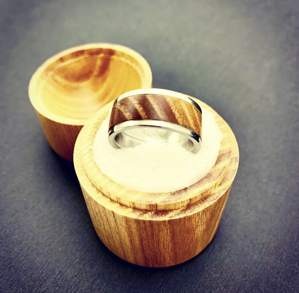

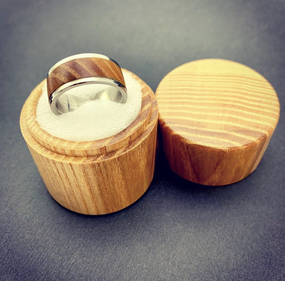

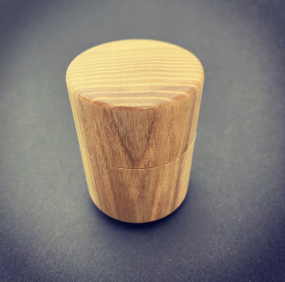

One short note: I had a customer ask me to make a wooden wedding ring out of a family heirloom baseball bat (no pressure)! Yes, he realized the bat would get cut up and become useless, but he was all in. It turned out gorgeous and I even made a ring box for the ring out of the same bat (pictures attached). I charged him $300.00 and he was very happy and grateful.
