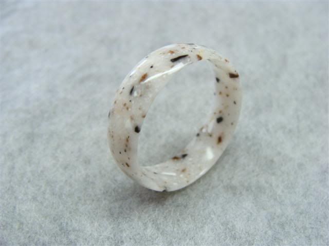

Tried this for the first time today .
Why ? ? ? . Because I am always up to a reasonable challenge and just to see if I could . . . lol
Will I make more ? . . Probably not unless someone specifically asks for one but it was a nice fun little change from other types of turnings.

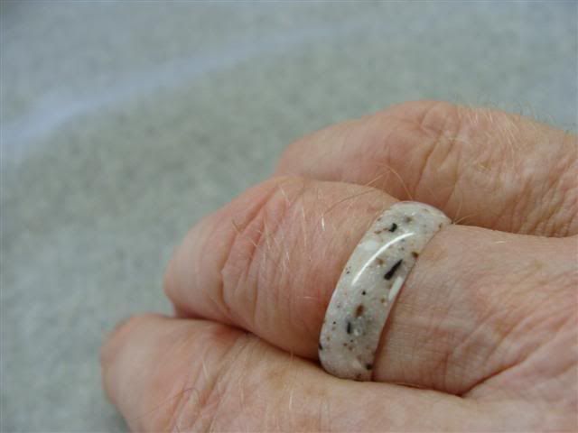

And here it is modeled on my finger .

That is some nice turning. Looks like a challenge for sure. It is also pretty. I'd suggest you give up the ring modeling though. Maybe someone with a little less hair on their fingers....:biggrin:

Ya . . I haven't shaved lately . :biggrin:.
I thought of getting a pretty young lady to model it but didn't want to get you guys all excited :laugh:
The turning is by far the easiest part. Sizing it exactly for a proper fit takes most of the time when making those.

Nice "one" William. There's a ring sizing chart available to help you determine 'size' should you decide to make/sell for a custom fit. Have made quite a few myself in various species of wood, but your choice of corian certainly makes more sense (strength factor).

The first one was just a little too tight on the inside diameter. Didn't figure on the small amount our fingers swell a little at certain times of the day.
Made another one and this time changed my method slightly and sized the inside more accurately before turning the outside.
Here is the one from yesterday and the one I made today. Got it down to less than an hour this time from start to finish..
First person that has a good fit on a finger for the light color one will have a free ring.
I took some pictures this time as I went along and and if they turn out OK , I will put a bit of a tutorial together in the next day or so showing how I went about it from start to finish .
