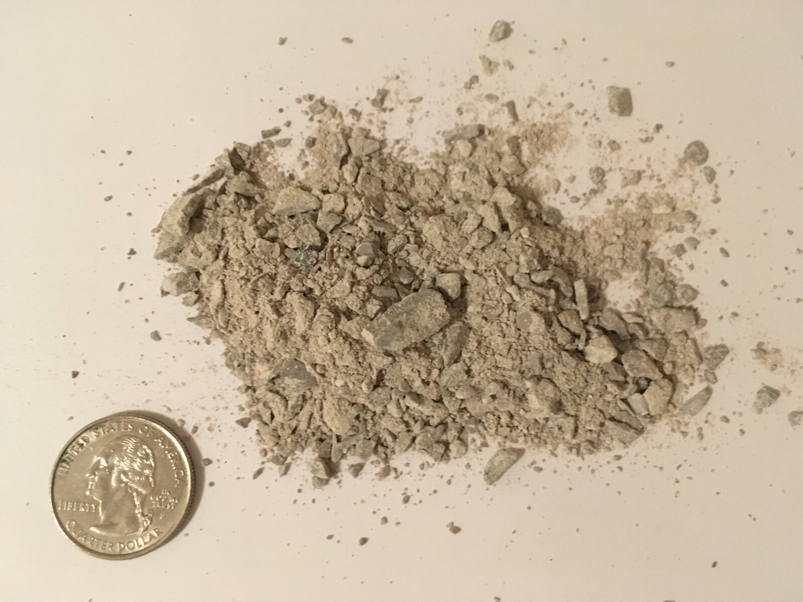

Here's a sample I got at the quarry. It seems to be just as much sand as rock. After it's compacted I'll have this 2-3 in thick. Is there anything I can add to it that's cheap and I can get in bulk that will help it harden with water added?

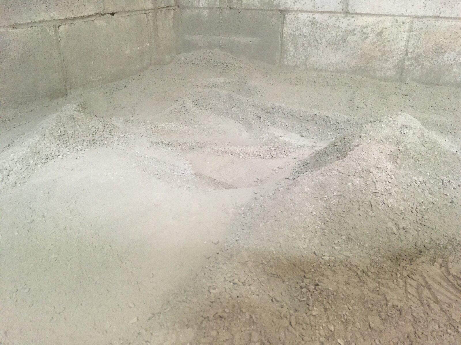

I really don't know if I would have chosen to do this if I would've known exactly how much effort this was gonna take. In for a penny in for a pound I guess. So I got my 20x 47lb bags of type I/II portland cement evenly distributed (1 bag per ~18 sq ft, about 390 total) and raked into the top 2-3 inches of the 1/4" and below limestone fines. Rented the smallest plate compactor, 13" model and when I ran it over the mixture it basically cut huge tracks vibrating down through the rock spitting it out from the sides of the plate. I think the problem is the added cement powder has made for a fairly slippery mixture, something that a larger rock substrate might not suffer from. Giving it a second try I ran the compactor at it's lowest speed and although it was more manageable it basically did the same thing. The machine did manage to leave some of it compacted so I know it can work, just not this way. Good news is the compacted stuff looked filled in with almost no gaps so that bodes well for it setting up proper.
This was the scene after I got to the end of the first row, approaching from the left, and tried to pivot...
