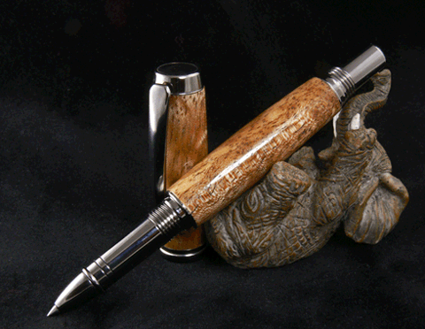

I've been trying a variety of finishes looking for the one that suits me best. This pen is only my second try at a laquer finish and to me there is no doubt that this is the "one". IMHO nothing else has the depth and clarity of laquer. Laquer is definately the one for me!!
VirgilJ
Apr 25, 2007
116
Brooksville, Florida, USA.
I'm using Deft thinnned about 20% and airbrushed.The airbrush puts on very thin coats so I'm using 4 coats. May change that as I gain more experience.

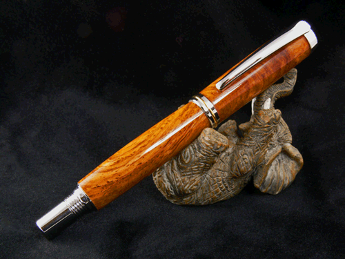

Another photo that shows the finish a little better.
<br />
For those of you with more experience with laquer, I would be interested in learning your techniques.

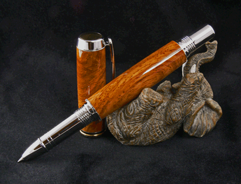

This pen has my first attempt at a laquer finish.

That looks excellent! Did you sand or micro mesh between coats and on the final coat? I love the smell of laquer but hate the CA smell. I'm sure those fumes are not helping what is left of my brain.- Chris
VirgilJ
Apr 25, 2007
116
In my limited experience it's not necessary to sand between coats. The laquer isn't dry enough anyway for at least a week. I believe that laquer melts the coat below it when you apply the next one.
This pen has four coats of laquer, a week to cure, and a polishing with Hut plastic polish.
