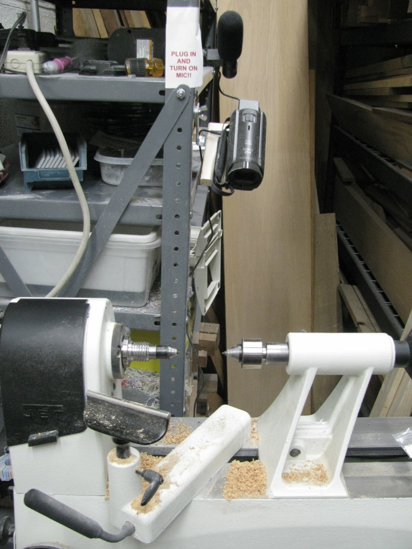

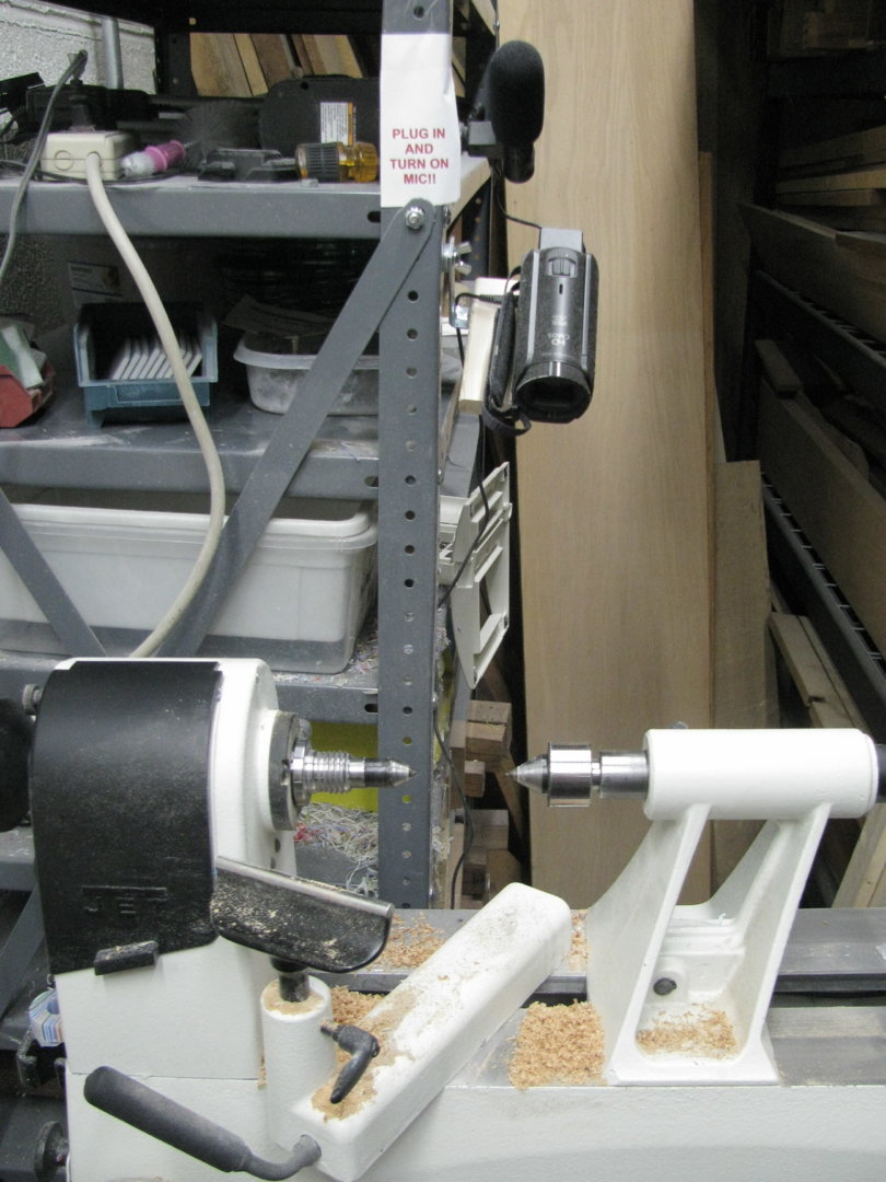

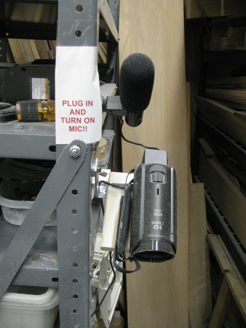

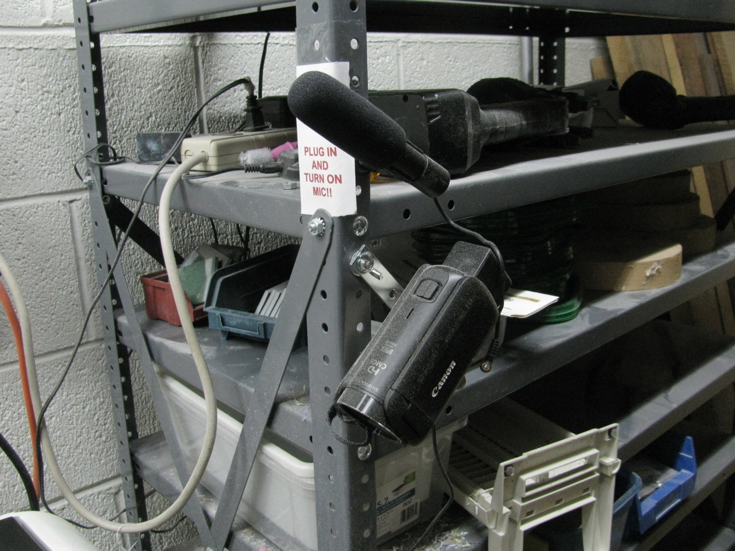

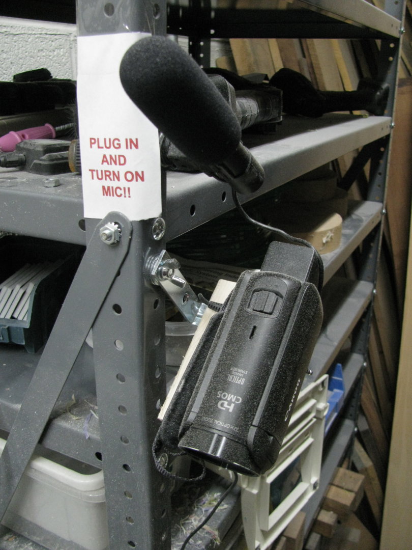

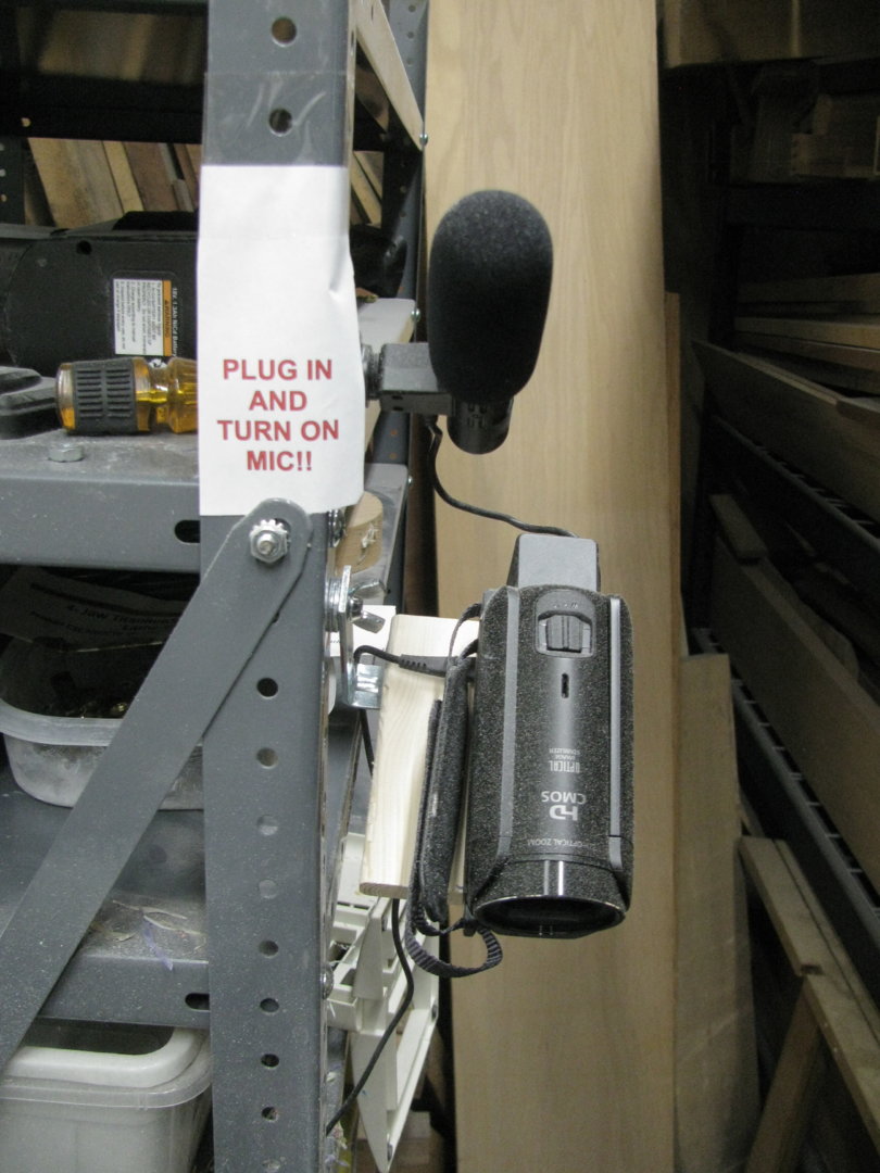

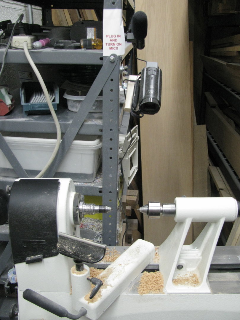

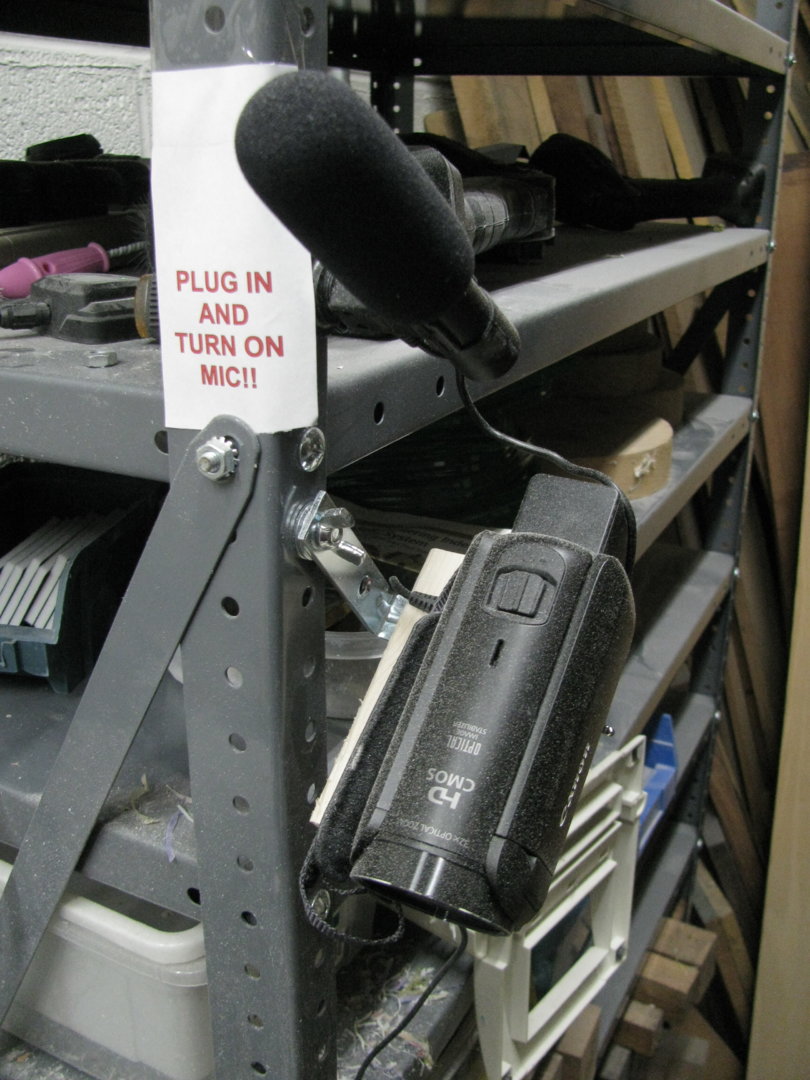

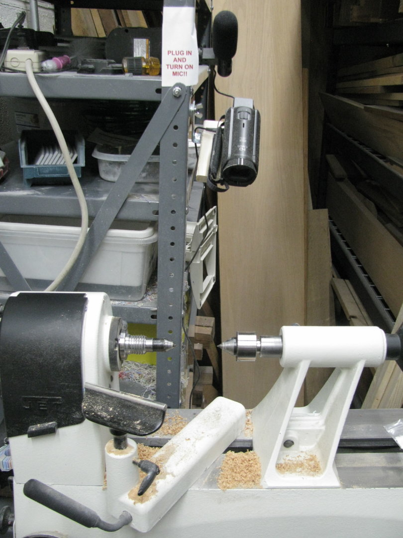

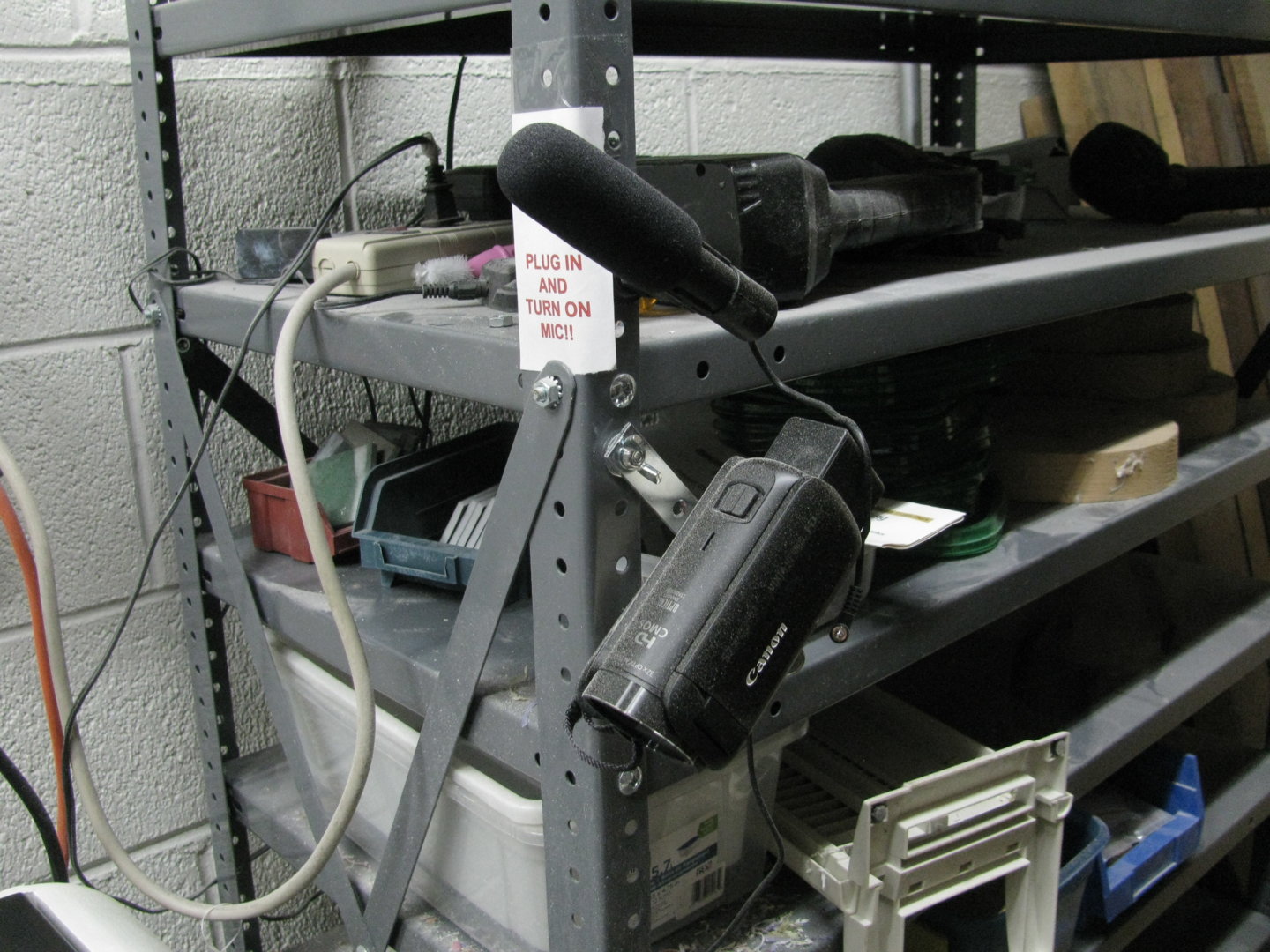

I've spent literally HUNDREDS of pennies for the wood, "L" bracket, etc. Not to mention the signage to remind me to start the
audio (that's new in the last month)!! Hope this gives you some ideas!! IMG_9109.JPGIMG_9110.JPGIMG_9111.JPGIMG_9112.JPGIMG_9113.JPG

Actually, the L bracket and wood base have been mounted at a couple different spots. When I got the new lathe and it went to Chicago to be used for the MPG, it had to have a stand.
When it got home, I liked the stand, so it was relocated at a 90 degree angle to the original spot on a tool chest. That gives me the tool chest top for working area--I am growing to like that!!
Point is, the angle iron and wood arrangement can be mounted on a wall behind your lathe, you just have to dream up a way (I do not like to add holes to my walls if I can avoid it).
And yes, having the camera on that shelving unit does hold it steady. The stand for the lathe holds IT fairly steady. So, usually the picture is good for YouTube.

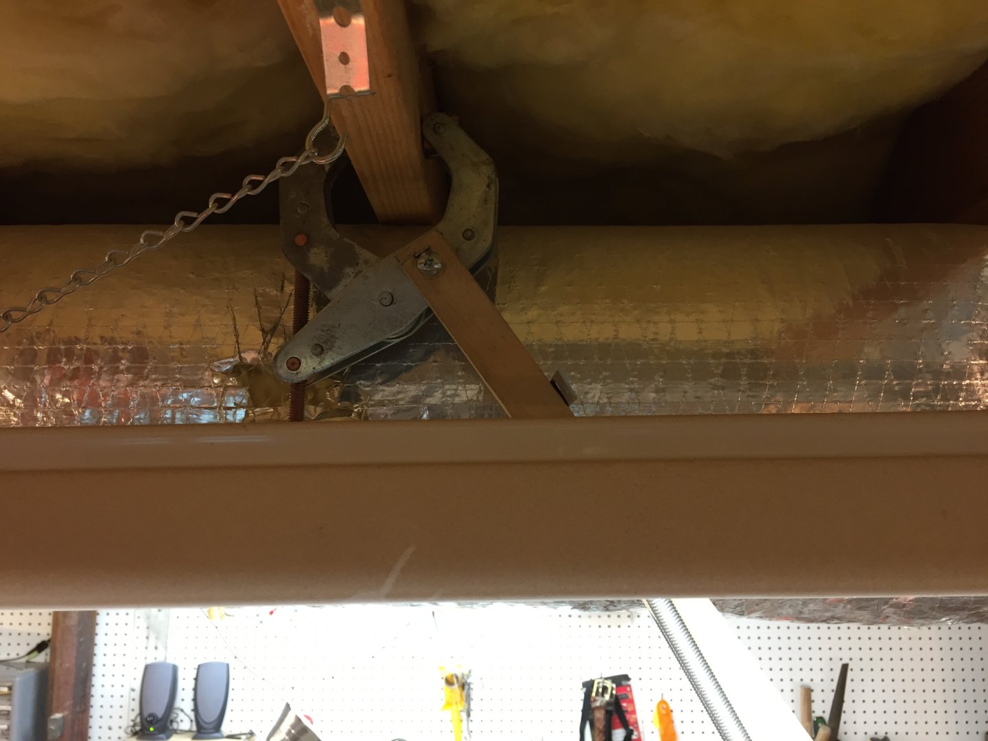

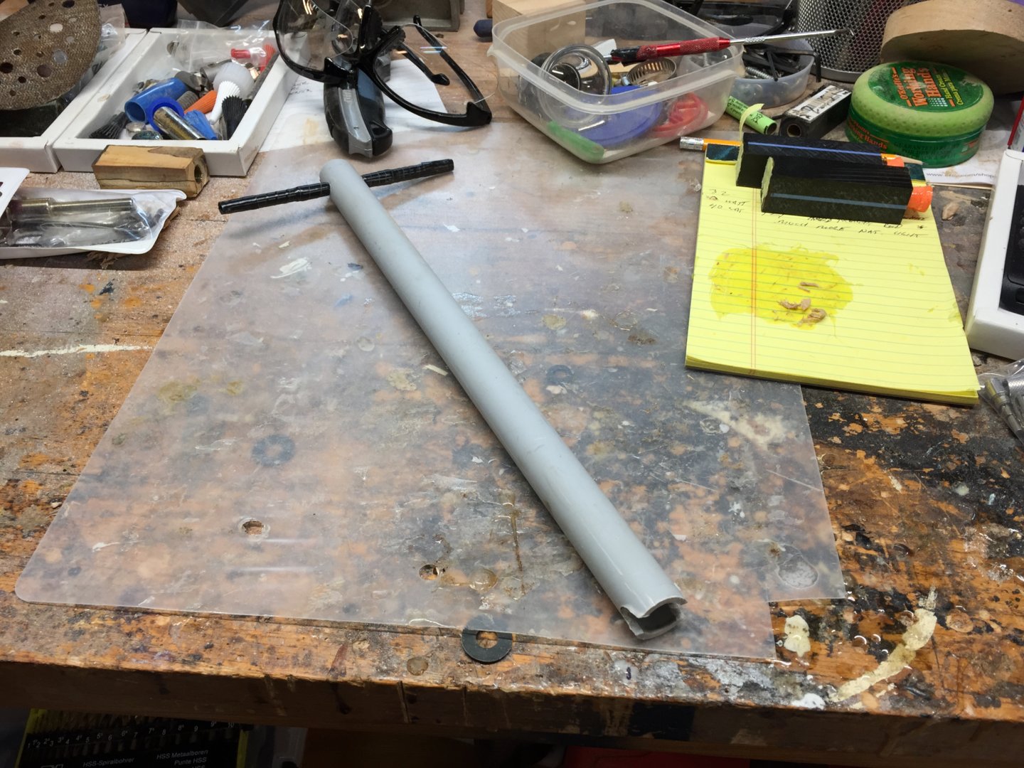

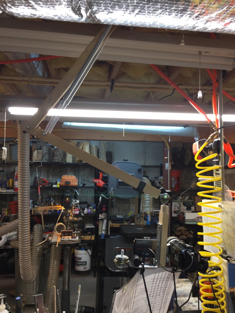

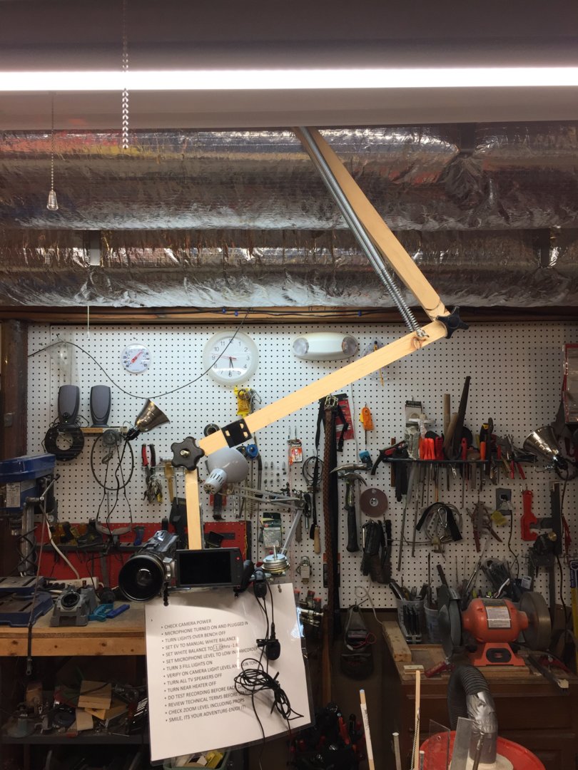

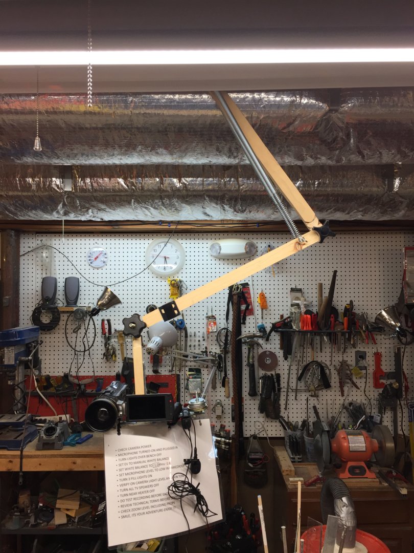

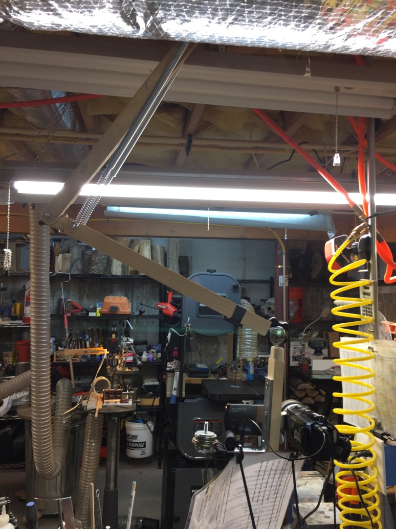

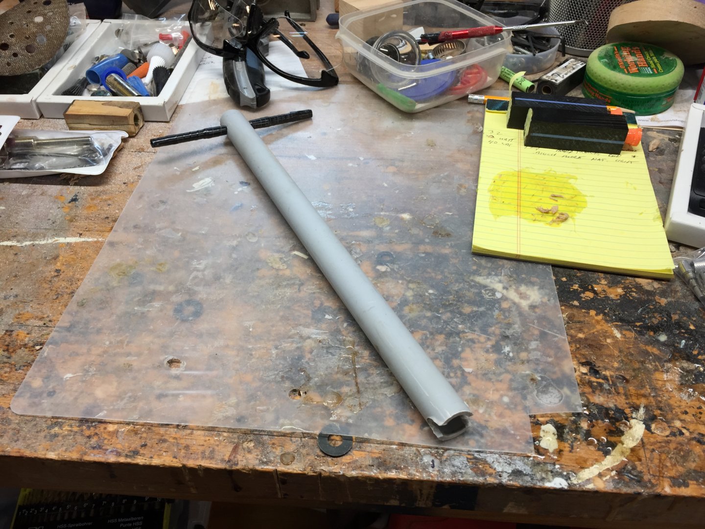

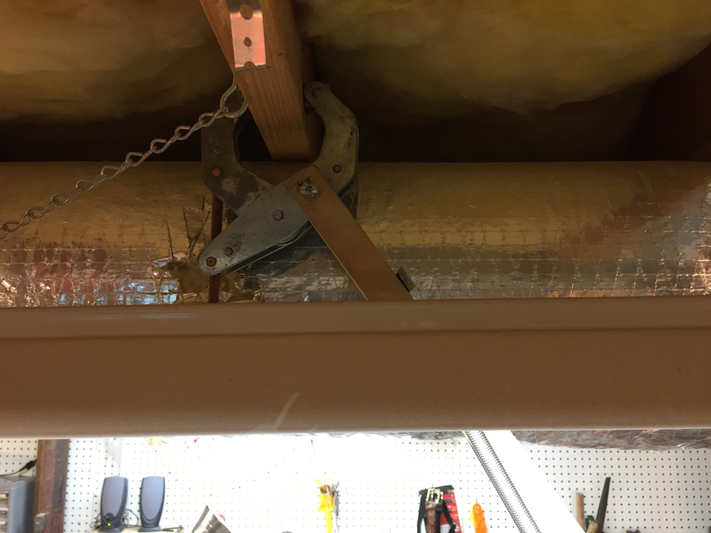

Here are some pictures of my set up. The camera mount turned out to be the simplest part of producing videos. A lot more effort goes into post editing the raw video so the end product accomplishes communicating the message you want to. I have only done about a dozen videos but I am learned the two most critical elements which are very hard to correct in post processing are crisp clear audio and proper lighting/color of the focus and any people in the shot. Turns out correcting skin tone is actually not very easy with the wrong lighting in doors. I agree with your comment you will probably end up making your own camera mounts unless you want to spend big dollars. The clamp I used for the arm is a basic welding clamp which you can buy from amazon for about $19. The rest was hardware and scrap material I had around the house except the screen door springs which cost a couple bucks at home depot. The clamp I used for the arm is a basic welding clamp which you can buy from amazon for about $19. The rest was hardware and scrap material I had around the house except the screen door springs which cost a couple bucks at home depot. There is also a picture of the gray handle I use to reach up to the clamp because my ceilings are too tall to reach. When I do multi camera shots I can usually find an angle to put the second camera on a tripod which give me the shot I want.
Hope this sparks some ideas, good luck.

Ray, I really like the wood arms you've fabbed. My worry with using something similar to this has been how much weight the arms can support and still hold the angle. Are you using anything where the knobs are at your connections other than simply a pure friction fit? I'm referring to where one wood arm is actually contacting the next wood arm in line.
I've got an $800 Panasonic Lumix GH4 and a Blackmagic Micro Design Camera that was also about $800. My intention is to use both of those, but again, want to make sure that 1. they're safe in the arms of the... wooden arms.... and 2. that the angle will support the weight and not slip over time.
Understood, I would use plywood or metal tubing instead of scrap pine like I did. The springs are adjustable so if the knobs come loose it lifts the camera up a little. This took a little trial and error to get it balanced so the friction is what holds the camera arm from going up. Lastly the "L" brackets allowed me to put some weight on the other side to keep the camera from causing the vertical arm from tipping. So I essentially have 2X the cameras weight on the end of the arm. I just use some washers to keep the knobs tight. The vertical arm hanging on the eye hooks allow me to pivot the camera right and left and the "L" brackets are on one bolt which allows me to point the camera down as well. The one thing I have found I need to keep in mind is to remove the camera before I relocate the bracket because I got lazy once and the whole thing nearly plummeted to the floor as I was undoing the clamp. So if you try something like this, make sure you remove the camera first and don't be like me
:rolleyes:. So good luck and let us know what you end up with.
