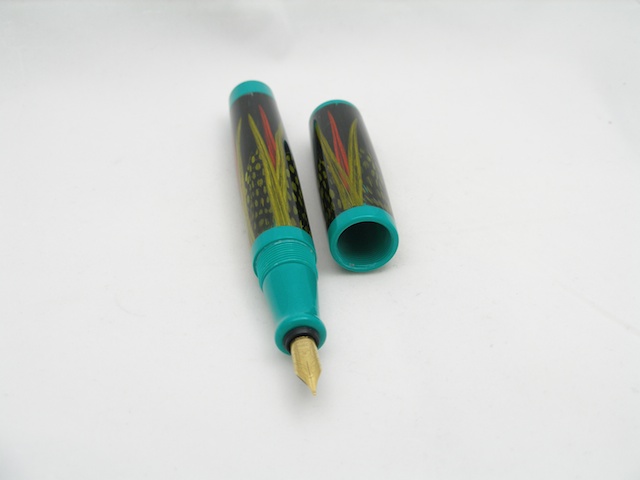

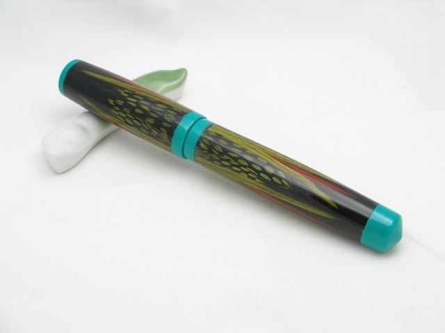

This is my fourth kitless pen made to see if a feathered pen could be done in the kitless format. Naturally I took advantage of Marla and had her apply the feathers. The green virgin sewer pipe was handy but isn't going to wow too many people and isn't in my plans for future pens. Nib and feed are Schmidt 6mm medium. Now that I know it can be done I will refine the how and improve on the shape. I know it is a little rough around the edges and would like to hear what you have to say.

Very unique, I love the contrasting colors on this one. Really stands out in a positive way!
glycerine
Aug 7, 2009
3,462
Fayetteville, NC
Wow, very cool!! Am I correct in saying that's a solid piece of pipe and you just cut indentions for the feathers to be placed and then recast or CA'd on top of that, sort of an inlay?
hewunch
Aug 5, 2008
4,661
Albany, GA
I like the shape, I like the feathers, but the green... not so much. But as a Proof of concept... Top notch!
BRobbins629
Passed Away Dec 28, 2021
In Memoriam
Mar 8, 2006
4,037
Richmond, VA, USA.
Looks really great from here. I too really like the color combination. If you have issues with the pipe, you could always cast some. Only thing I might do different is recess the feed so its flush with the top of the section.
Simplex
Aug 22, 2010
155
Mather, Ca
Although I'm not a huge fan of the color of the components, I do like where you are going with the whole idea. Keep going!
Dalecamino
Local Chapter Leader
Jan 2, 2008
14,572
Indianapolis, In.
I knew you would come up with something that would impress alot of people, including me. I guess mopping the bathroom floor paid off. Marla made some really nice blanks for you. I may never post another pen now :biggrin: Great work Pete.

Thanks for all the encouragement. There are no brass tubes, so in essence you have to make them from the blank and then cast. A lot more precision and work involved. Now I have to grab the thinking stick and get back to cleaning. :biggrin:
That explains quite a bit. I think you have hit a milestone with your design and can see you taking it much farther. I am really impressed with your results.

Awesome Pete! I've been staring at a set of feather blanks wondering about doing something just like this. Mine are tubed but I think I can work with that. VERY inspiring!

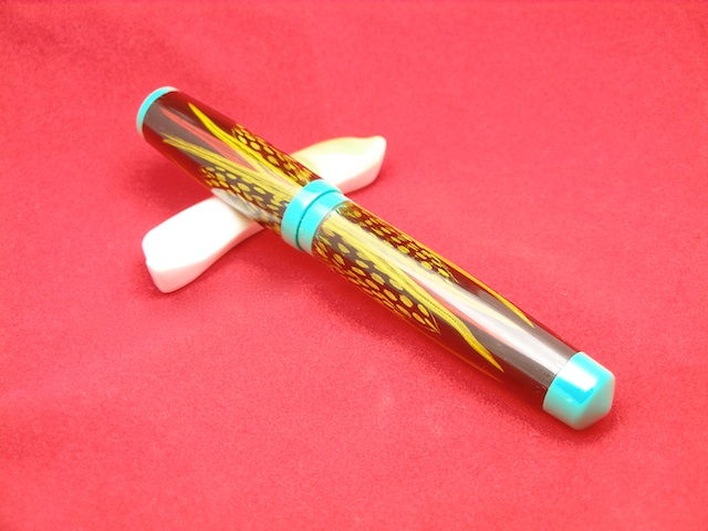

If you shot that pen with a darker background, I bet people would react differently to the colors. The color is loud, and still, most folks won't dig it, but the light background makes the image look "sick", if you will.

Well okay, try these on for size. :) They're the other background colours that came with the little light tent. The red one should be a bit redder. :rolleyes:

I see nothing but positive with that sewer pipe. I think you are off your rocker, it's a perfect combination. The entire pen looks spectacular, the shape, the polish the photo's, it's an exceptional pen. The only thing I don't like is that it seems to have no clip and maybe the alignment is a touch off, but that's pretty minor.

IMHO, I agree with you about the sewer pipe. I think ebonite would have been a much better choice. LOML agrees, you dont wanna know what she said.
Otherwise, love the pen. When I saw the thread, I HAD to click. Beautiful concept.

Great looking pen. How was the C-900 to thread? I turned quite a bit of PVC, but haven't used it for a "kitless" application. Now that I know it can be done that's a different story all together

Since the pipe was handy and free I used it because it wouldn't bother me a bit to toss the screw ups. Having to toss Ebonite at about $20 a blank :eek: would be another story. Because it was free there were no rejects. :rolleyes:
Threading the PCV is very easy. I used Pam to lubricate the taps and dies. When done I thoroughly cleaned off the metal lathe and re-oiled the surfaces to stop rust. The threads will need to have the cuttings pulled off at the ends of the thread grooves because it doesn't break on its own. Just like the long strings when you turn it and they wrap around everything, forming big nests.

LOOOOOOOOOOOOOOOOOOOVE the colors on it! That PVC is totally awesome. And the black background really syncs with the pen. Great work, I hope that one doesn't wind up having a ton of new parts made for it!

Overall a nicely shaped pen. Great concept. I do agree the colors are a bit too contrasting but as a proof of concept it's wonderfully executed. For me, the nib itself is too small in size for the overall pen and puts the proportions a bit off. A #6 would be more to size in my opinion.

I agree Ty. Four years ago when I made the pen I was just starting to play with kitless pens. All I had was a 14mm triple tap and die set from a group buy and my basic imperial tap and die set that I had from my wrenching days. I picked the #5 Schmidt nib because the tap for it also was the same as their cartridge rollerball. Proprietary nibs from every maker have to have the special tap to match. :rolleyes: The Schmidt is the only one that does double duty, so was a good, in my mind, first choice.
