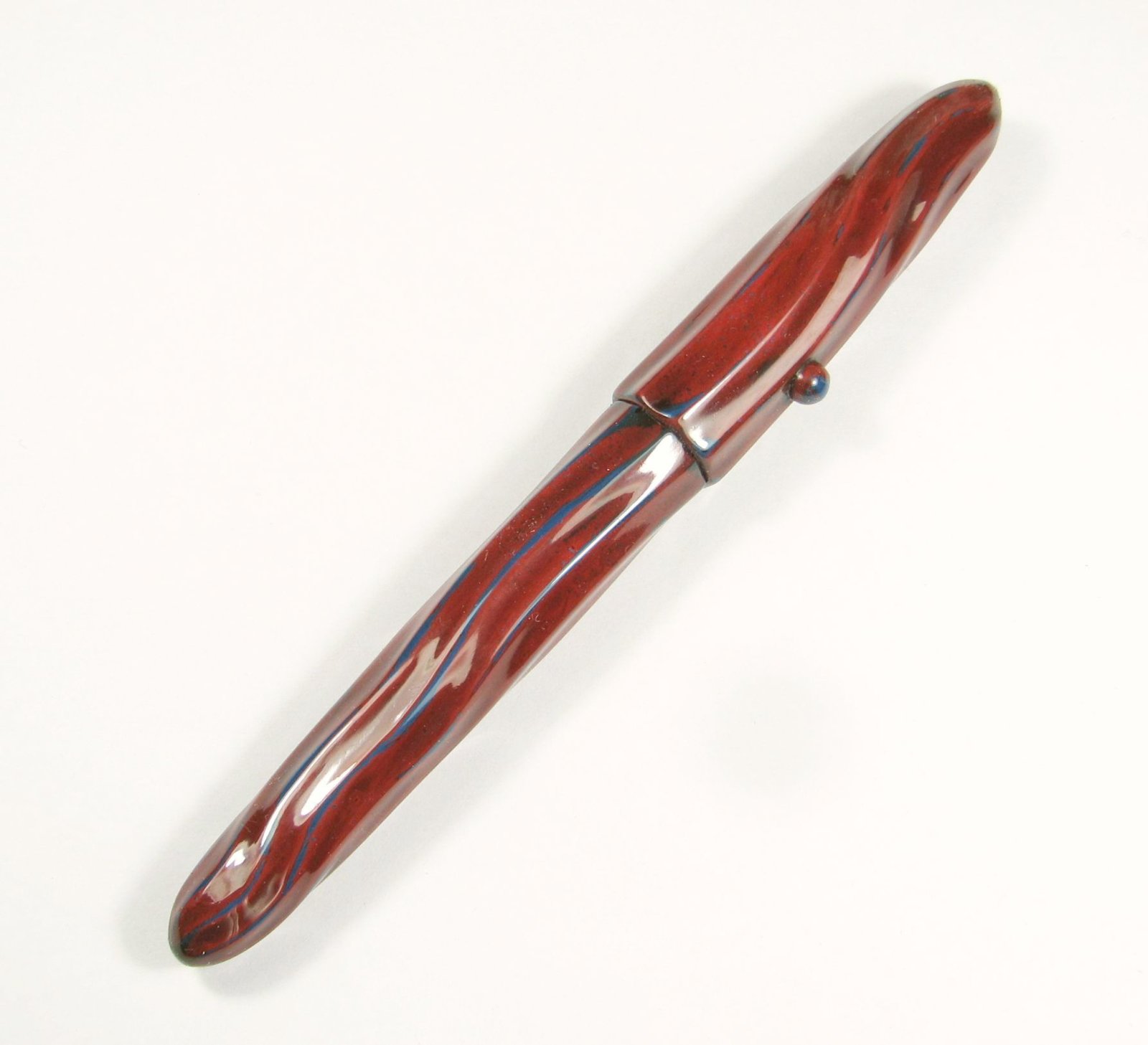

Some time ago @Teodor showed a pen holder I found really nice. He used an Urushi technique with two layers of different colors, and sanding makes the one underneath showing up. Usually, it is used with vermilion on a black base, but Teo used blue instead of black, that was very attractive.

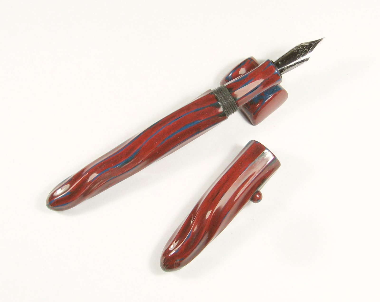

So I decided to make a pen using this technique, with its pen holder of course. I thought a faceted pen would make the sanding more natural. So let me introduce my blue Negoro faceted fountain pen:

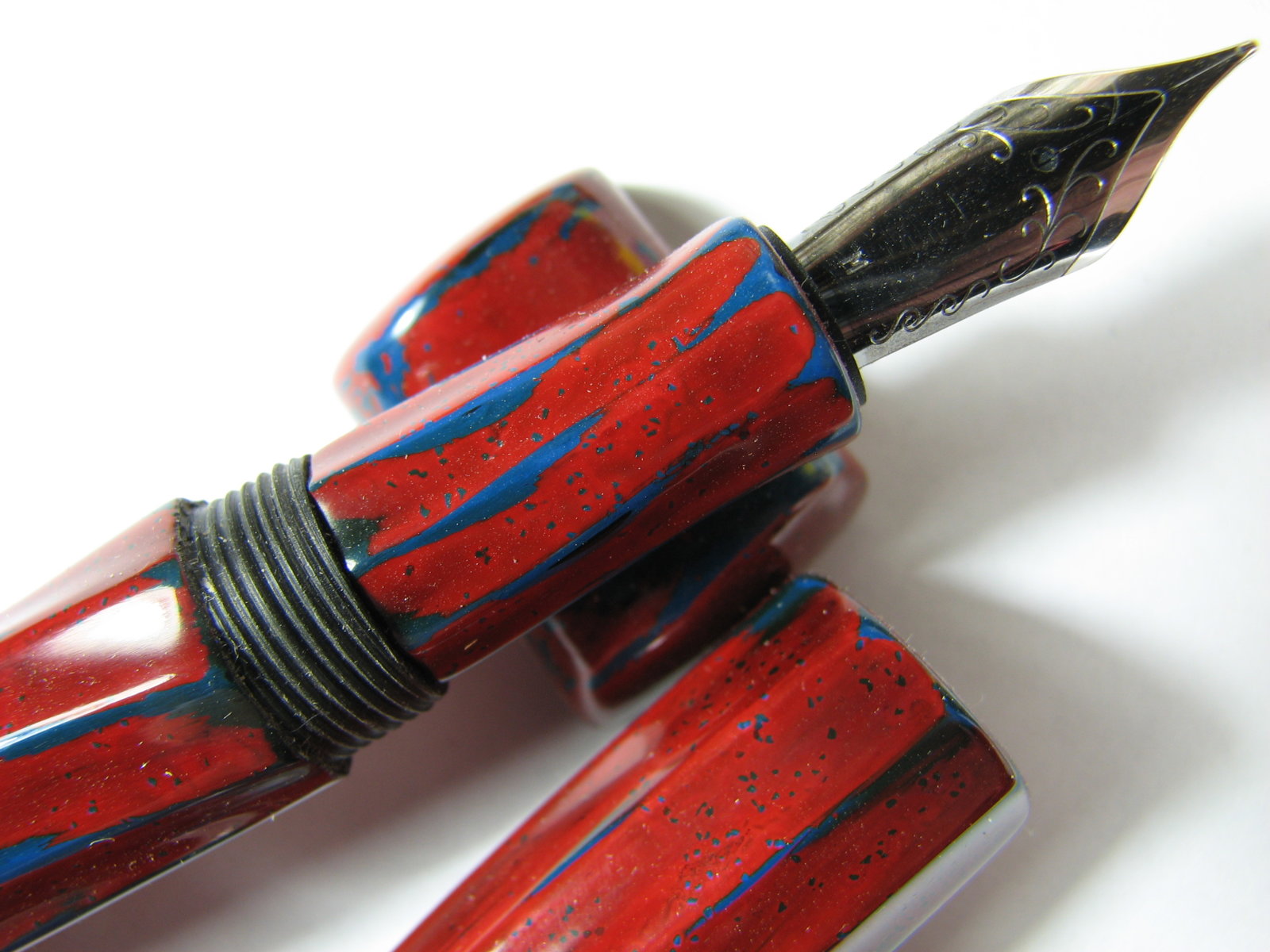

Here and there, I added some blue dry lacquer powder in the red Urushi to get a more vibrating color:
C&c very welcome, and a big thanks to Teo for inspiration!
Wonderful collaboration of concepts. I say this only as inspiration deserves credit, and acknowledgement of such deserves equal credit, far too many do not acknowledge where their inspiration came from, you did. 👍
Beautiful artistry Pierre. I love your work and appreciate your inspiration and use of it's impetus. Well done.
This is a superb work - I love the blue streaks!
Pierre, I never thought of it when I lived there but I lived in the neighboring prefecture for 14 years to Wakayama and Iwade-shi (Negoro) and went there on several occasions with friends but never connected Iwade Shi and Negoro urushi finishes. That basically is what defines most of Japanese lacquer-ware.
Your pen is magnificent! Thanks for posting it.
As Mark said .... SUPERB workmanship, Pierre !!!!
Congratulations !!!
I do not know how you did the faceting so perfectly !!! . VERY well done !!!
Thanks gentlemen!

How did your turn/shape the facets, please?
Not sure if a Pen Wizzard can make that. In fact I drew (most important step), rasped, filed, scraped, sanded and polished, like my Bash kitless. I love hand work! :)
