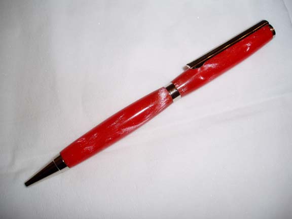

I just finished a PR pen last night that I used MIXOL as the colorant, bought the stuff at Woodcraft, Just tried one color right now to get a feel, it mixed in very easily and provided a lot of opaque color to the blank, better than the colors available form Michaels for the resin, It did take a longer period of time to harden like draken says his take. But overall I am very happy with the results, there are lot of colors available from WC I plan on buying more and trying them. I will post a couple of pics tonight to show blanks and the finished pen.

As I posted earlier, here are pics of the MIXOL colored blanks and the finished pen
<br />
<br />
pics aren't the greatest, but hopefully it will show how well this stuff seemed to work. I'm going to keep spermint'n with this stuff. [;)]
