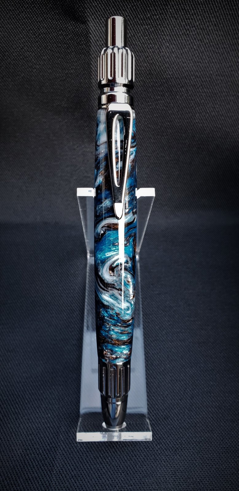

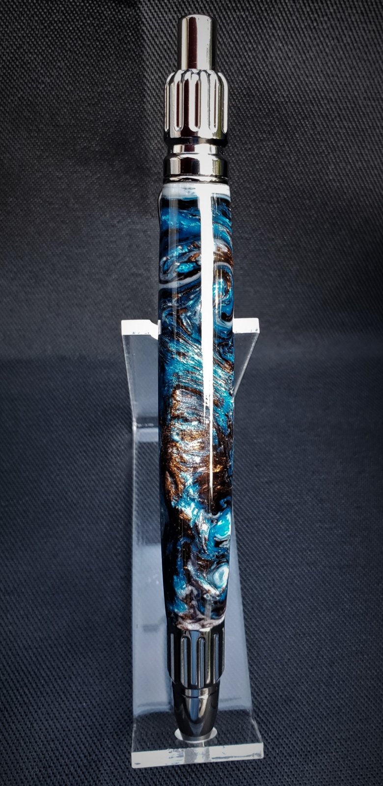

Here's my first one of these. I bought the starter set (and had 20% code).
Some differences/similarities from the Dura Click EDC:
  • Longer barrel/tube (more turning material to displace). Same bushings though.
  • No white adapter. I placed a Parker-style GEL refill in mine. The EDC couldn't accommodate the MV GEL that I had because of the white adapter.
  • The click finish matches that finish of the other components
  • The clicks is held on by the finial threads. This is where I may find myself using blue LT to prevent "The Spinning Clip Syndrome" :)
  • Schmidt transmission
  • I find the EDC easier to grip given it knurled section.
We will see how this goes. I think Exotics has these on sale this week.
