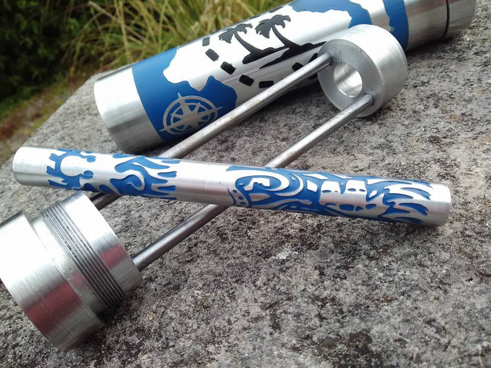

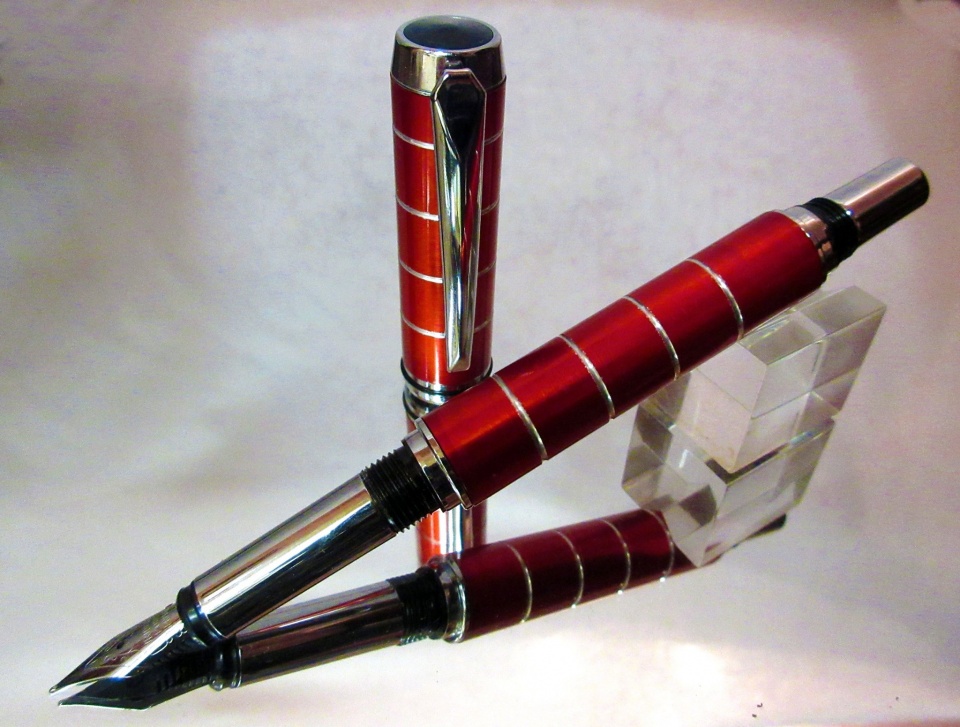

With these systems you can make these yourself:
attachment.php
attachment.php
Etching system
Stainless, Aluminium, all copper based alloys

Anodising System
Aluminium

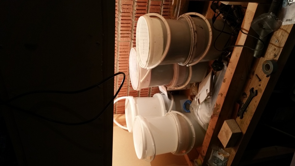

In this pictures theres:
An anodising tank
A chrome tank
A black Chrome tank
A zinc tank
And 4 dye tanks.
Minimal space :smile:
