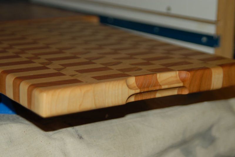

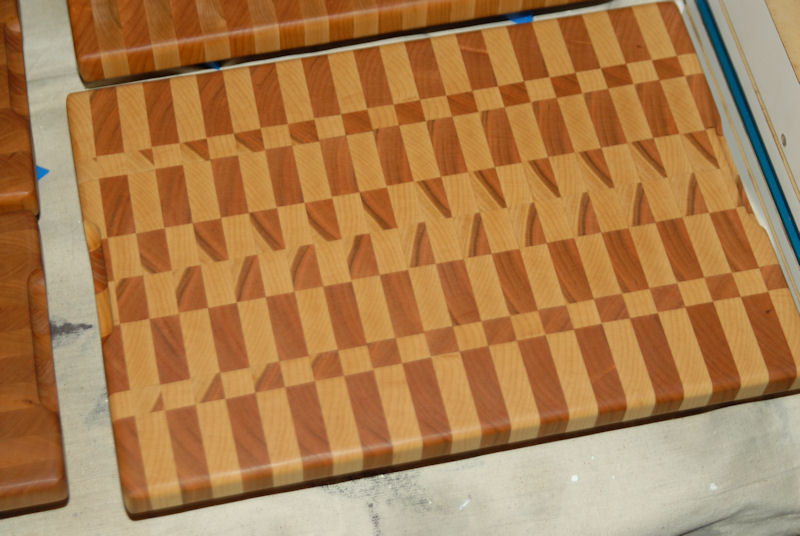

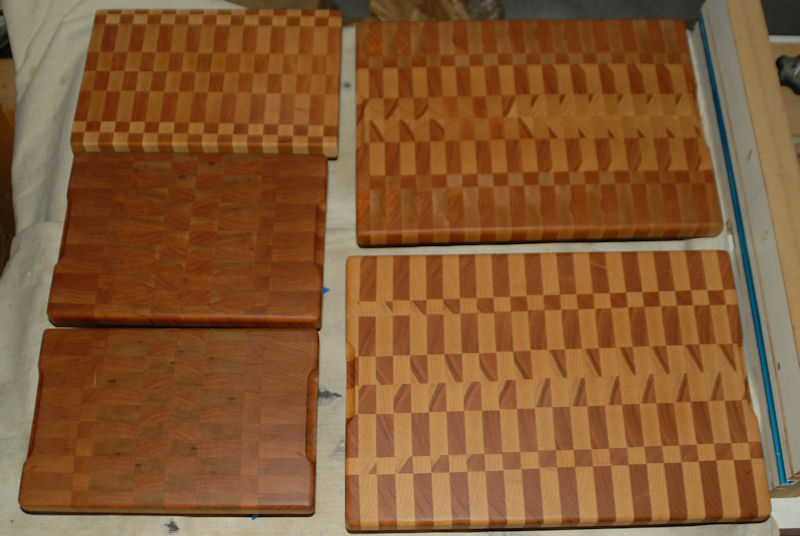

Santa has been busy in the workshop again :biggrin: Five end grain cutting boards. Three of them are maple/cherry and the two smallest ones are cherry.
The boards have finger pulls routed in them on the top and bottom surface so they are full reversible.
