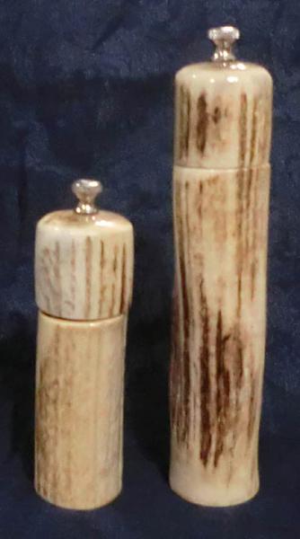

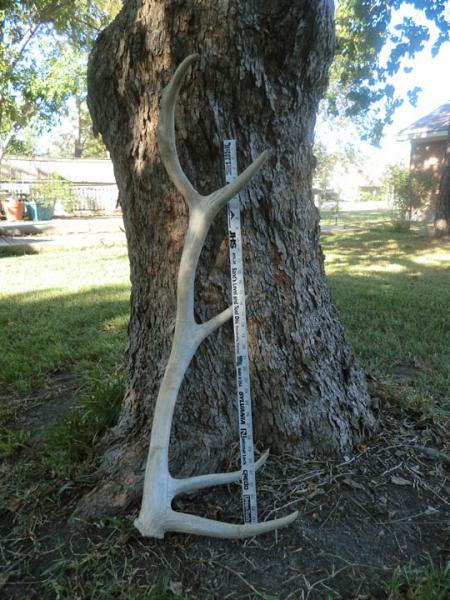

Picked up this elk antler a few months ago with the intention of making bottle stoppers out of it. After looking at it for a while and seeing how straight the main shaft was, I decided to try a salt and pepper mill.
The salt mill is 6" tall and the pepper mill is 9" tall.

My first thought was "Long Bow riser!" the salt and peper mills look great! It's not often you see one with that strait a mian tine.

Manny those are great, that had to be one large Bull Elk to have antlers that big, but I've never seen one with the beam that straight, what a neat fluke of nature.

that's really cool!!!!! did it present any challenges when you drilled it out?
Sent from my Epic using Forum Runner
It was very close for the inset for the mechanism, no problem on the main bore. The challenge was getting enough CA in the marrow of the top to harden it to be able to cut the tenon, it was so porous it was difficult to kept from running out the bottom.
