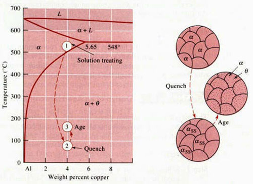

With regards to hardening, you could look into precipitation or age hardening. Here is an article i have on it. not sure where i picked it up from, but never the less its a good reference about the process.
Precipitation hardening, or age hardening, provides one of the most widely used mechanisms for the strengthening of metal alloys. The fundamental understanding and basis for this technique was established in early work at the U. S. Bureau of Standards on Duralumin.
The importance of theoretical suggestion for the development of new alloys is clear from the historical record. At the end of the 19th century, cast iron was the only important commercial alloy not already known to western technology at the time of the Romans. When age hardening of aluminum was discovered accidentally by Wilm, during the years 1903 -1911, it quickly became an important commercial alloy under the trade name Duralumin.
The strength and hardness of some metal alloys may be enhanced by the formation of extremely small uniformly dispersed second-phase particles within the original phase matrix in a process known as precipitation or age hardening. The precipitate particles act as obstacles to dislocation movement and thereby strengthen the heat-treated alloys. Many aluminum based alloys, copper-tin, certain steels, nickel based super-alloys and titanium alloys can be strengthened by age hardening processes.
In order for an alloy system to be able to be precipitation-strengthened, there must be a terminal solid solution that has a decreasing solid solubility as the temperature decreases. The Al-Cu (Duralumin is an aluminum alloy of 2XXX group) phase diagram shown in Figure 1 shows this type of decrease along the solvus between the α and α+θ regions. Consider a 96wt%Al – 4wt%Cu alloy which is chosen since there is a large degrease in the solid solubility of solid solution α in decreasing the temperature from 550°C to 75°C.
attachment.php
Figure 1: The aluminum rich end of the Al-Cu phase diagram showing the three steps in the age-hardening heat treatment and the microstructures that are produced.
In an attempt to understand the dramatic strengthening of this alloy, Paul D. Merica and his coworkers studied both the effect of various heat treatments on the hardness of the alloy and the influence of chemical composition on the hardness. Among the most significant of their findings was the observation that the solubility of CuAl2 in aluminum increased with increasing temperature.
Although the specific phases responsible for the hardening turned out to be too small to be observed directly, optical examination of the microstructures provided an identification of several of the other phases that were present. The authors proceeded to develop an insightful explanation for the hardening behavior of Duralumin which rapidly became the model on which innumerable modern high-strength alloys have been developed.
They summarized the four principal features of the original Duralumin theory:
  • age-hardening is possible because of the solubility-temperature relation of the hardening constituent in aluminum,
  • the hardening constituent is CuAl2,
  • hardening is caused by precipitation of the constituent in some form other than that of atomic dispersion, and probably in fine molecular, colloidal or crystalline form, and
  • the hardening effect of CuAl2 in aluminum was deemed to be related to its particle size.
The precipitation-hardening process involves three basic steps:
1) Solution Treatment, or Solutionizing, is the first step in the precipitation-hardening process where the alloy is heated above the solvus temperature and soaked there until a homogeneous solid solution (α) is produced. The θ precipitates are dissolved in this step and any segregation present in the original alloy is reduced.
2) Quenching is the second step where the solid α is rapidly cooled forming a supersaturated solid solution of αSS which contains excess copper and is not an equilibrium structure. The atoms do not have time to diffuse to potential nucleation sites and thus θ precipitates do not form.
3) Aging is the third step where the supersaturated α, αSS, is heated below the solvus temperature to produce a finely dispersed precipitate. Atoms diffuse only short distances at this aging temperature. Because the supersaturated α is not stable, the extra copper atoms diffuse to numerous nucleation sites and precipitates grow. The formation of a finely dispersed precipitate in the alloy is the objective of the precipitation-hardening process. The fine precipitates in the alloy impede dislocation movement by forcing the dislocations to either cut through the precipitated particles or go around them. By restricting dislocation movement during deformation, the alloy is strengthened.

Check this out" apologies for quality of blurriness.. biggest image on the net i could find of this advert from 1953
attachment.php
