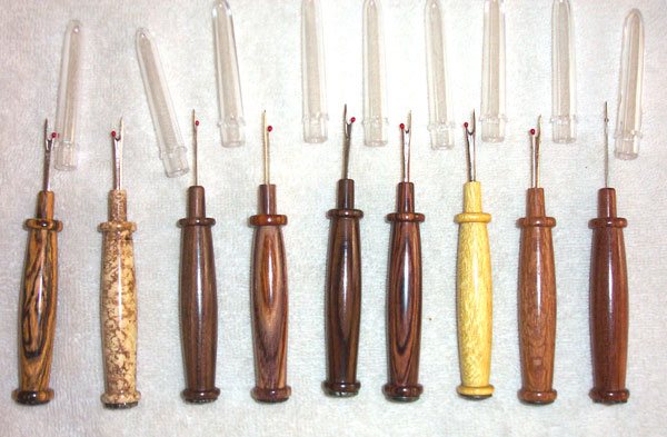

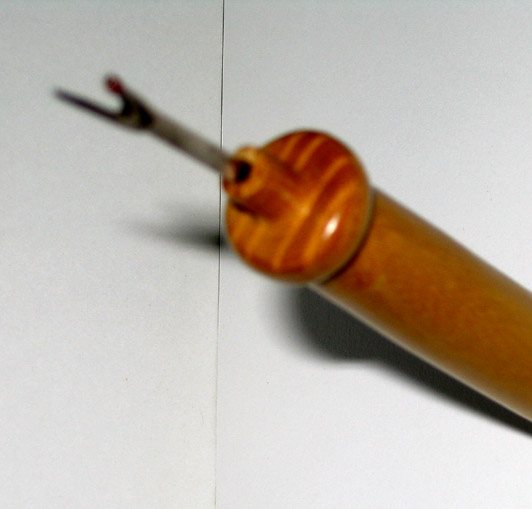

Ang got some bad news---Margie (the wife) bought everyone that Fritz had left in stock last week.
I do not know if they are going to get anymore or not. They are kinda a hit and miss deal as far as sales but last week she sold several in one day.
Second pic is out of focus but gives you a good ideal of how to make them. We just use a drop of thick CA to hold the cutter in place.

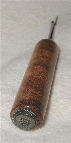

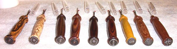

This is my version of the seam ripper. I turned between centers. Drilled hole to push the metal part in first on drill press, use it on the live center end of blank. Used spur center on drive end of blank.
Bought little metal scrap book prong things with designs on them and put them on the other end of blank. To mount them, I drill a hole big enough to accomodate the prongs. Bend both prongs in a "J" shape, in opposite directions, epoxy in the hole then push the decorative piece into the hole. This covers the unfinished end of the handle that I can't get to because it is between centers.

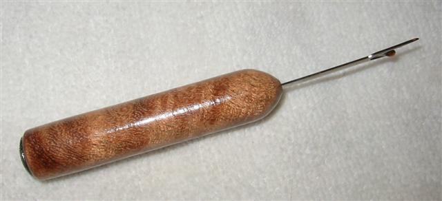

Well I'm pretty proud of myself- my first attempt at a seam ripper (well OK, there was that other attempt using a pin chuck that didn't even get it turned down enough to have any idea what it was aupposed to be!). Anyway, I was pretty happy with how this came out. Next time, I need to do something to plan for a way to hopefully have the plastic cover be able to go on and stay on- wasn't thinking about that design issue at all as I made this.
I used things from all of the posts to help me. I wasn't able to fit it in a jacobs chuck b/c I made it too large. So I was stuck with two ends that I couldn't quite finish. So on one end I left the inner part unfinished and then parted it off (yes, I used my parting tool to part something! that was a major step for me since I've been scared to do that for almost a year now after mine broke and flew off and tried to kill me!!!). Then I used an old button I had and drilled out an inset area using a forstner(sp?) bit and then CA'd that in. The end for the seam ripper itself is just made tight enough that it fits in snug, but I think I'm going to use Jim's epoxy idea, since I imagine it may come loose.
It's made out of mesquite from our very own Dario!
