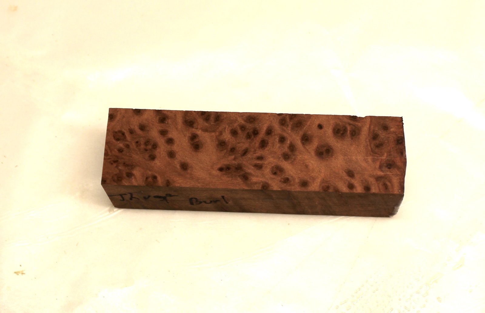

I will be using the PSI EDC Kit. https://www.pennstateind.com/store/PKEDCDST.html. I have assembled a segmented blank, 4-sided with a variety of polygons, a new design for me. I want to turn and assemble a "practice" pen before the segmented one. So I have a nice Thuyla Burl all drilled, tubed that is good to go. I will also try a "Glu Boost" CA finish for the first time. So there are several new elements for me. I'm not really concerned, just curious if others have any suggestions with this kit.
The pictures of the blank are in my basement camera...
These are the two blanks I will be using. I want to experiment with the Thuya Burl to get the kit procedure and Glu Boost down, then I'll work with the segmented blank.

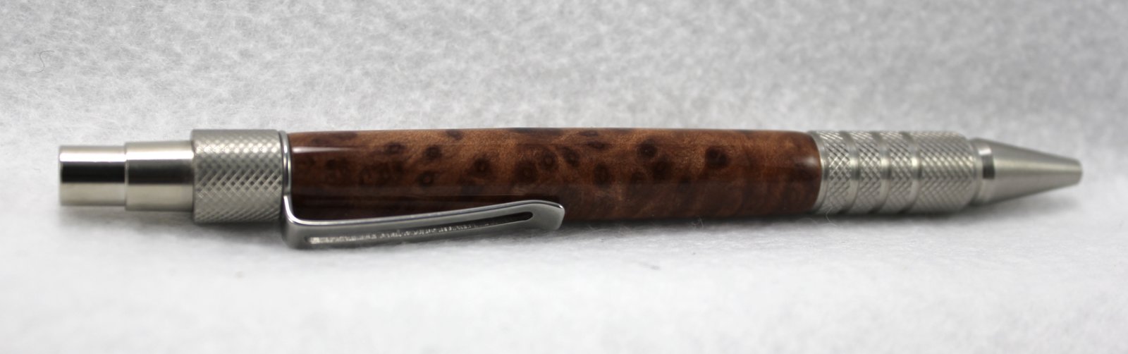

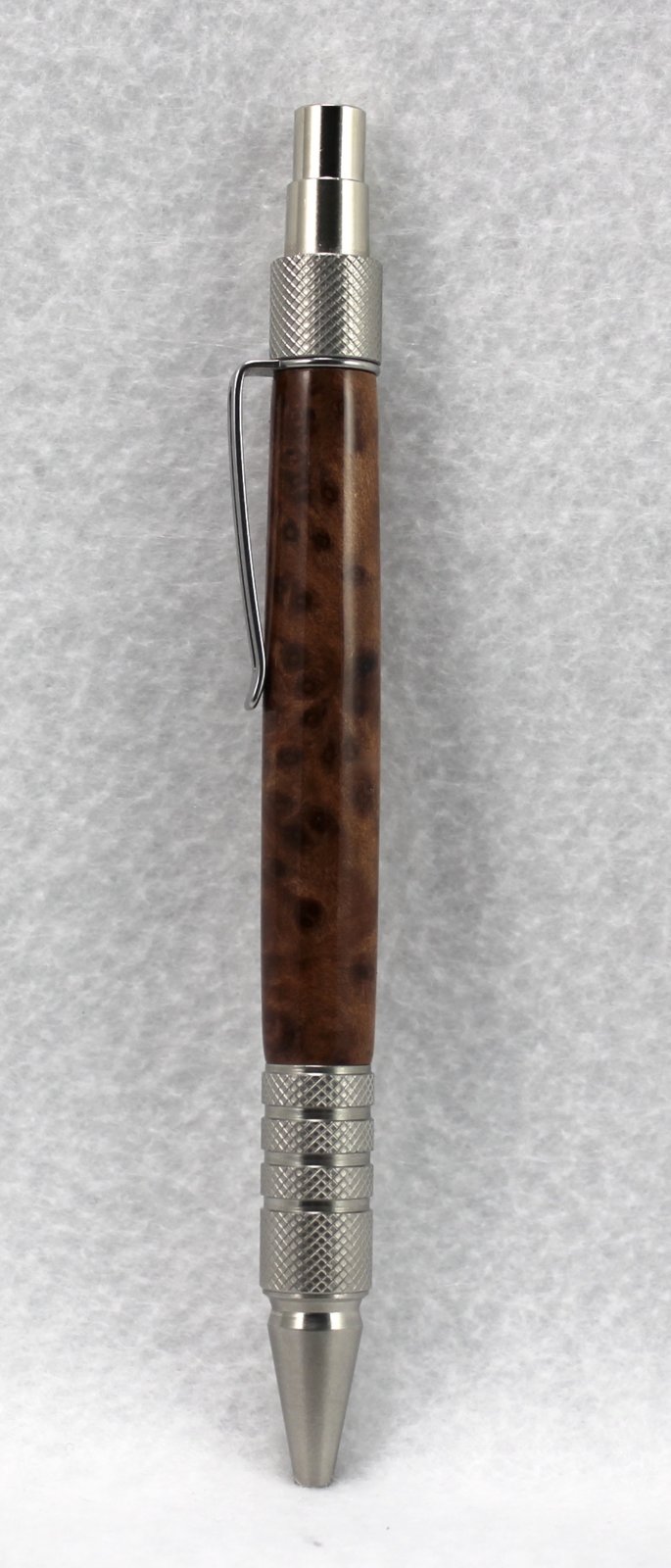

The assembly for this kit (https://www.pennstateind.com/store/PKEDCDST.html) went very smoothly.
Just a few comments:
1. The mechanism is awesome (IMO).
2. The material left on the shoulder is very substantial compared to other kits. Bushings: Tube end - .285". OD - .435"
3. A tube length of 2.769" is nice to display your blank.
4. I like the feel of the knurled parts.
5. There is a Stainless Steel version.
6. For a first trial, Glu Boost is as easy as I have read.
My wife's comment: "That's a great looking pen for scientists and engineers." I started to say, "Yea, woodworkers and mechanics and machinists also," but she had snagged the pen and was long gone.

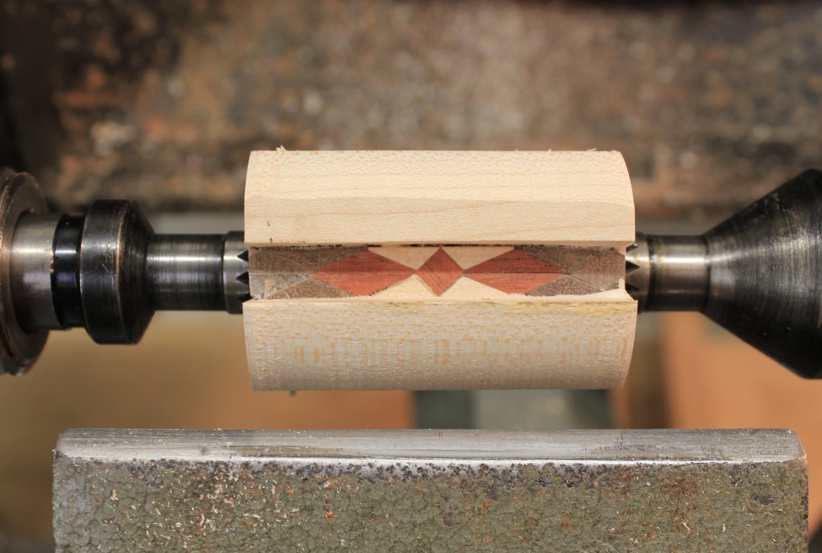

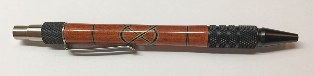

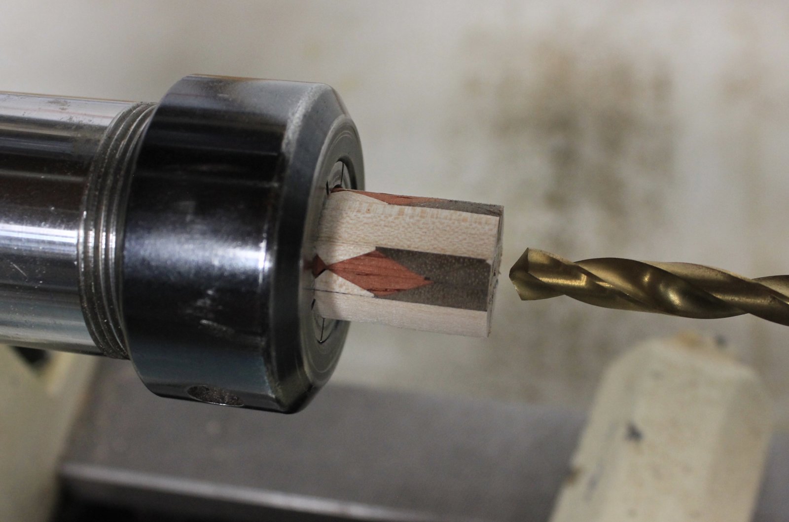

I just glued the tube in with veneers and end caps, so I'll finish turning it tonight and try Glu Boost again. If its done, I'll post in SOYP. But I will tomorrow do a longer thread with photos in Segmenting Forum as this blank was a bit trickier as I sanded some compound angles on the same pieces. This was needed to combine the squares and triangles and diamonds together.
