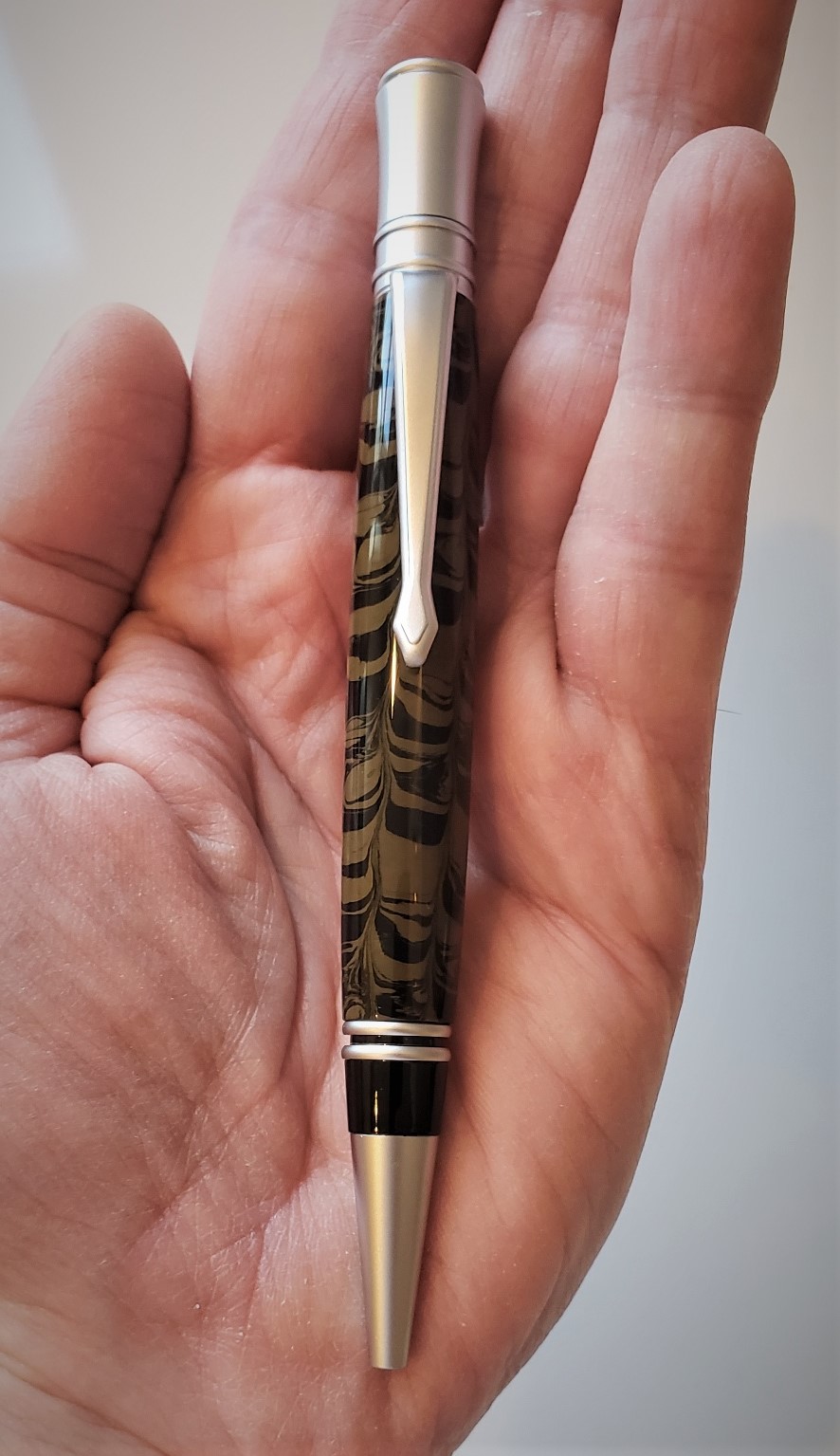

Yes. I just did. I believe it adds depth and durability to the shine. I posted it about 4 weeks ago. Let me see if a can find the link. Please note, I did finish ebonite as I do all my pens, then added 10 coats of CA. I actually started using CA on 9 of 10 of my pen (then polish and shine again). It adds 15 mines and I like the look.
I did that a few weeks ago. Fully polished, then applied CA.
