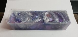

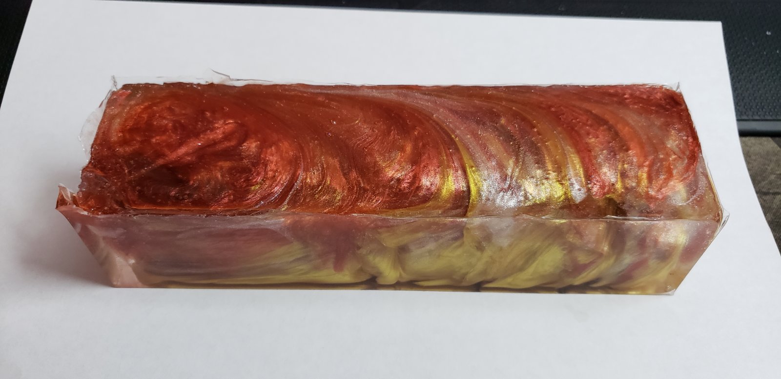

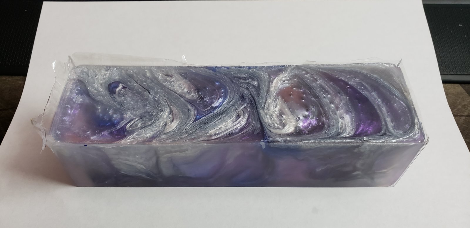

Tim, I just cast two 1.75x1.75x6 blocks yesterday using Zacs temp method. Worked fairly well but I'm still learning. I had really good separation but I may have over mixed it a bit.
This is Alumalite Clear with mica powders. I have mixed alcohol inks into resin with the micas with success.

These are destined for Christmas ornaments. My daughters picked out the colors and help me mix them.
Yes, proper safety protection was worn by all. I'm just a bit of a stickler about that.
