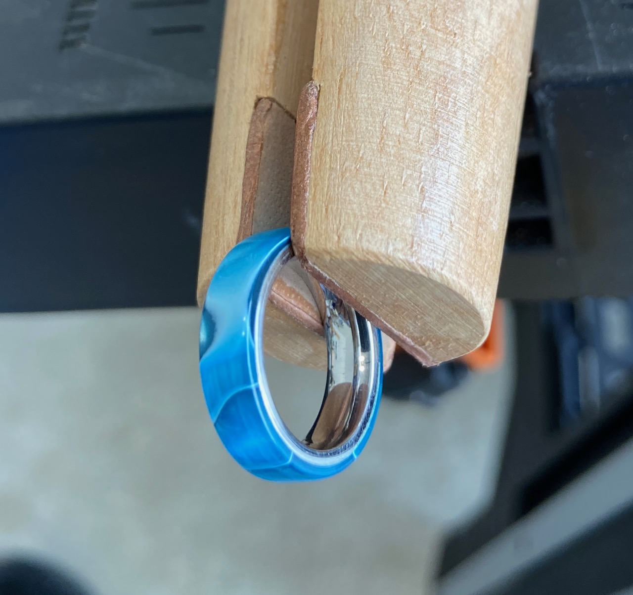

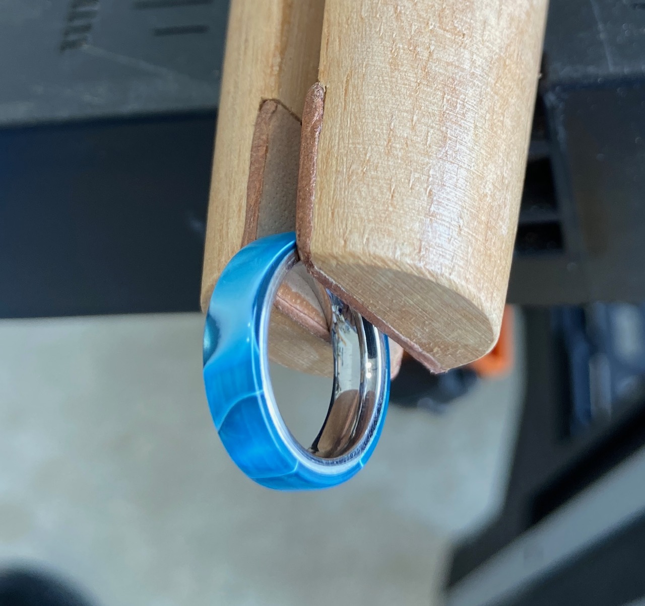

I want to color the 2 part epoxy for blanks that are slightly transparent. I did so today while gluing a ring core into an acrylic blank. I used Resin Dye. The epoxy is hardened but has a gummy surface. It should have cured. Not sure if it's the garage humidity, epoxy going bad or the dye is effecting the curing. What is the preferred way to color 2 part? What was the best type of coloring or dye material to use? Thanks, Frank

Are you sure that the colorant is suitable for your epoxy resin. I need to wait a week before I can turn my epoxyblanks. After a day in the pressurepot they are hard. But the inside needs time to harden out. It differ a lot what kind of epoxy you use. I would call/mail your supplier.

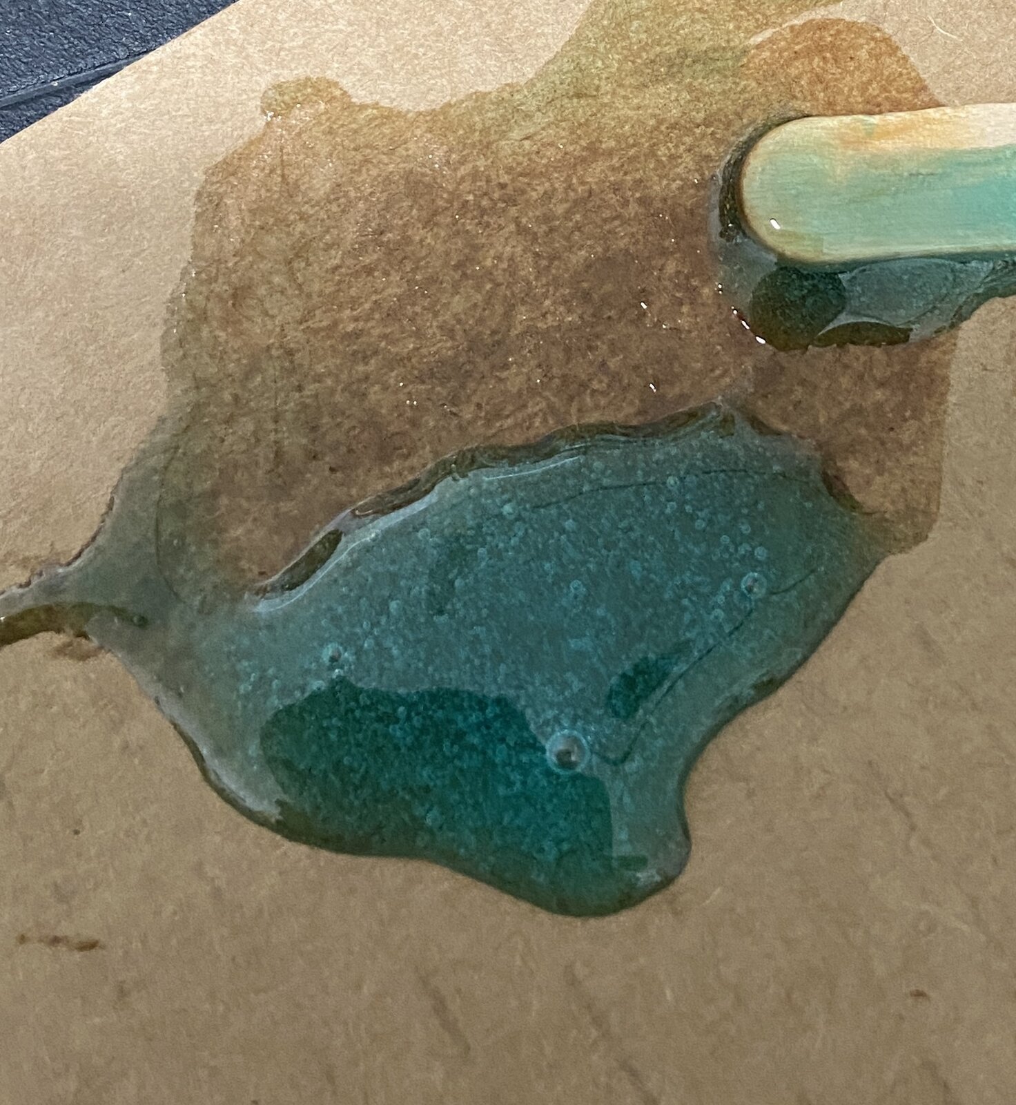

Not sure at all. I'm only gluing a blank to a ring core… or a pen blank to a brass tube. The first time I added a few drops the epoxy seemed to be watery instead of gummy. I discarded and tried again using less dye. I read acrylic paint added to epoxy will work. I might fiddle with that.
The next time I try it I'll simply let the epoxy cure on the mixing pad to see how it hardens. I'm simply trying to keep the core from shining through.

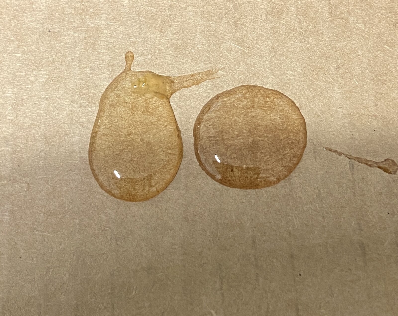

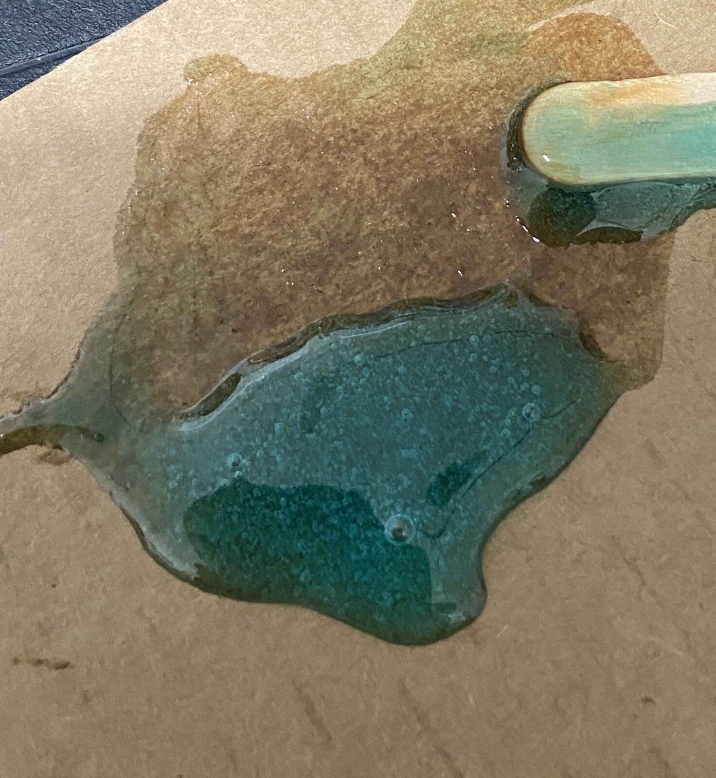

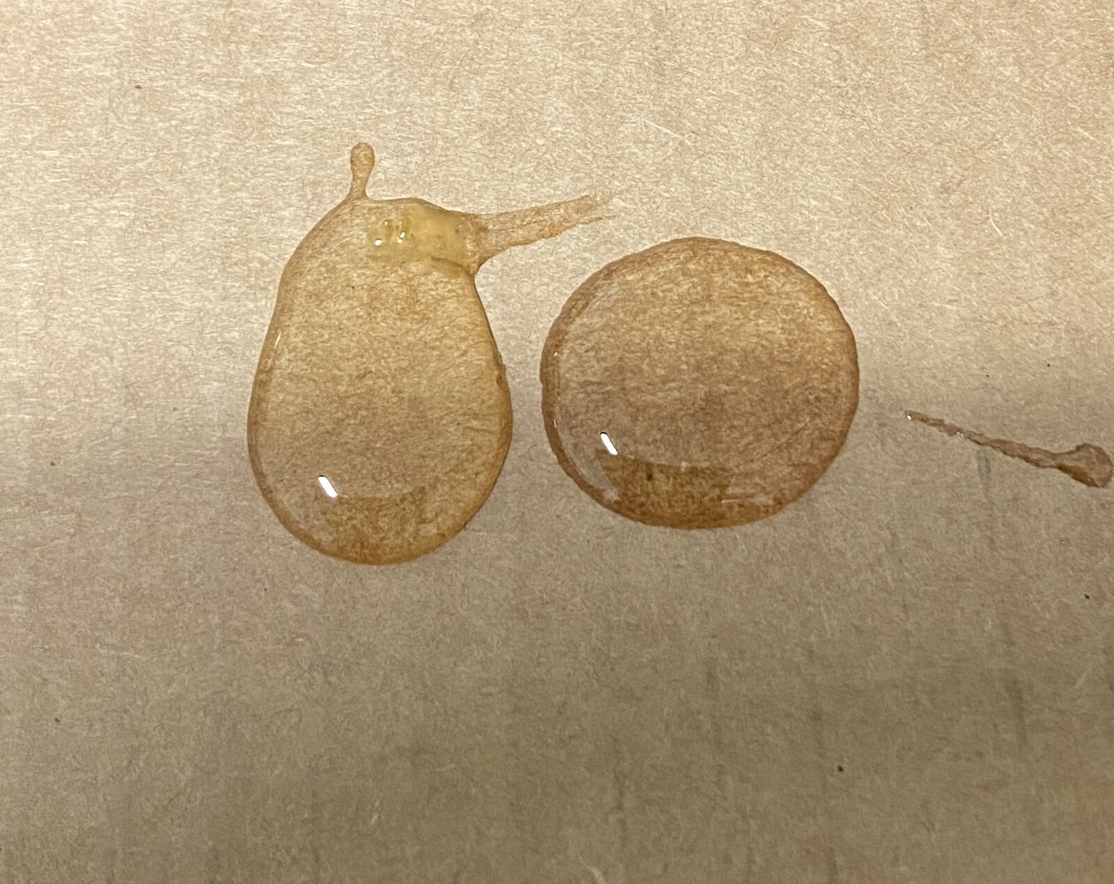

Goal… tint a small amount of 2 part before applying. Dye shown in post 1 does not work.
