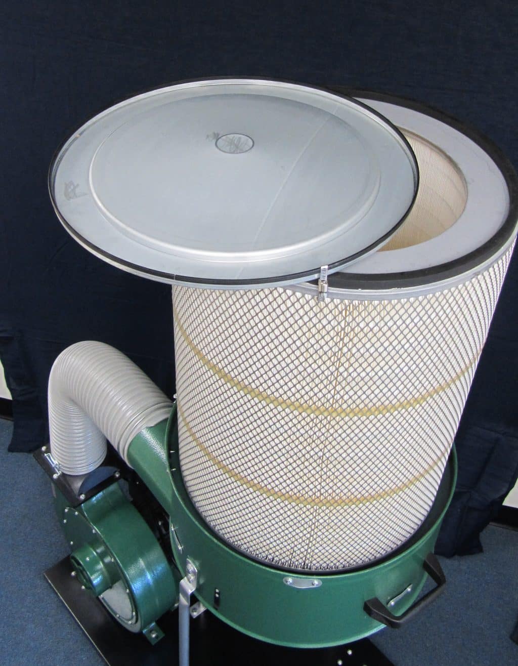

This is a real filter, not a bag. Those bag filters do not capture the smaller particulates that is really dangerous to be breathing in.
Yes, it is more expensive than the bags, but it is a lot less expensive than new lungs.

I also wound-up buying one of those large canister things that that sit on top of my dust collector. And, like all say, it was almost as much as the dust collector. I tried the smaller micron bags and I guess it helped but not as much as the canister thing. Mine has a large handle on top that allows you to keep the dust from "sticking" to the filter media. I also run a Jet airfilter. I don't know of anything that is any less expensive. Great question.

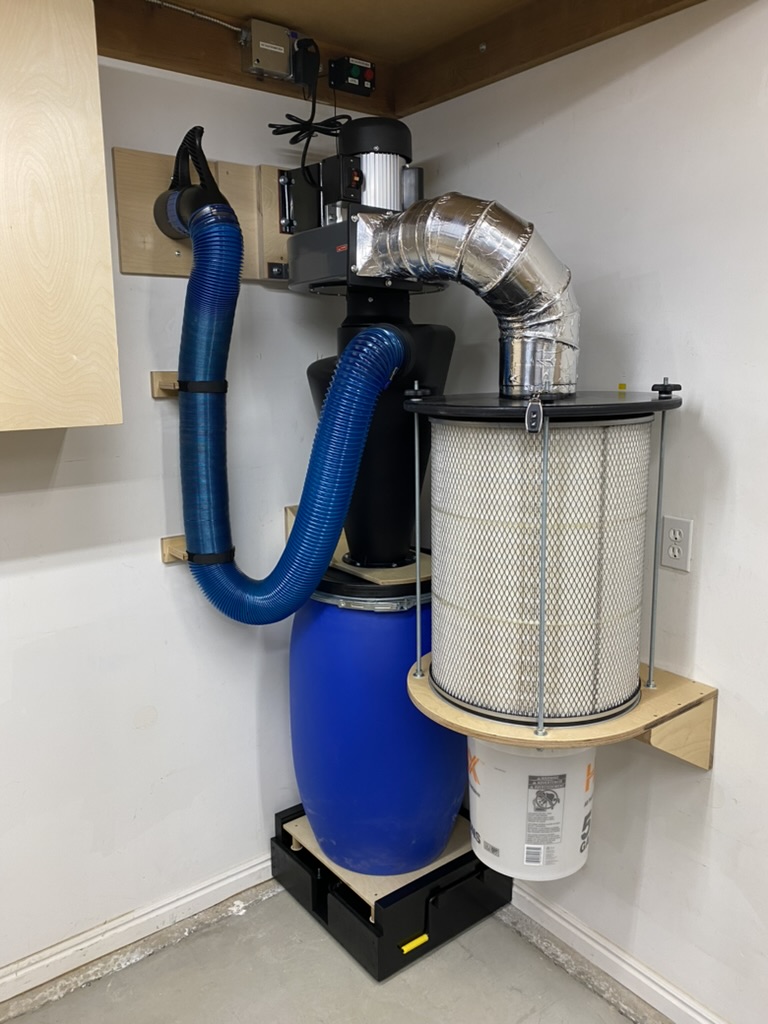

I am using the blower from the Harbor Freight Dust Collector, but that is all. I have the Oneida Super Dust Deputy, and the Wynn Environmental Merv13 Filter Canister I linked to above. I have also upgraded the impeller on the fan to the full size Rikon impeller. All really good mods.
I have a DD but CSR at Grizzly said it would cut down on suction. DD is sitting in the basement gathering dust.
Everything between the inlet of the impeller on the blower and the point where you are drawing in the debris from your work increases the resistance to airflow and therefore reduces the airflow and suction. The issue is not reducing it so much that the system becomes ineffective.
I can tell you that my system, the HF 2HP Blower, Oneida Super Dust Deputy, Wynn Env Merrv13 Canister Filter is quite effective. Upgrading to the full size Rikon impeller made it even better. The Super Dust Deputy is mounted on top of a 30 gallon plastic drum. 98%+ of the material sucked in is pulled out and dropped into that drum by the Super Dust Deputy. I can't imagine all that stuff getting into my Merv13 Canister filter.
Here is a picture of my Franken Dust Collector...

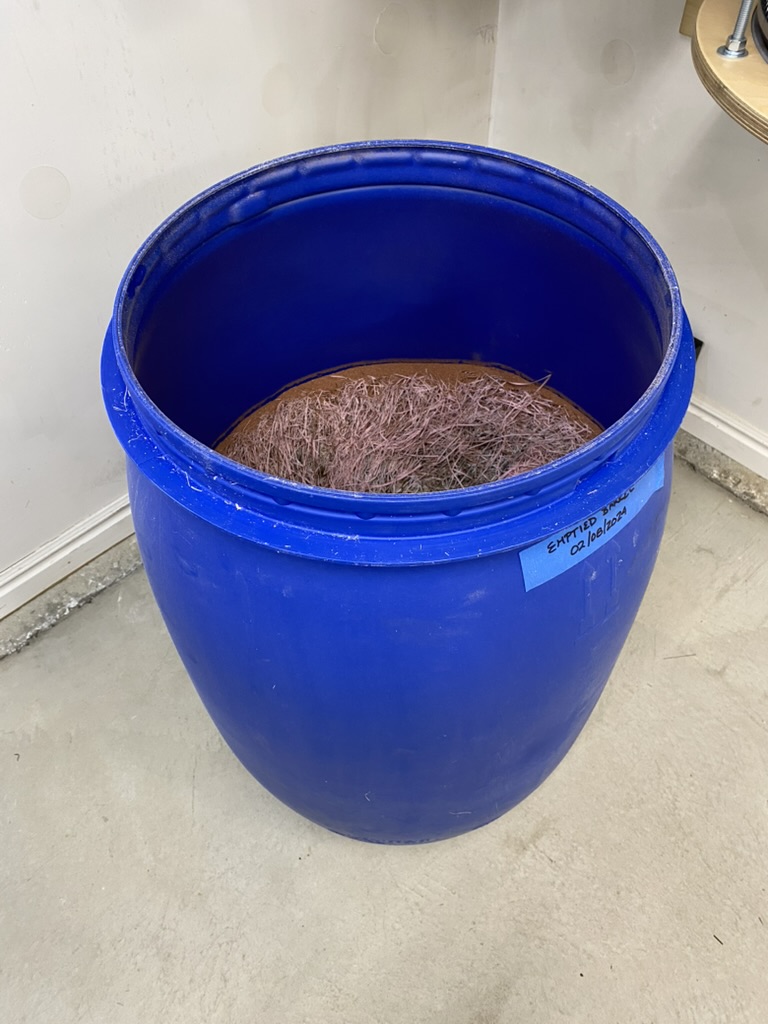

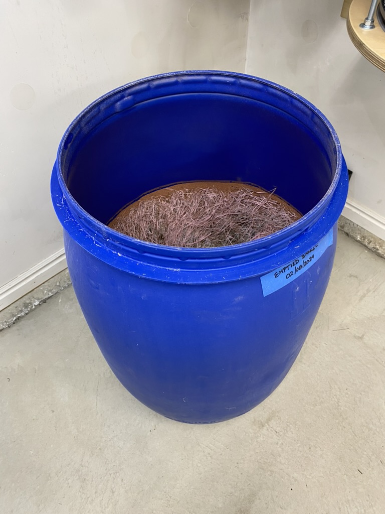

Here is a picture of the debris that the Super Dust Deputy saves from getting into my Merv13 Canister.
The debris is 20" deep in there.
