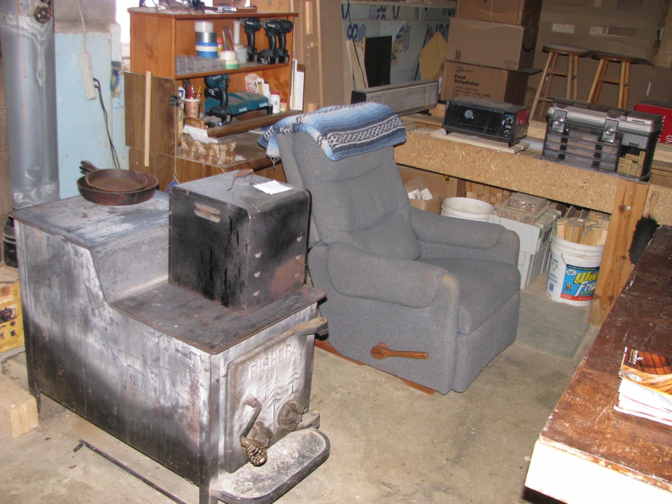

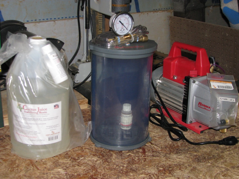

Putting together "The Lab" for my mad scientist experiments

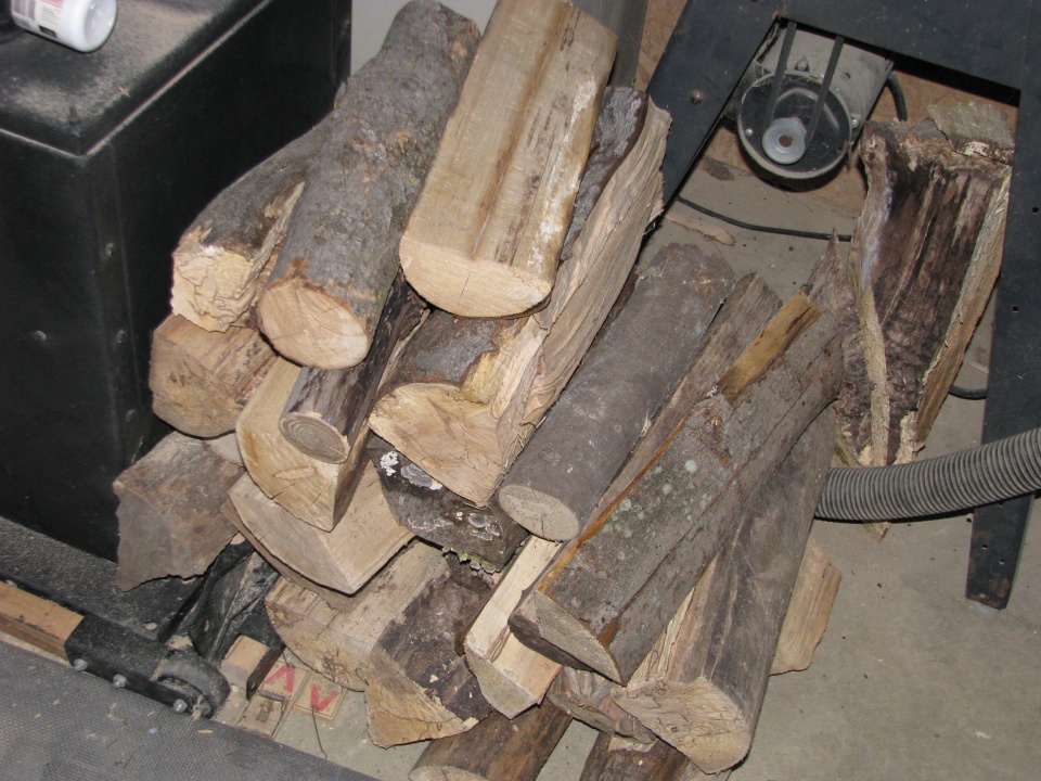

This is where things are at the moment. Not quite there... Still need to marry the pump to the chamber. With a pile of wood to go though for good spalt markings and a Lazy Boy it's going to be a difficult decision on what to do next... ;-)

Already I think I could use some help... This is for those who have already done this or are familiar with hooking up the CJ vacuum container lid to a Robinair pump (see photo above). I assume some sort of NPT brass coupler but I am not familiar with thread sizes and all that. Do I just need a 1/2" female - 3/8" female NPT coupler or something else? Thanks in advance! (and I'll send a freebie blank to you as a thank you). Having a great day yet? Me Too!
Send me an e-mail to curtis at turntex.com with your shipping info and an adapter will go out in the mail today. I have the required fittings but at the time of the initial order with CSUSA of my chambers we were trying to keep the cost at a certain point. I am now buying the adapters in MUCH larger quantities and getting better pricing so I am including them on all future chambers.
And no, it takes a special adapter to to do it right. You will not find the adapter locally, that is almost certain. It is a 1/4" 45° female SAE flare to 1/4" NPT male adapter that you need. I only know of 2 sources

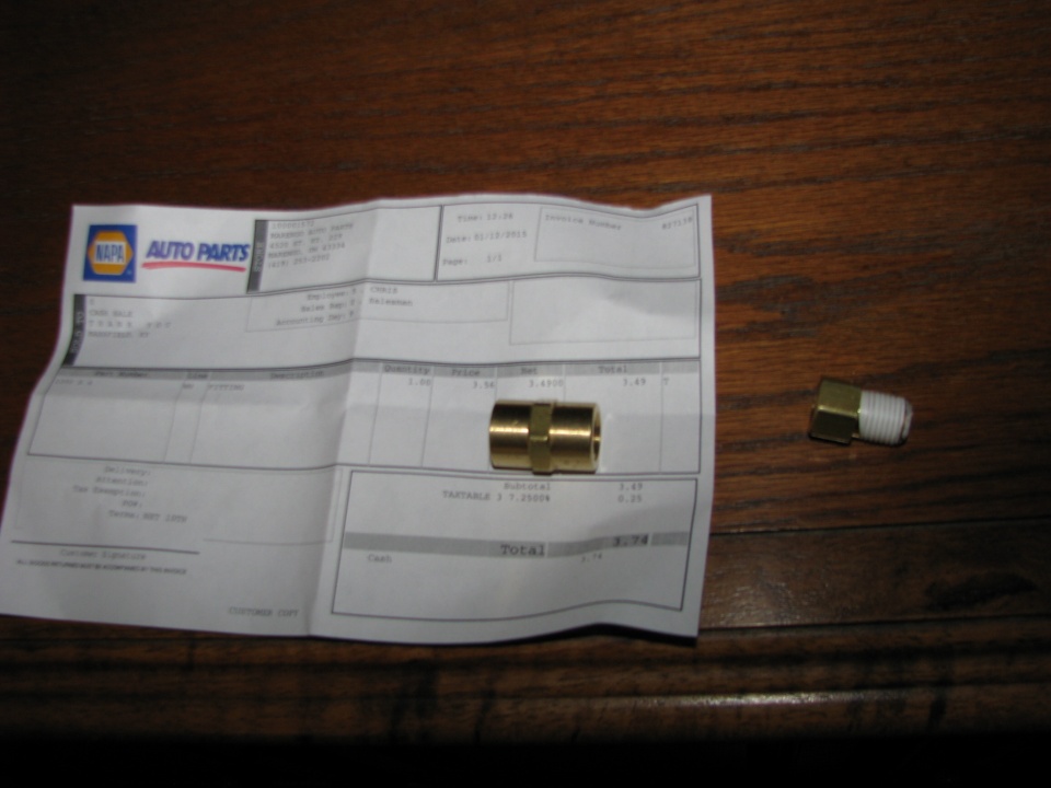

Still a no-go with the newly provided adapter. The adapter I received is a male to female reducer and in order to use this I will need a coupler to fix. Remember, I'm flying by the seat of my pants here with no illustrations on the placement. So, it looks like I will be off to the hardware store for a female to female coupler to get it going. Definitely some room for improvement for a seamless setup but I'm sure it's a work-in-progress that will be resolved. It just adds a dimension to the challenge especially when you're disabled.
That was it! The coupler from NAPA did the trick. I will probably want to get a more appropriate NPT fitting arrangement. For starters, the pump will require more counter space unless I am able to attach to hose to run parallel to the pump motor body.

As for the adapter and it not working...we should have included a female hose barb with it but did not think to. The way you received your chamber is the way CSUSA choose to purchase at the time. We have since changed the spec now include the adapter already assembled to the hose and ready to simply screw on to the pump. Personally, I would return the female/female adapter to NAPA and buy an air hose quick connect and plug with female connectors on each end. Then attach the male plug to the pump fitting and the female quick connect to the hose and you will be able to easily disconnect the chamber from the pump. This is backwards of how an air hose connection woudl be made so keep that in mind. Also, remember, this was an attempt at good customer service and the part was provided at no cost even though the chamber was not purchased from me.
