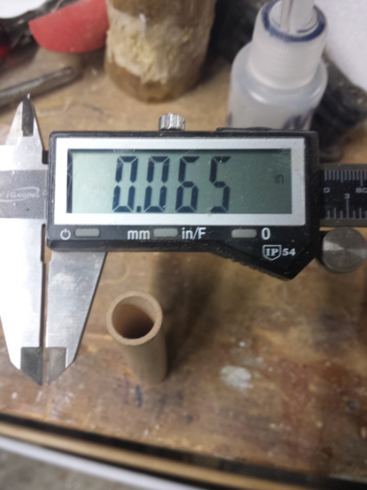

Assuming that the lathe and associated accessories are within tolerance, problems with holes are usually due to bad drill bits. Personally, I've used several different PSI bits and hate them all. I've tried Fisch brad points with mostly good luck - except for a 10mm bit.
When I found the Colt Pen Drill Bits, I never looked back They are excellent pits and I've never had any problems with them. Yes, they cost more, but it's cheaper than continuing to ruin pen blanks.
Regarding accuracy and stringent tolerances... I like to make pens from drum sticks. The problem with these is that the hold has to be perfectly centered since you're not turning down the blank. Colt bits are the only ones that I've found that will reliably do this over and over again.
