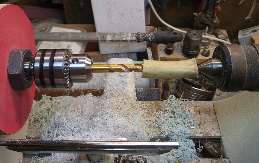

Items in inventory:
MT2:
- Rikon 70-220VSR from Lee Valley (Set to 615-620 RPM for this task)
- Jacob's Chuck (Lee Valley Tools) (Tail Stock)
- 3/8" Drill Bit HSS (PSI) (Tail Stock)
- Baracuda2 4 Jaw Chuck (PeachTree in GA) (Head Stock)
- PSI C Series Pen Jaws for the Bolt Action Pen Kits (PSI) (Head Stock)
View in Gallery

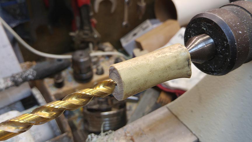

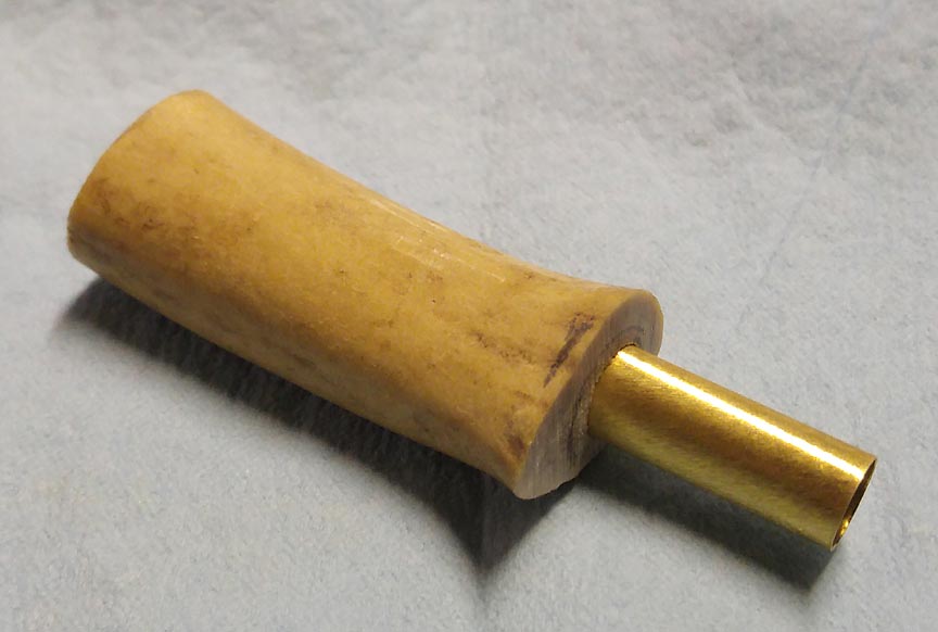

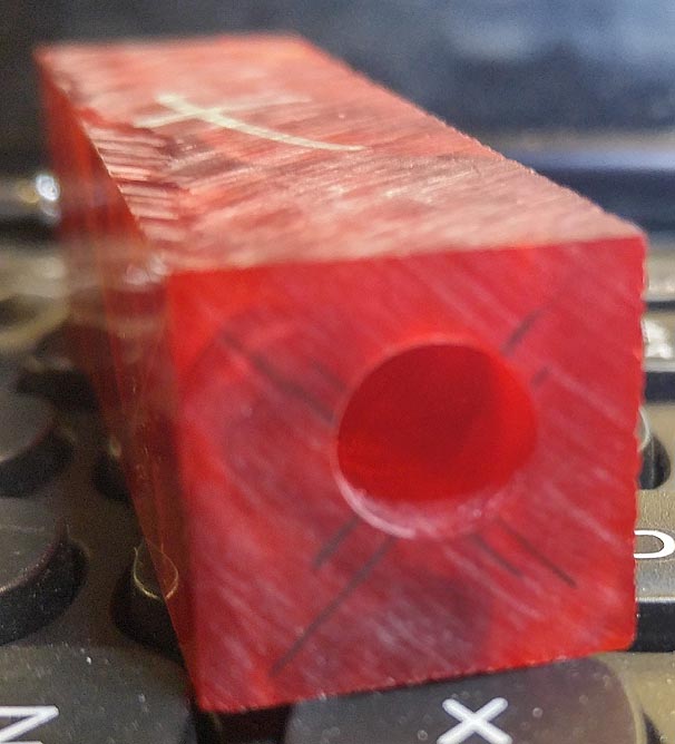

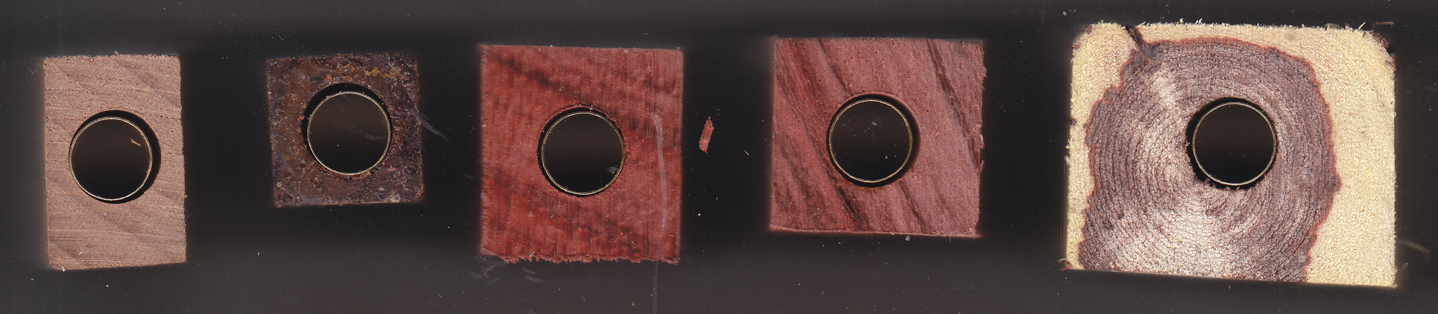

Now these tubes are not glued in the blanks yet. They are just sitting inside the blanks.
I need your honest opinion on the air gap between the tubes and the blanks.
These were drilled using the above configuration.
On one of the blanks above, I used a 23/64" bit, but the hole was too small for the brass tube to enter into the hole! So I ended up chasing a 3/8" bit through the hole. These 3/8" holes for the Bolt Action Pen Kit (PSI), just seems to be way too large or oversized holes drilled in the blanks.
It is my own opinion that it may seem that there must be some sort of wobble making the holes slightly larger than they should be. Now, I could be very wrong, and these may be drilled right down the keister! (You know... Zero Tolerance).
You spend this kind of money, and you expect that there should be NO AIR GAP down the centreline! (Am I just too much of a perfectionist?). The PSI Pen Jaws Instruction Sheet was followed to the Tee.
Please share your thoughts, observations, ideas, comments or even rants! Remember now, these blanks are not glued in.

Ok from the photo what we are seeing is over drilled holes. The drill bit is to large. What info is needed is this. What is the diameter of the brass tube?
The 'step up' you have may not be the next size up buy the 4th or 5th size up.
However,
You mentioned "bolt action" (I missed this on my other post) This kit has some thickness to it so it's not wasted. What you need is something that will FILL the void. Some very thick build up epoxy such as bedding compound. Something design to fill the large voids and offer protection and full support.
I would suggest acraglas epoxy.
Edstreet, best info to date! Thanks. Sorry for the delay. My digital calliper was misplaced.
OK, OD of PSI #PKCP3000TU = 0.365"
White Oak ID = Drill Entry 0.41", Exit 0.39" (Head Stock Side)
Cocobolo ID = Drill Entry 0.407", Exit 0.391"
Padauk ID = Drill Entry 0.402", Exit 0.39"
Padauk ID = Drill Entry 0.4005", Exit 0.366"
Caragana ID = Drill Entry 0.408", Exit 0.395"
Any further info needed? Please ask & I'll do my best to supply.

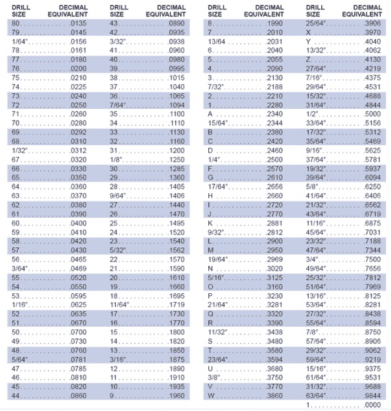

Try a 'U' bit.
attachment.php
your tube is 0.365" The next 'size up' is 'U' (0.368"), larger than that is your 3/8" (0.375")
Also if you want to reduce your slop factor then reduce the feed pressure. Step drilling may also help to. The entry/exit is not bad and no real cause for alarm in this case.

Based on what I see here I would say that your headstock and tailstock are not inline with each other, ie. the center lines are not the same. Even if they appear to lineup using pointed centers one could be turned slightly. A slightly turned headstock would give you a nice round but bigger hole then the drill bit being used plus you may not see any wobble. Does the headstock on your Rickon swivel? If so I would double check that it is on centerline of the lathe and that the spindle is parallel to the lathe center line. A slightly rotated tailstock could create the same problem but it is less likely unless it is very loose between the ways.

Here is my thoughts....
1) your Drill bit should be .375 (3/8), which is a good match for the .365 that the kit tube is.
2) with the weird exception of #4 (typo? because its smaller than the bit???) Your numbers are relatively consistant so whatever your problem is its reproducable - thats good.
So... I'd be curious - Use the bit to drill through something thinner like a 1/4" thick piece of scrap (so the bit can't be off or wander)... Is that hole closer to .375?
If thats more as expected, then either something is off in your setup or your bit isn't sharp enough. I highly recommend a drill doctor - it makes a HUGE improvement on drilling - even some brand new bits aren't very sharp.
If its setup, there could be a couple things.. for example, if the bit is parallel to the centerline but not on centerline - it wouldn't take much to make a bigger hole than expected. Check tailstock to headstock lineup (with points in each).. Then check headstock to drill bit alignment if the previous lines up. That will get you the first couple of possible issues.
The only thing that I personally wouldn't recommend is just blindly changing to a different drill bit size. If you do and the root problem is a setup issue, you'll have to test and pick different size bits than the recommended for every kit you try!
Good luck - Let us know what you find.

You used a 23/64" = 0.359" bit and the hole was too small. That bit, was it from a reliable set of bits ? Try the 3/8" bit from the same set.
I would never trust a bit that you got from .... ( you know, that place you got it )
John's suggestion that you try a "U" bit is good, but you may not have one and living where you do you can't just dash out and buy one. I use a "U" bit all the time when I am working with the Bolt Action tubes and others the same size but I do mostly acrylics.
With wood, you may find the "U" gives you too small a hole, because the wood expands a little with the bit inside it and then contracts when the bit comes out.
I honestly don't think there is anything wrong with your lathe setup because, apart from being too big the holes look well-formed.

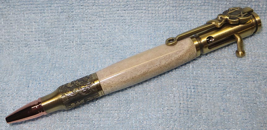

Oh, and my main focus on the Bolt Action Pens from PSI is Antler, NOT wood. I'm just working out my centre / wobble issues before I waste my stock of Deer, Elk, Moose & Prong Horns!

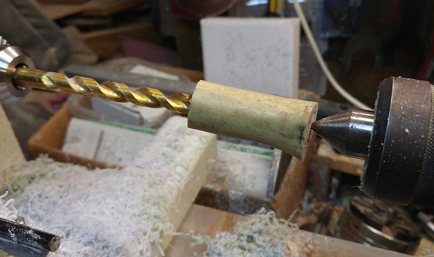

A "proper good" 3/8" drill bit should do a good job for you.
I think the drill bit that you used might be bent. Try rolling it on the kitchen counter.
When you start cutting with the drill bit - observe and see if the bit seems to be cutting on both sides, or if it's out of line and only cutting on one side, making a bigger hole. As monophoto alluded to, if it is out of line, this can happen.

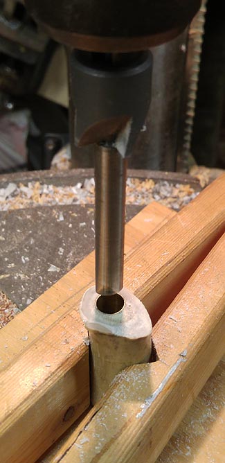

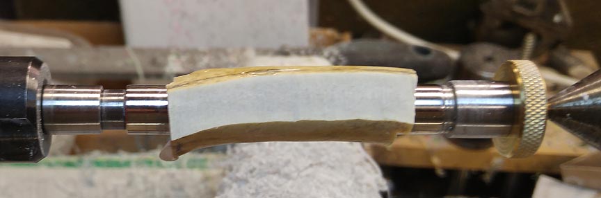

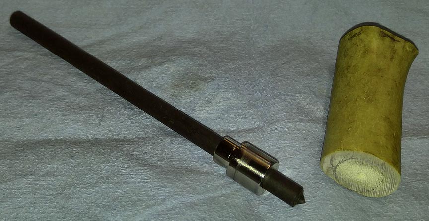

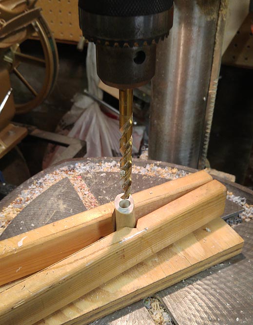

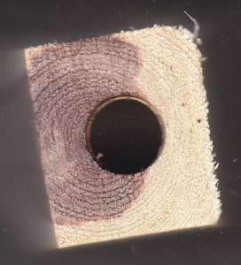

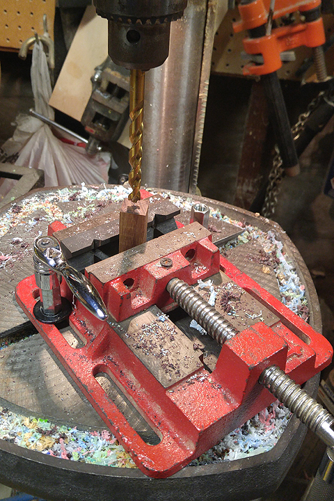

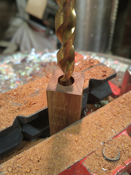

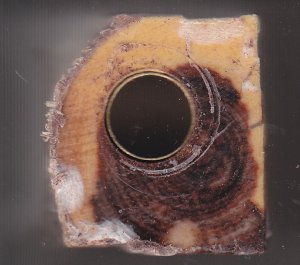

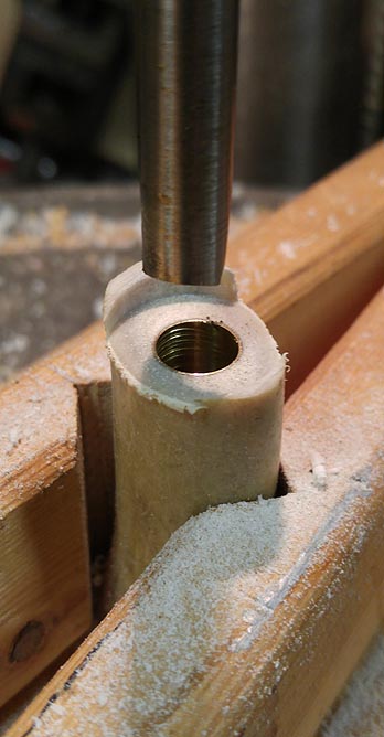

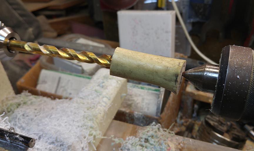

I can't comment on your particular issues, since I don't drill blanks that way. I drill square and round blanks with my drill press, in a vise with a prismatic jaw. They don't always drill straight through, but at least the holes are completely round and not oversize. For the first antler pen I did, I used a different method. Since the antler is odd shaped on the outside, I needed a way to drill through the thickest part. I used the method in this video:
https://www.youtube.com/watch?v=SAEEaF8z2jM
It worked out very well. I marked the ends where I wanted to drill with a transfer punch through one of the bushings. I drilled it most of the way through on the lathe, then finished the hole on the drill press. I used a DeWalt bullet point 3/8" drill bit.

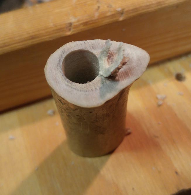

This is what I first noted as I brought the bit ever so close to the wood. The cutter closest to me (horizontal by my belly button), hit the wood first!
Hence the idea of posting this online to see if this could have been my issue (without me mentioning this situation) - Root of my problem. So this now seems to be the case.
Thanks for bringing this to light.
QQuake, Thanks Jim for sharing! Yes, I've watched your video a few times before, and I want to experiment with a few of my antlers on this technique. It looks simple and effective.

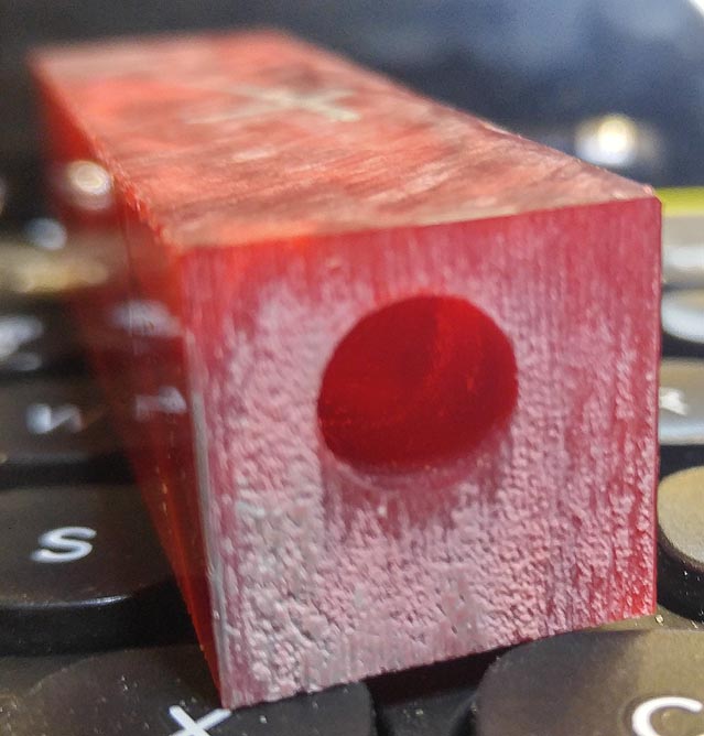

Are you noticing these elongated entry hole issues? or are you pretty square on?
This is the one and only blank of any sort I've drilled this way. Yes, the entry and exit holes were spot on. They're spot on in other blanks I drill on the drill press, too. But like I said, sometimes it doesn't drill completely straight. I haven't figured out why.

Ya, I do agree too. The 4th one, the second Padauk exited one way at 0.366" I'll re-check that number... Wow I just opened a can of worms here!
0.375" one way and turn it 90 deg, and I get a value of 0.3.65 - But on the other end I get 0.400 & 90 deg = 0.402! Go figure that mess out now!
I'll measure the bit and the point 2 point in the morning.
View in Gallery

Didn't read the entire thread, so someone may have come up with this solution already...
I think the issue is either mis-alignment or a bent drill bit. A bent bit is the easiest one to check for .... go to a flat surface ... a countertop or desktop, perhaps a table, and ROLL the suspect bit across the surface. If it rolls unevenly, or you can see a wobble in the tip as it rolls, it's bent and will give you an oversized hole.
Mis-alignment is generally easy to check for. Take your tailstock with a 60 degree cone center and put a cone center in the headstock as well. Bring your tailstock up and lock it down. Make sure that it lines up with your headstock center perfectly, with NO deflection in any direction, up, down, left, right... it needs to be perfect if you plan to drill on the lathe.
Mis-alignment can also occur further down the lathe ways ... to check for that, you'll want an alignment bar and a dial gauge, but for woodworking purposes you can usually skip this if your centers are aligned.
Beyond that, make ABSOLUTELY SURE your morse tapers are clean and free of all debris .... don't put anything in there other than a morse taper. No oil, nothing. If anything gets in there and is stuck, it will throw off the seating of your tool and will result in boring oversized holes. Look in there with a good strong flashlight ... clean it with a brass shotgun cleaning brush or something else that won't scratch up the inside of the taper. Also make sure the outside of the taper rod is clean.
Make sure that when you install the drill chuck for the drilling operation that the very center of the drill chuck is also on center with the headstock of the lathe .... chuck a small drill bit in the drill chuck and bring the point of the bit right up to the spur center in your headstock. If the drill chuck is bent, it's worse than a bent bit.
Make sure that the chuck jaws hold your workpiece securely so that there is no wobble in it at all. If you have to, shim (with small slips of brass shim stock) between the chuck jaws and the chuck body to achieve a uniform and perfectly square grip on your stock. Set it once, and you'll never have to worry again when drilling perfectly squared stock. Anything else, and you will want to turn it round between centers before putting it in your pen jaws to drill. If it's a perfect straight cylinder, it will work in your pen jaws with no problem.
That's it ... that's all I can offer you for ways to check for the problem... Good Luck!
Here's my 2¢. Did you use a Brad point bit? Those tend to wander for me on occasion and I get exactly that. The entry hole is slightly larger. Also, swarth can enlarge a hole as well if not cleaned out. Not always, but it can.
When this happens on wood pieces I have coated the inside of the hole with thin CA and then come back with either gorilla glue or thick CA to fill the gap. The thin ca will help harden the inside of the wood if you have a soft wood. Chase it with the drill bit by hand to knock down any high spots tgat could hang up the tube. Don't use a lot of moisture when using gorilla glue on wood as the wood will expand slightly and then contract when it dries out again. If you use CA as a finish, that wood movement can crack your CA finish.

Possibly a bent bit (It happened to me). Even a slight bend can make a difference in hole size and you can't see it wobble. Have you measured the tube diameters to see if they are spot on? Should be since the holes are different sizes on the ends.
Jim, I have a Pen Vice too. Purchased from Woodcraft in Florida. What I don't like about that one is that there is a very slim, 1/32" gap at the bottom of the clamp (actually its the thickness of a credit card!) where, once you apply pressure from the drill press onto the blank, the blank sinks that 1/32", and you end up with an out of round blank! Poor design flaw not seen.
Buy Pen Makers' Center Drilling Vise at Woodcraft.com
Pissed me off enough that I duplicated my MT1 setup to a MT2 upgrade.

Here is what the cheap set does:
Entry Side 3/8"
Exit Side 3/8"
I'm impressed with this set - Of course they have no longevity, no problems here. We're just looking on figuring out what went wrong here.
I think I have my answer tonight.
The PSI 3/8" HHS bits we purchased are too SOFT! I saw them wobble like crazy. These Chinese Titanium Coated Bits went in real nice (nice and fresh bits too, I understand). I just need them to drill through 15 Antlers, so I have a chance on making a purchase towards Norseman bits!
