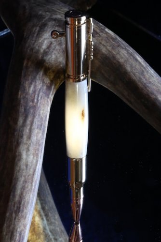

I'm new to pen making. I'm sure this idea is here somewhere, but I have not seen it. I made a jig from scrap 1/2 " plywood and a 1/8" bolt. I clamped the plywood to the table on the drill press so that the tip of the drill bit hits the center of the bolt.
I then marked both ends of the blank where I wanted the drill bit to enter and exit the blank. The deer antler was slightly curved and laid out the hole so that it would leave a island of bark after the blank was turned.
I then drilled a 1/8" hole in the marked ends of the deer antler.
Place one of the drill ends over the bolt in the plywood. Lower the drill bit until it is centered on the top hole of the blank.
Clamp the antler, then use another clamp to hold the clamp to the drill press table and plywood. I used a total of 4 clamps.
Of course this technique can be used on any type of blank.
This is my first deer antler pen.
I have pictures of the jig and the finished pen. I can't figure out how to embed them in this message. I'll put them in my photo album.
