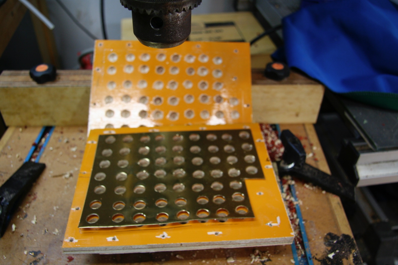

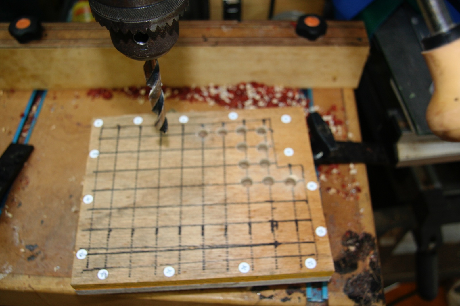

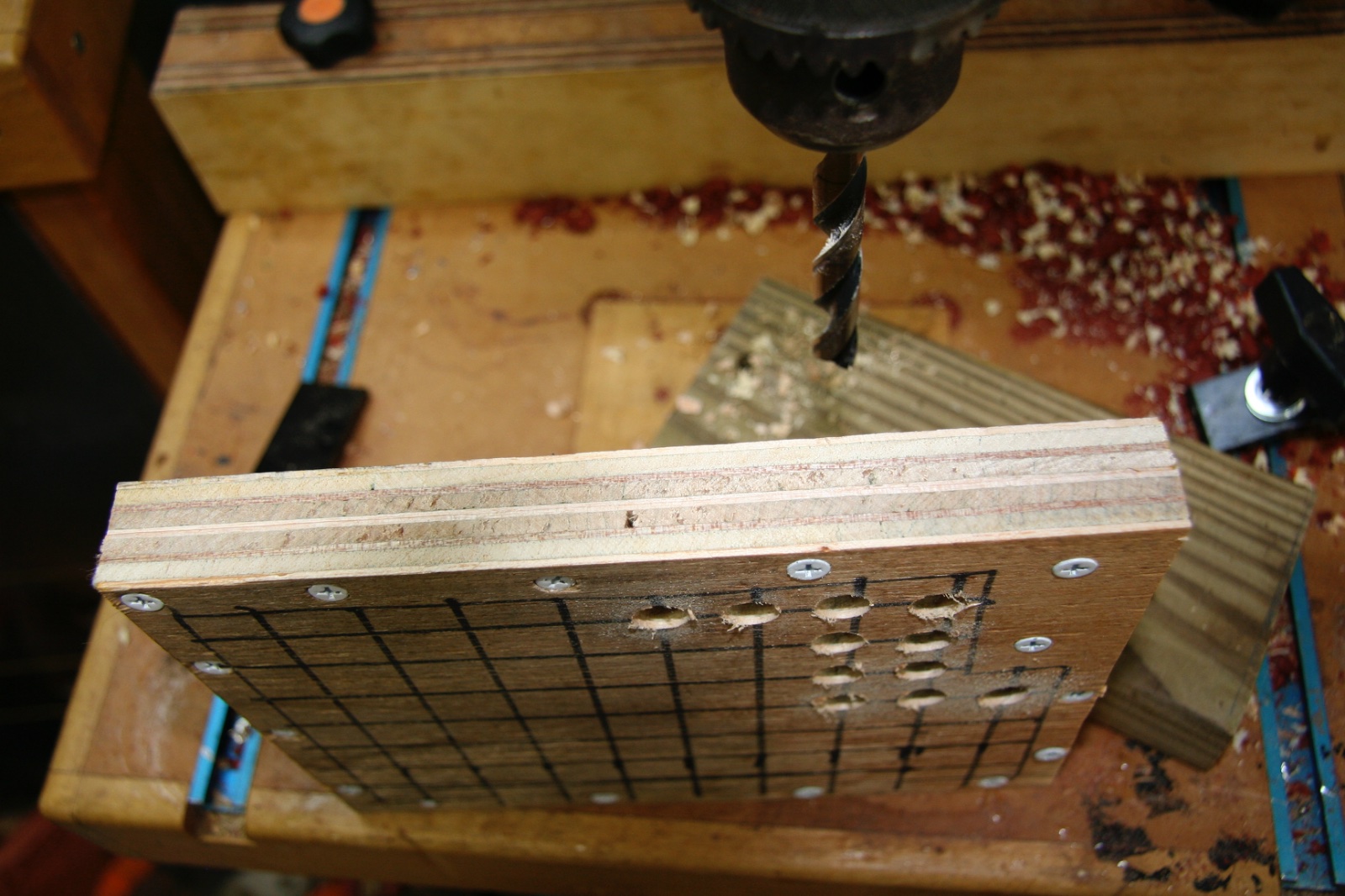

in brief, I basically laminate a sheet of brass or aluminum between two half inch (at least) thick pieces of quality plywood (screwed together well), mark my drill holes, then drill. Unscrew the two sheets of plywood. Cutting the segment pieces out with tin shears will distort them, but a hammer and a small anvil will flatten them. My brass segment holes are round; yours will be oblong if you drill them at an angle.
the pict below is the grid that I played out a piece of brass.
This picture shows two sheets of plywood screwed together with the brass sheet in between (which cannot be seen). The purpose of placing the brass (aluminum) between two sheets of plywood is to keep the bit from twisting the thin brass or aluminum as it drills.

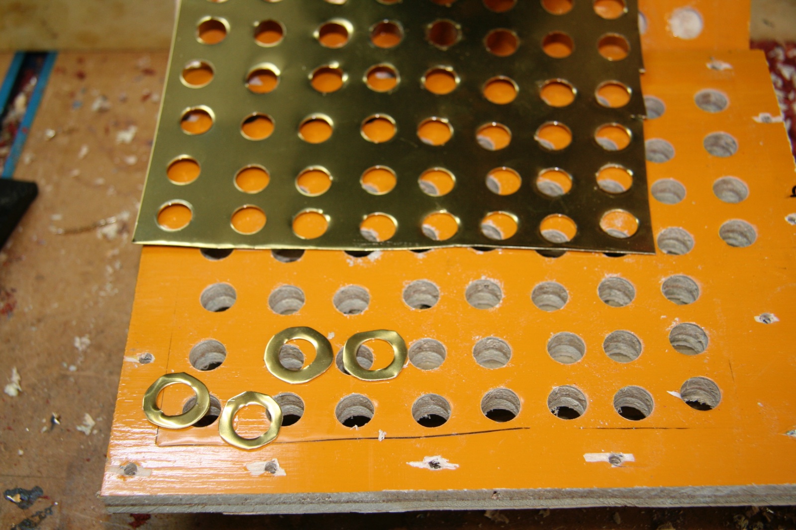

This is what it looks like after taking the two layers of plywood apart:

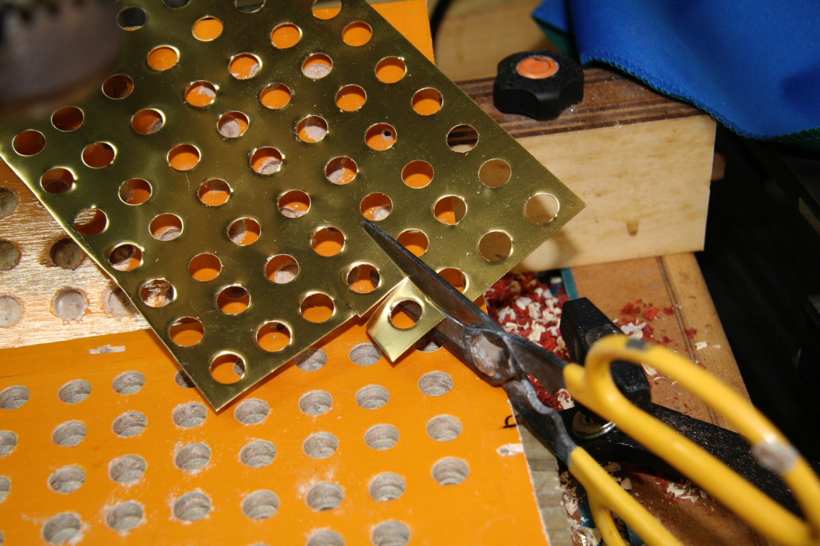

Next I cut semi-round circles around the holes. Of course they will twist and distort.

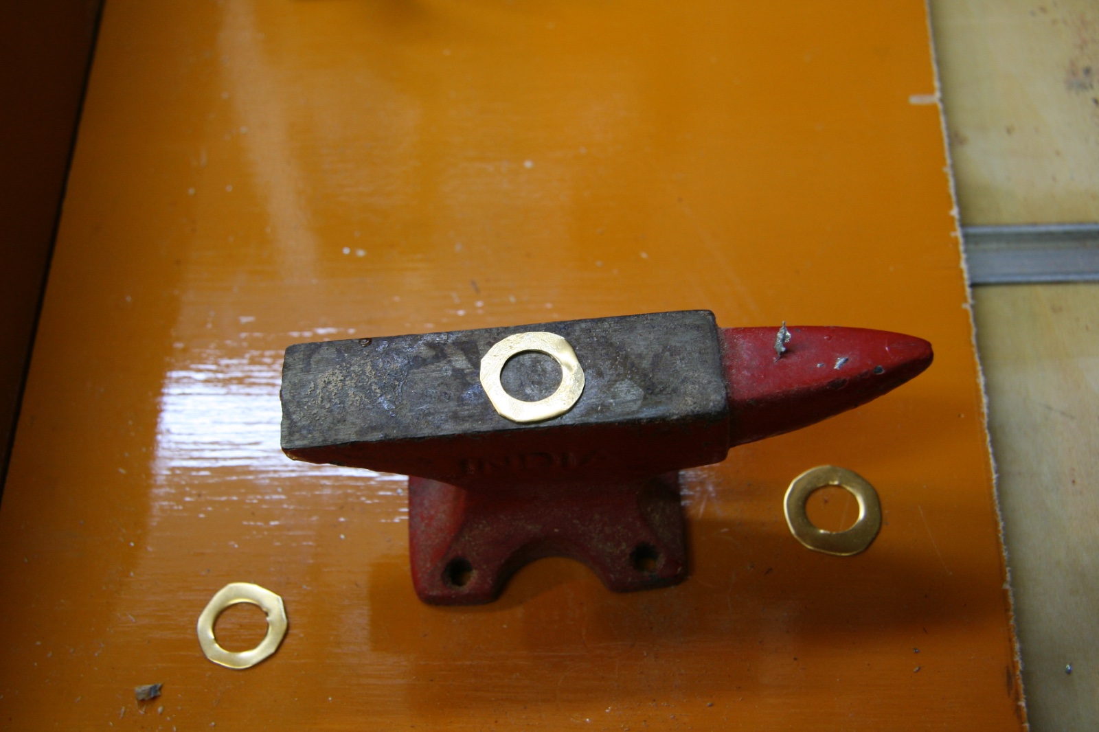

This is what a generalized circle of brass will look like, but not flat:
I flatten the circles with a hammer on an anvil or flat piece of thick steel: For me, it is ready to be used in a segment: I do a bunch at a time, because it is not worth it to go to that trouble for just enough for one pen at a time.
I am not sure if this helps for what you need or not, but it is the way I do it for 90° drilling. WHILE these are not perfectly round, they do well enough that I can turn them in the blank very gently without them heating up too much that would cause the glue/adhesive from detaching from the blank as it was turned to round. It did not hurt my turning tools of choice but I did keep them sharp.
