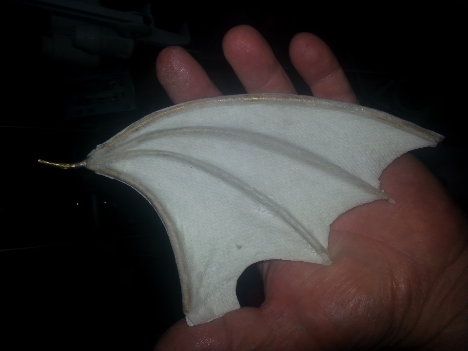

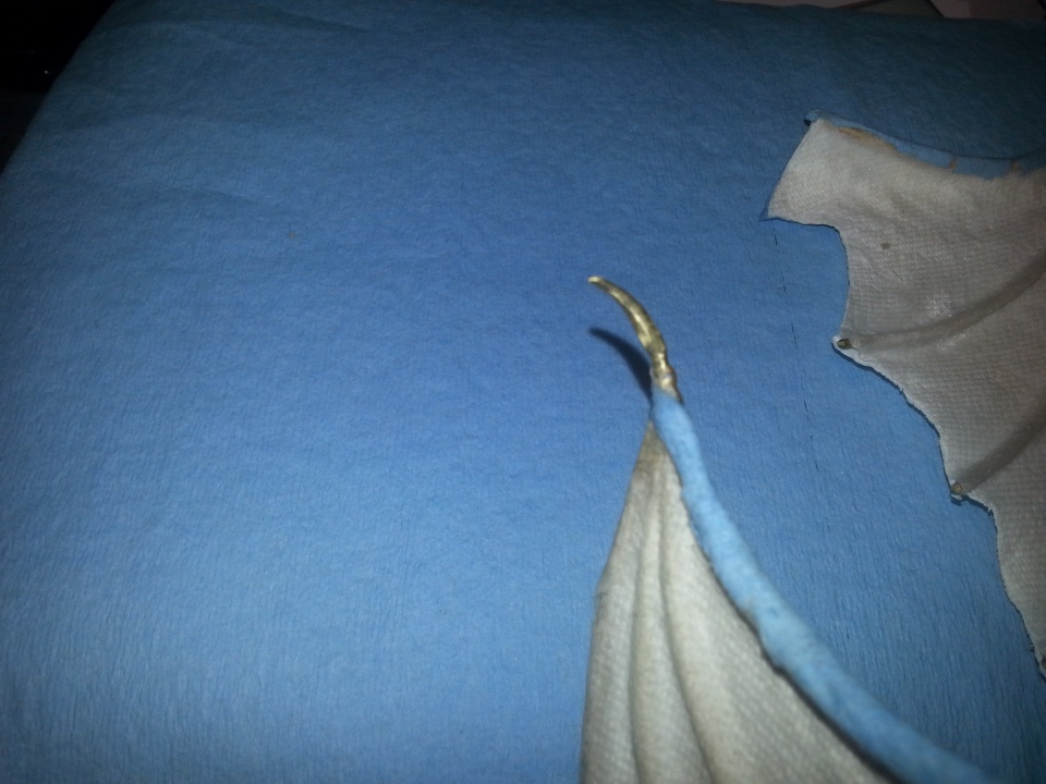

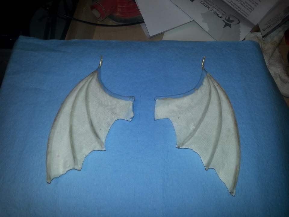

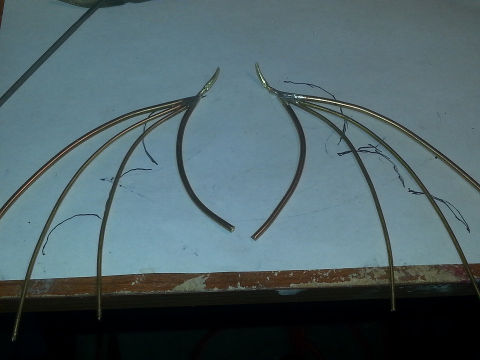

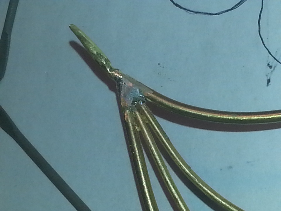

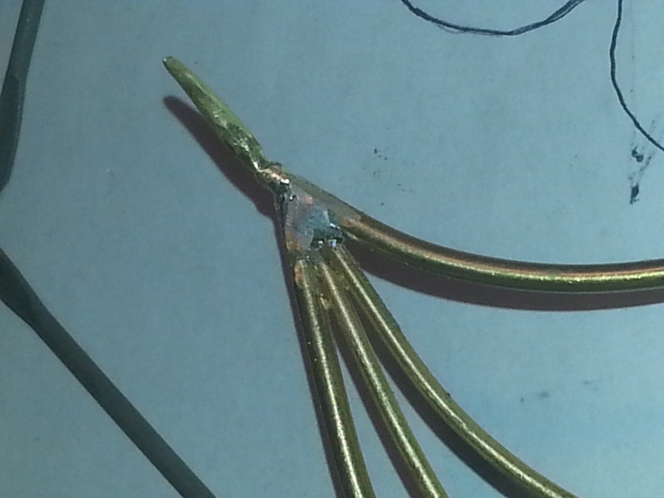

Ok y'all, I've been steady working on all kinds of things lately trying to get all of the little problems I've been having worked out and I think I'm finally there. In the meantime when things got really frustrating and I had to take a break I started working on the display stand I want to build for the Dragon pen. I'm sure a lot of y'all saw the target stand I made for my bullet pens. Well, I think I have something that will be rather unique for this pen. The pen I'm working on for myself will be a red dragon and for a display base try to imagine a stand that has a pair of dragon wings made in to the base and where the two wings meet will be a clear plexiglas U-shaped cradle for the pen to rest in. The wings will be attached to the base, and the base itself will look like a mountain top. Through the years I've had many hobbies, one of which was model railroading. The mountain part will be easy enough. The wings will have a brass rod skeleton covered with paper towel soaked in a mix of white glue and water and stretched across the skeleton. Anyway, here's a few pics of the wings so far. I've now got them primed and will start airbrushing them after all of the Thanksgiving festivities are through here.

Looking good Ted. I was wondering where you were. Just a little heads up. On this site every Feb. there is a Bash party that happens all month long. There are many different contests and plenty of prizes. This year a new catagory will happen and it is a contest for the best Pen Stand. You may want to save one of your next ideas for that contest and give it a try. The key though is the stand can not be seen anywhere on the net. You may also want to check out some of the other contests and I bet you can do really well in them. I like your way of thinking. Keep posting.

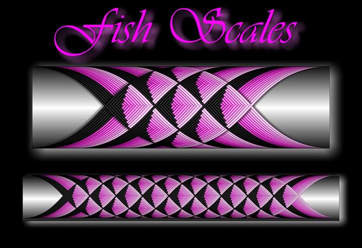

I just got this pattern that I'm going to try for the Dragon scales.

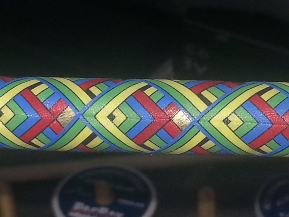

I've been working out all of the little problems I was having trying to get a good cast consistently. I finally narrowed most of the problems to the color preserver I was using. I have changed over to a new thread (new to me at least since it wasn't around when I built rods) that doesn't need color preserver. This new thread is much thinner than what I've been using so now I have to wrap three times as many windings around a tube as before, but all is good and the color is way more vibrant looking now. Here's a shot of what I'm almost through with on this tube.
Each color band on this pattern is eight threads wide so that gives you an idea of just how thin this thread is.

That last picture shows truly amazing work on your part, Ted. Words are inadequate.
You seem to have the patience of Job multiplied over and over !!!
Ted, that last pattern is really cool but then again so are all the rest you have shown. I guess this is a lot like segmenting a pen blank in that the sky is the limit and it keeps your interest. keep them coming. Never get tired of looking at your work. Truely amazing.
