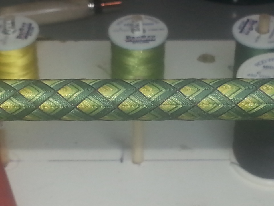

Dragon Pen Blank I'm working on. WIP
Ted Sachs
Oct 22, 2015
155
Uvalde, TX

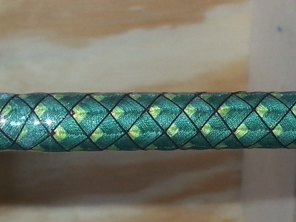

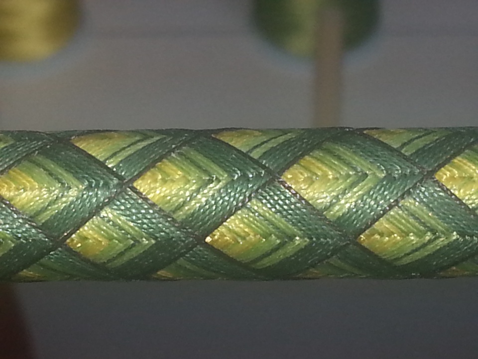

I've been toying with finding a way to make a good Dragon pen blank and so far this is about the best on yet, but I have an idea that I'm going to try on the next one that may make it look even better. Here's what I have waiting to be cast. I'm trying to get a scales look to the wrap. I think I need to extend the yellow and light green portion some at the top of each of the scales to get a more gradient look to the scale. Also, I may wrap it where you see the black outline for the shadow of the scale above it a lot more pronounced than it came out in this one.
Ideas and critique are always welcomed.

I think the black string may be overwhelming the design. Is there any way to put a thinner thread up? Then the black to the bottom would be shadow and more convincing.
I absolutely love what you've done so far. I'm an old knot tyer, among others here, from way back but I've never tried the decorative fly rod work you do.

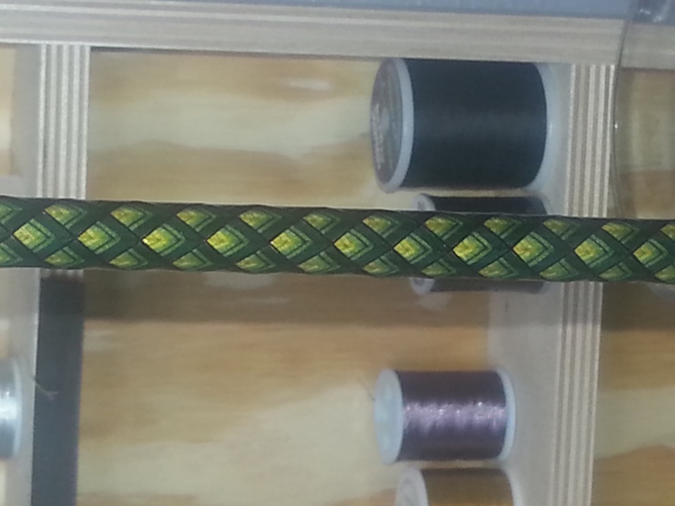

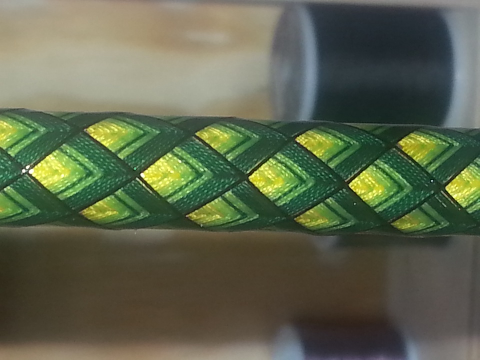

Tom, you are right about the black and I plan on doing the next one tonight using "A" weight thread instead of"D" weight that I used on this one. This one took about 8 hours to wrap but the next one well take half again as long with the much thinner thread.
Skie, you hit on exactly what I'm planning to do on this next version. By going to the thinner thread I can put more resolution in the scales which means I can get a better gradient change in the colours. I can go from the yellow to dark green more gradually and get a much better look. Now off my Dragon kits come in today I'll be set.

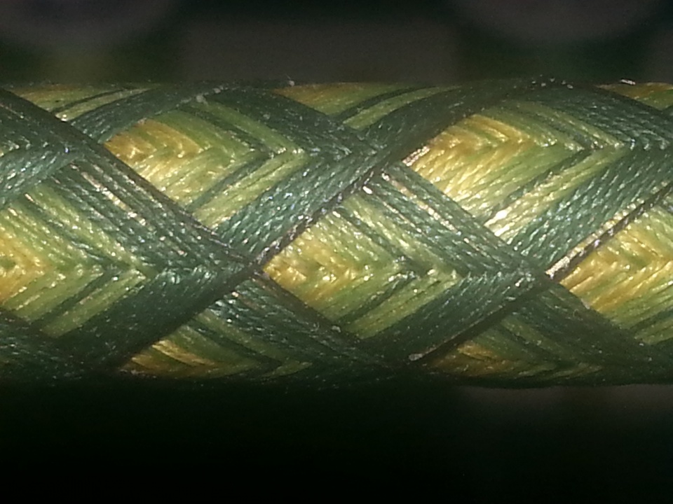

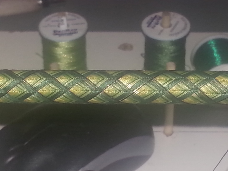

After almost sixteen hours of wrapping on a ten inch pen tube here is where I am. I started out with the thinnest size thread but had to many problems with it breaking off. I switched to a heavier thread and non metallic just to see what would come out. It looks good but not what I'm trying for. I'll have to go back tho the thin thread and be Extra Careful. It will also mean that this one at sixteen hours will become around thirty hours with thread half as thick.
At this point on this wrap I still have a few more wraps to make them pack all PhD the thread in tight and then I can prep for casting.

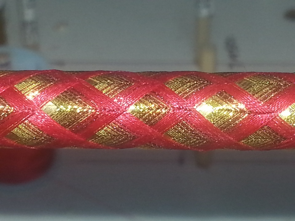

Power is back and I've finished the wrapping on the Dragon Skin. I'm ready now to put color preserver and then the epoxy. Here's what it looks like do far.

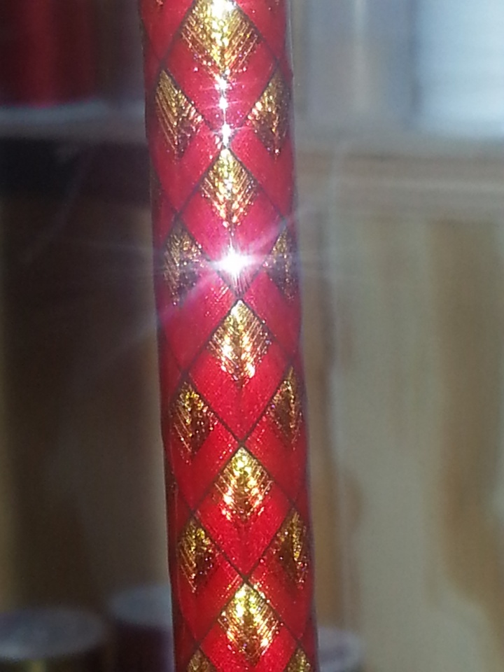

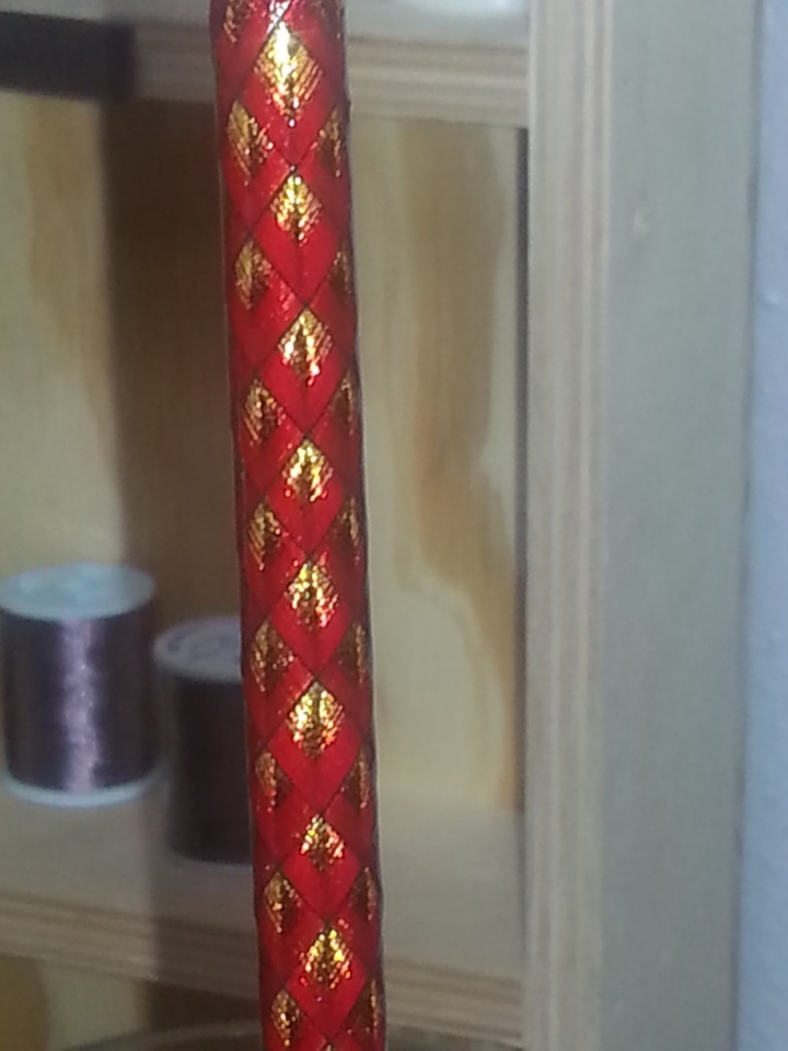

After almost thirty hours of wrapping time I'm almost through with the red dragon skin. My Simlar should be here Friday and I will have a lot of stuff to cast this weekend. I can't wait to see this stuff cast and turned. Here's the red one with just a few wraps left to close it up and then to pack it and burnish it. I hope to put the first coat of epoxy on it tonight.
For some reason the camera couldn't get a decent picture. I guess it's all of the shiny stuff throwing it off.

After epoxy it really popped out nicely. That red is killer. This weekend I'll get all of my stuff cast and then it will be time to start massaging the Dragon pen kit. I've got a lot of work planned for it to make it pop out as well.
