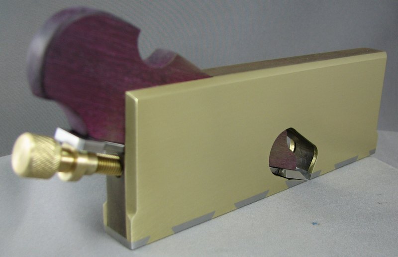

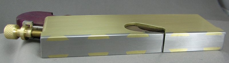

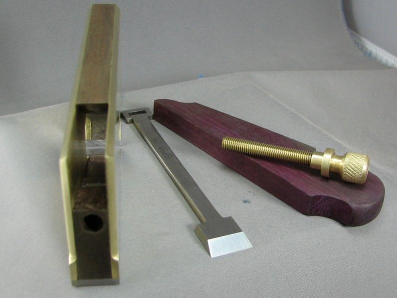

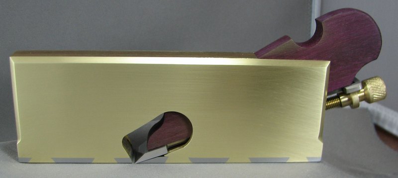

I saw this in an issue of Shop Notes magazine and decided to try making one. I think making pens will have to go on the back burner for awhile 'cause I REALLY like making these things.
The sides are brass and the sole is steel. I used Black Walnut for the infill and Purpleheart for the wedge. The only thing I didn't make was the plane iron.
All the dovetails were cut by hand using a jewelers saw and a bunch of different needle files. The adjuster knob was made on my metal lathe.
I'm REASONABLY happy with it, being my first one and all, but the dovetails on the bottom of the sole could have been better.
I think my next one will be a 13" Norris smoother. If you're interested the plans are in Shop Notes, vol.15, issue #88.
Thanks for taking the time to look!:wink:

Nice -- whose blade did you use? I cannot quite read it from the logo on the blade in the picture. Shoulder planes can do some things that nothing else will do as well. Looks to be a pretty tight mouth.
I like the satin finish too -- well done Sir!!!

Ken, it's a replacement blade for a Clifton 410 Rabbet Plane. Here's a link...http://tinyurl.com/ycz2jhb
The only problem I forsee with making metal hand planes is going broke! They're not cheap to build and they take alot of time, at least this first one did. After putting in all that time and effort I don't think I'll have the heart to sell any of them!!:biggrin:
