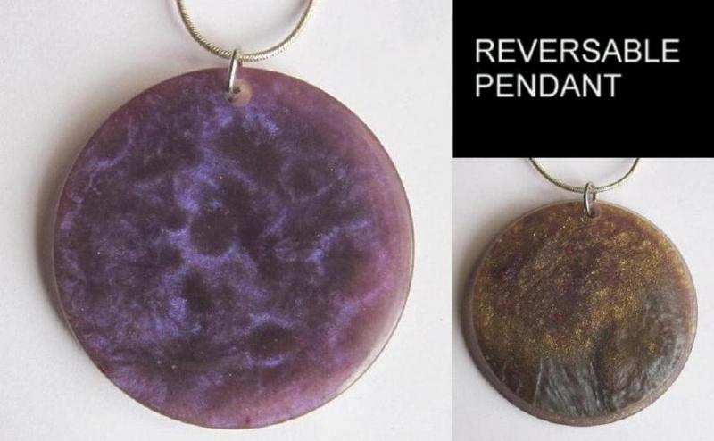

This is a reversable (sp) pendant. I call them "Limited Edition" pendants. It is like selling two necklaces in one!

Did you glue two pendant together or did the colors seperate. That happened to me before.
Great Idea. Multifaceted...

actually neither...
I mix in silicone muffin pan cups and they happen to be the perfect mold for pendant blanks. When i pour, there is always a little bit of resin in the bottom of the cup. If i want a regular pendant, I just leave a bit extra in the bottom of the cup and let it set up. If i want a double sideded pendant, i leave about half as much and let that set up, then i pour again right on top of the half blank. the new color attaches right to the old color. If these pieces had to have some structural integrity, I wouldn't do it this way, but they just kinda hang around so i figure no harm no foul. I have sold alot of them and have had no complaints!
when i mix, I can keep the colors seperate somewhat, but not to this extreme. If i let the resin start to gel before i pour, the colors have sharp seperations, or if i pour as soon as i mix in the MEK, the colors blend alot more, but neither have worked for me when trying to keep the colors seperate in this fashion.
