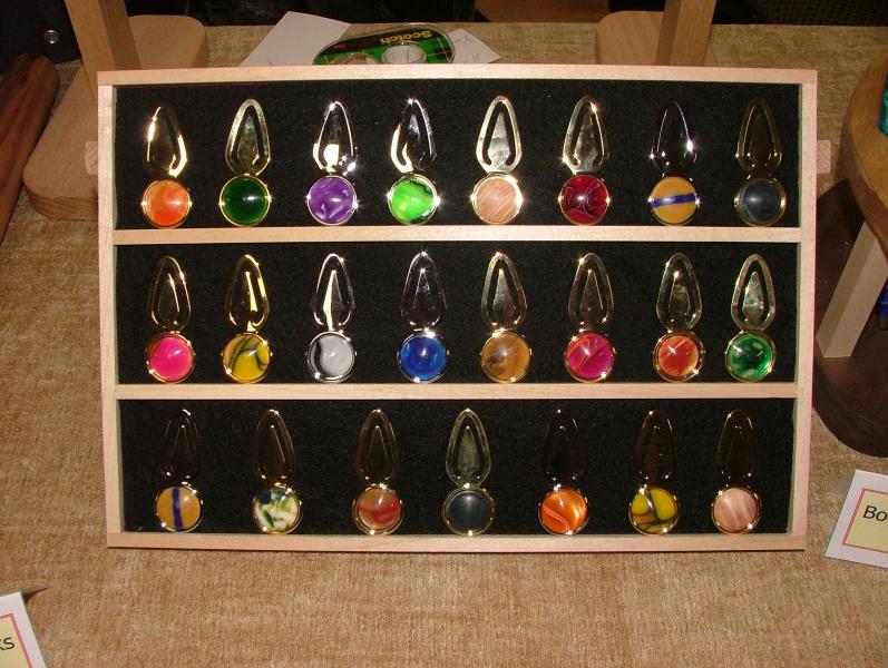

They are a pretty good seller for me at shows. I did not get the mandrel though. I put a 1/2" pieceof dowel in my chuck and glue the piece of wood or acrylic onto the dowel and turn away. I then part it almost off, do my sanding, part off, and use my dremel with a little sanding drum on it to take off the little bit left from when you part off. I can usually get 2 pieces out of 1 left over cut off which is normally around 3/4" long.

I turn, sand, and part off each one in about 10 minutes. When I turn I make the dowel or scrap wood that I glue the acrylic onto the same diameter that I need the button turned to so there is no measuring. I turn the full length (3/4" or so) to that diameter then just shape the button sand and part off. I also don't get into wet sanding on these and just run through the micromesh quickly and I've had no problems. Once I get a bunch turned I will sand off the little nub on the back all at once and then glue them all at once rather than 1 by 1. I sell them for $3.
