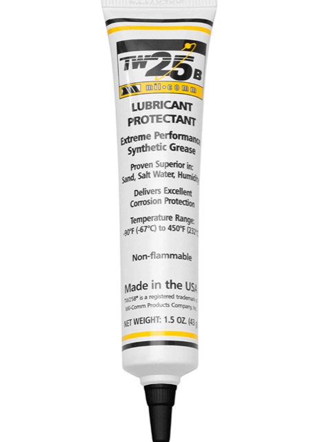

Did mine today and you are so right. This is what I use it's a little pricey but you use so little it will last a long time. Makes metal sliding on metal so smooth you won't believe it.
