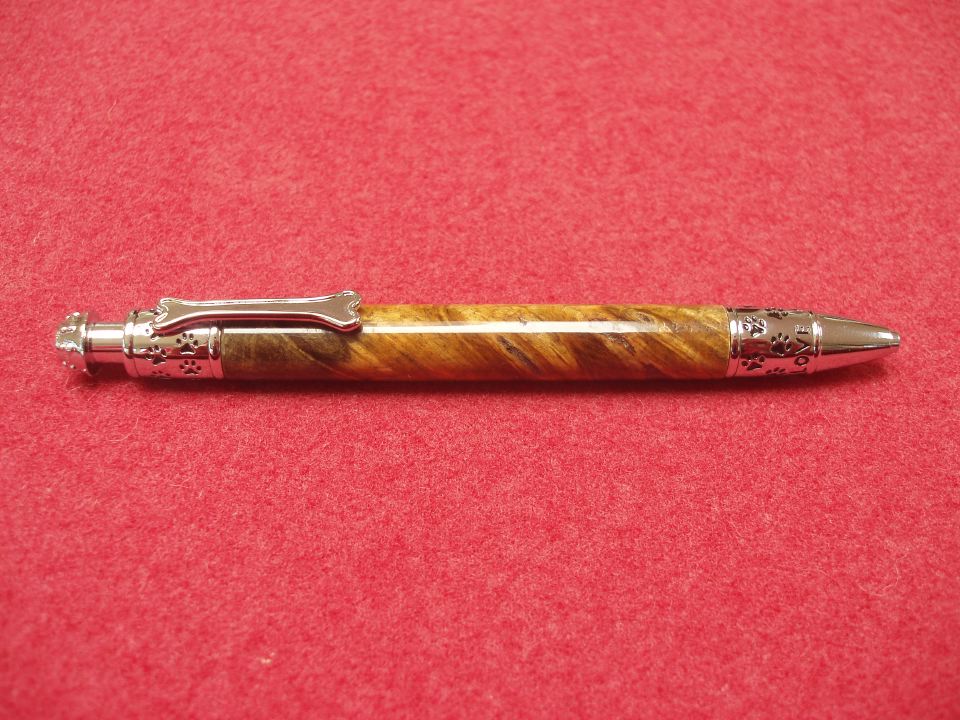

I made a dog click pen about a month ago. I remember the issues with turning buckeye burl for the first time, but no problems with assembly at all. The click mechanism worked, the pen wrote, and we gave it to its recipient the next day. The next time we saw the recipient, she told us that she loved it.
